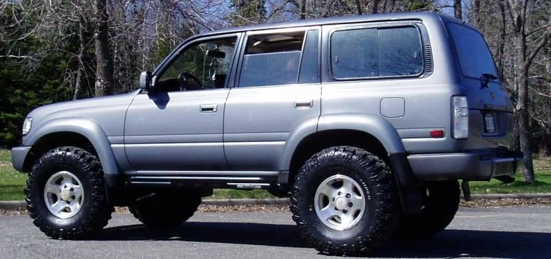

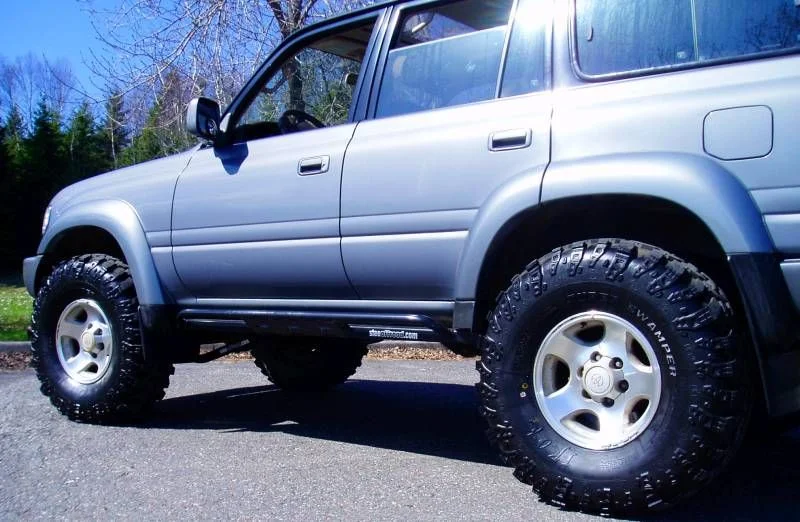

I run J's with a 1.5" spacer up front with 35's and the only rubbing I get is something bump stops would fix. I've got castor plates and lower sway bars and I am a lucky SOB because I don't have any issues everyone else has... no driveline grrr, no relay rod rubbing on control arm(about 2" gap) and No vibrations except for crappy tires.
Don't ask me why but my rig sits higher than others that have J springs. Maybe because the heaviest thing in the wagon is myself.
With my setup I could easily fit 36's or 37's but the only reason I don't is because my 3FE and stock pumpkins would not pull them down the road.
You will probably want to regear if you go larger than 35
That IS a sweet looking truck. Thanks for posting pics. The 80s are such big trucks those 36s don't look out of place at all on it.
