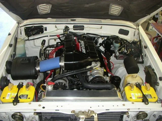

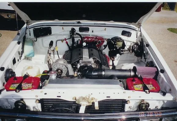

wagonners 350
Gday waggoner is that a pic of your 60s' engine bay? If so, that looks like a corvette LT1 to me, and a VERY tidy install by the way. Nice.
I was looking at that engine swap and looking at mine...man you have no wiring mess under that hood...Did you just tear all the old Toyota stuff out??? I wish my engine bay looked as good as yours :)
I routed all the wiring inside the fenderwells to keep the clutter out of the engine bay. All the Toyota stuff is still there . The engine was actually a LT1 Camaro motor with the Corvette covers. Too bad the little V8 didn't have the torque I wanted in my really heavy 62. Its gone now.

So what, dare I ask, adorns the engine bay these days? When your torque hungry monster was powered by the camaro engine, how did it go? How did it drive compared (offroad & onroad) to when it was powered by the 3f?
Dude...Wipple or Weiand!!!
Nice little add on for the money. Hehe.... :bounce:
I added 152 cubes. The 350 was obviously a huge improvement over the 3FE , but with 35s and 4.11s it didn't have the low end I was looking for. It would haul butt, but on a long grade I would still downshift, and that pi**ed me off. I looked at a diesel option but wasn't interested without an intercooler. I never found one that would fit in front of the rad. I am a diesel guy and maybe one day. Duramax?
