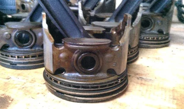

Ok so picked it up this morning. Engine looks good and the rotating assembly spins free and the journals look good too.
The pistons look like they're different than the stock pistons

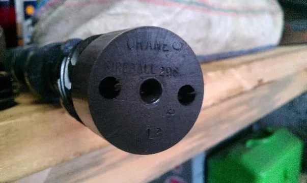

Also has a crane fireball cam
