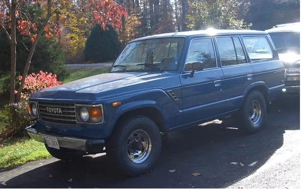

31x10.5 (Goodyear Wrangler Silent Armors) on a stock, saggy suspension . . .
Haven't really taken it wheelin yet, but I can't imagine it rubbing.
I have 31X10.50s stock springs that need replacing and even off-road haven't had any rub issues
