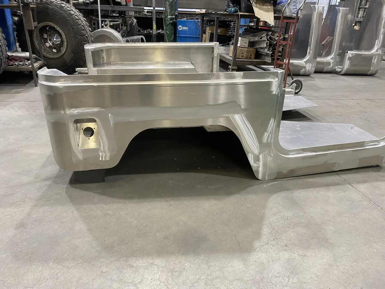

Not sure if youre going Aluminum or looking for a steel repro tub, I got a 3/4 tub from Aqualu with the tank provisions in the cab removed and shifted rearwards for moving the tank behind the axle. I think they already had this design for the ICON tubs they do. Im pretty tall so I want to mount the seats low and make some storage under them. Currently in the process of mounting it

Fast forward a few decades I purchased a full alum tub with cowl
Its going to take a little work to do the rest, mount switched/etc but long term its the best option for me.
Mating the 3/4 alum tub to an existing cowl is prob as much work as migrating all the wiring/etc to a new complete tub/cowl
Pick your poison
