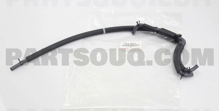

Hey @JunkCrzr89 Is this the size for the PS hose? I have some generic hoses but my power steering is leaking ever so slightly.. like almost non existant leak but its the hoses are wet. so its leaking.. or would you happen to know the power steering hose "mm" size?
That will work for the two PS *vacuum* hoses (not the fluid hoses!!!), or you could just buy the pre-formed version specific for that valve for $25:
