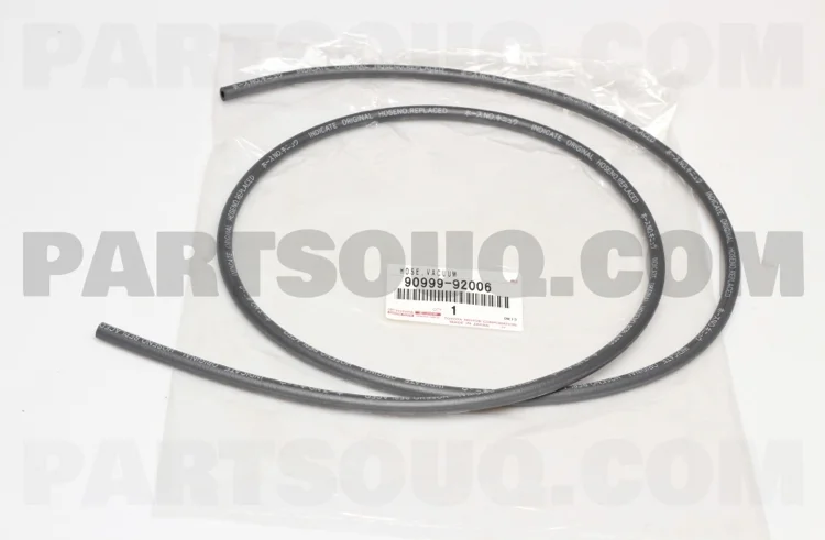

Well they’re lying communists. Here’s the part number for 4 feet of OEM Toyota bulk vacuum hose: 90999-92006. Buy it wherever you want. It’s $12.38 from partsouq. Probably can’t buy 4 feet of $hitty hose from Autozone for that price.

I just ordered it online via my local Toyota dealers website, pick up in person. HA. A few $ less than partsouq after shipping costs.
Won't be the only hose size I need but its a good start. Thanks!

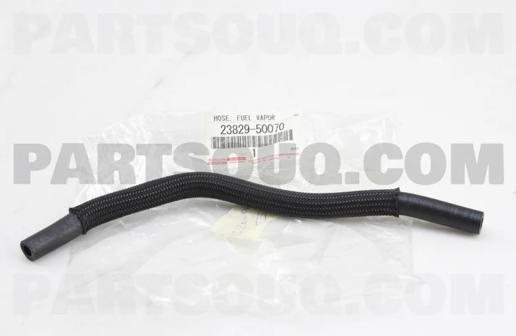

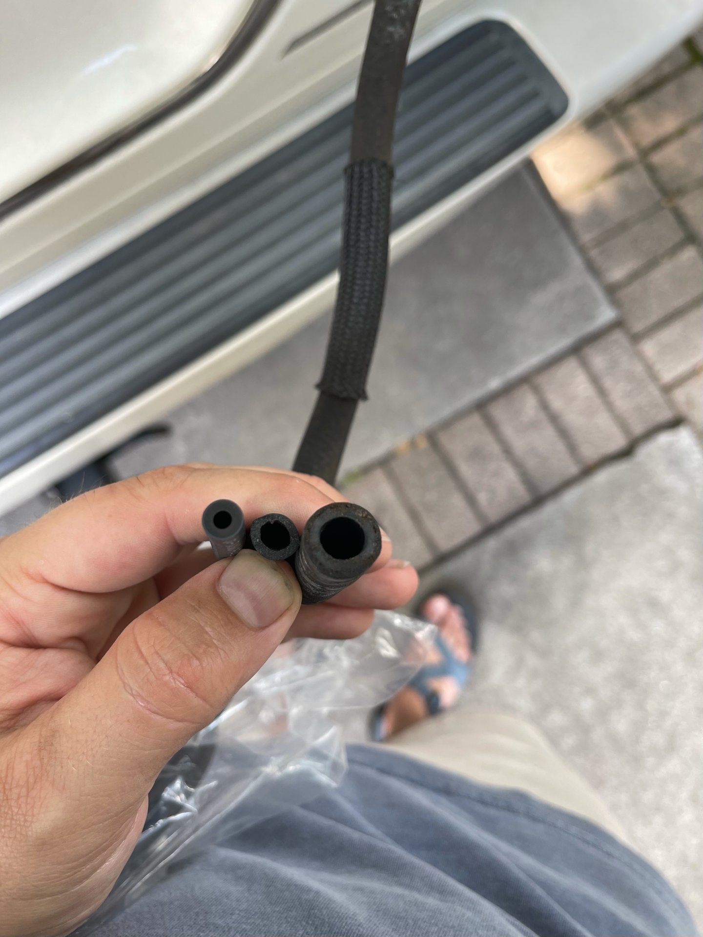

Hose on the left is part number 90999-92006. Too small to use for what I'm trying to do.
Hose in the middle is a hose the Toyota parts department gave me after I pestered them for some of their vacuum line.
Hose on the right (23829a) is the first line I'm trying to replace, and the same size as much of the lines I was hoping to replace vs buying OEM fitted lines.
Currently have the middle hose in the spot the hose on the right (23829a) was. Will use that for now.
I think I'm too much of a perfectionist to settle for lines that aren't the exact same sizes as the original. :c

I'd just take the lines to the parts store and let them know you need some vacuum line. You should be able to match up the diameter pretty darn close that way. That's my plan for when I do the vacuum lines, and I'm a perfectionist too.

Where did you pull the hose on the right off of on your rig? just curious.
I am gearing up to swap a bunch of hoses as well. I like to use OEM for the ones that have some bends in them but a few near the charcoal canister look like they can be replaced with generic vac lines.
