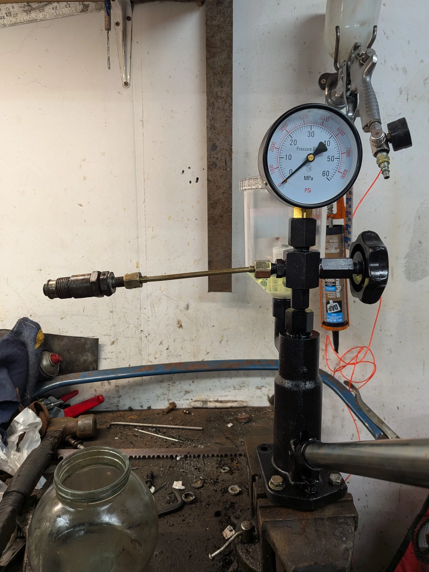

local shop charge 40$ per injector to test them . Im a cheap ass DIY so I bought a test press (80$) and will test them for leak and pressure. If you have advices or other point to look I will gladly take those advices.

Well all the injectors were pissing fuel.... Probably the main cause of that poor mileage ....
I tested all 6 that were on the motor and also the 6 rebuilt I had from the blown engine that was originally in the truck.
Huge difference , the old one leaked around 1400psi and their spray patterns weren't very nice either at 1600psi. The other set was perfect , breaking around 1600psi with a nice spray.
Glad I bought the press to see it myself !
The engine run a lot smoother and is more responsive too , not 20hp more ,but definitely much better !

btw ... I bought the press because it was cheaper than getting them tested locally, plus I will try to rebuild the old ones myself with the manual's intructions.
