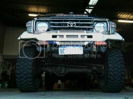

There ain't a lot of room in a 75 for an intercooler. especially if you have twin air cond fans like I have. Remove the grill and push the intercooler out front. I have the same problem want an intercooler but no room unless I pull the RADIATOr and air cond also backwards as I have tonnes of room inside
Clint that looks sick! Did that take a heap of work? I have pretty much given up on an intercooler still pressing forward with the turbo side of things but and ill just run the boost round 8 and watch my EGTs etc etc...

It took me a while to do it but I had no other 7x series to copy the front mount idea off so I had to do a bit of thinking then fabbing but it can be done if you can use work tools.to do a second one would be much quicker and easier.
