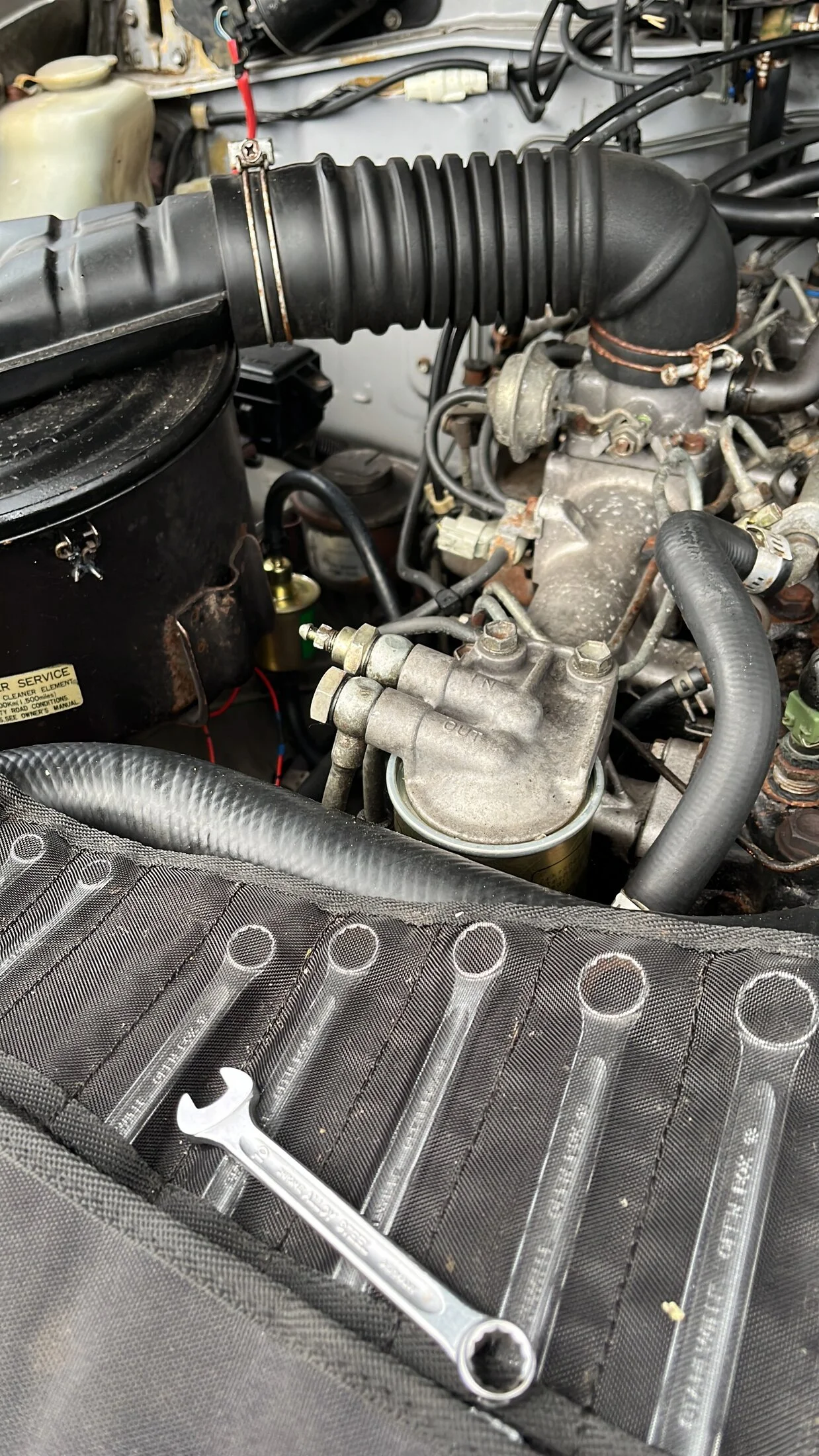

Picture of the cheap electric pump installed the background

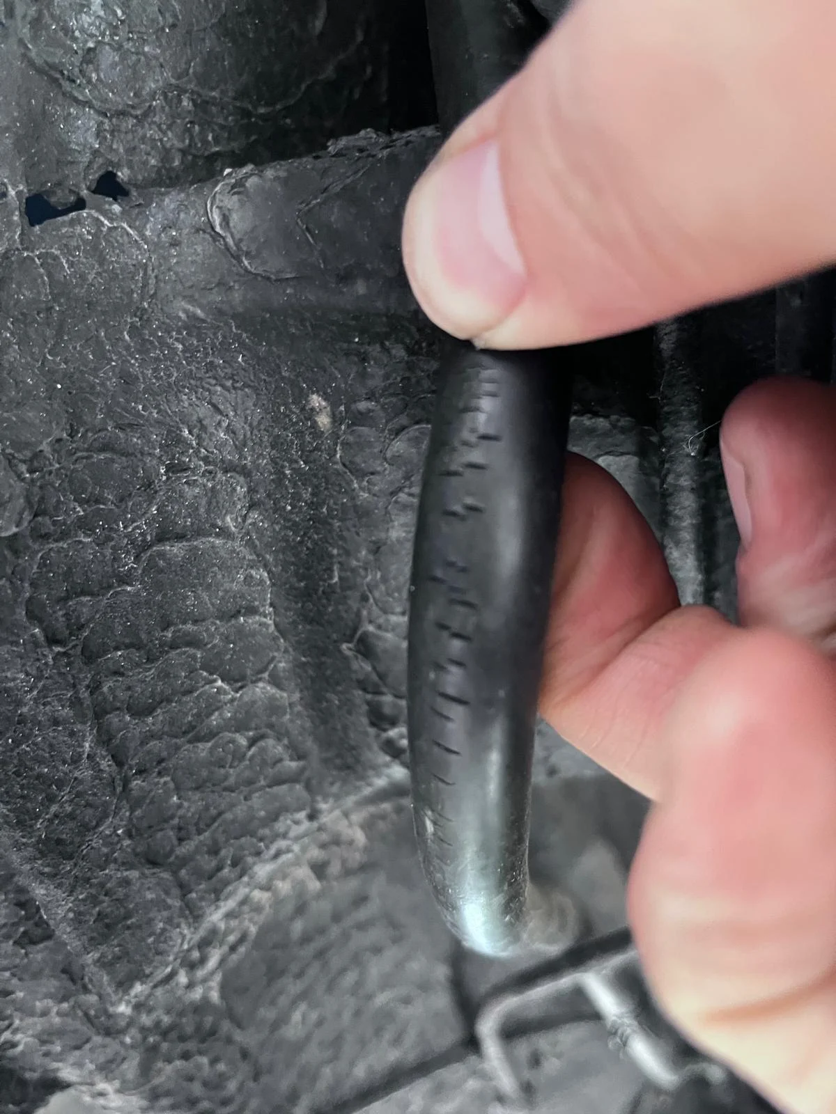

Was stranded at work yesterday. Made it 500 meters to the nearest garage.
Couldn't get (presumably) the system bled. It kept dragging air in I suppose or it is not able to let fuel pass.
Replaced one of the 3 month old flexible hoses on the spot. Wasn't looking the best 🤷‍♂️
After replacing this i was able to get the system bled en running again and made it home just fine.
Even though this hose didn't look great I have the feeling this wasn't the culprit. I think it is the primer pump or the lift pump itself.
This because there was sometimes no flow to the bleed screw when working both the manual primer pump and having the electric pump running.
Will dive into the schedule of the lift pump to see what can fail there en possible restrict flow or lets air in. Same for the primer pump.
NB, primer pump is already replaced by a Bosch unit.
was that an actual fuel hose? hoses aint hoses, rubber is not nitrile or viton, fuel hose is different to air or vacuum etc..some expand some contract.
If that hose was fresh, it does not look fuel resistant, also it looks to be contracting inwards which too would restrict fuel..

That was indeed a special fuel hose. Pulled the data from the online order. It states specifically that it is rated for diesel fuel oil.
