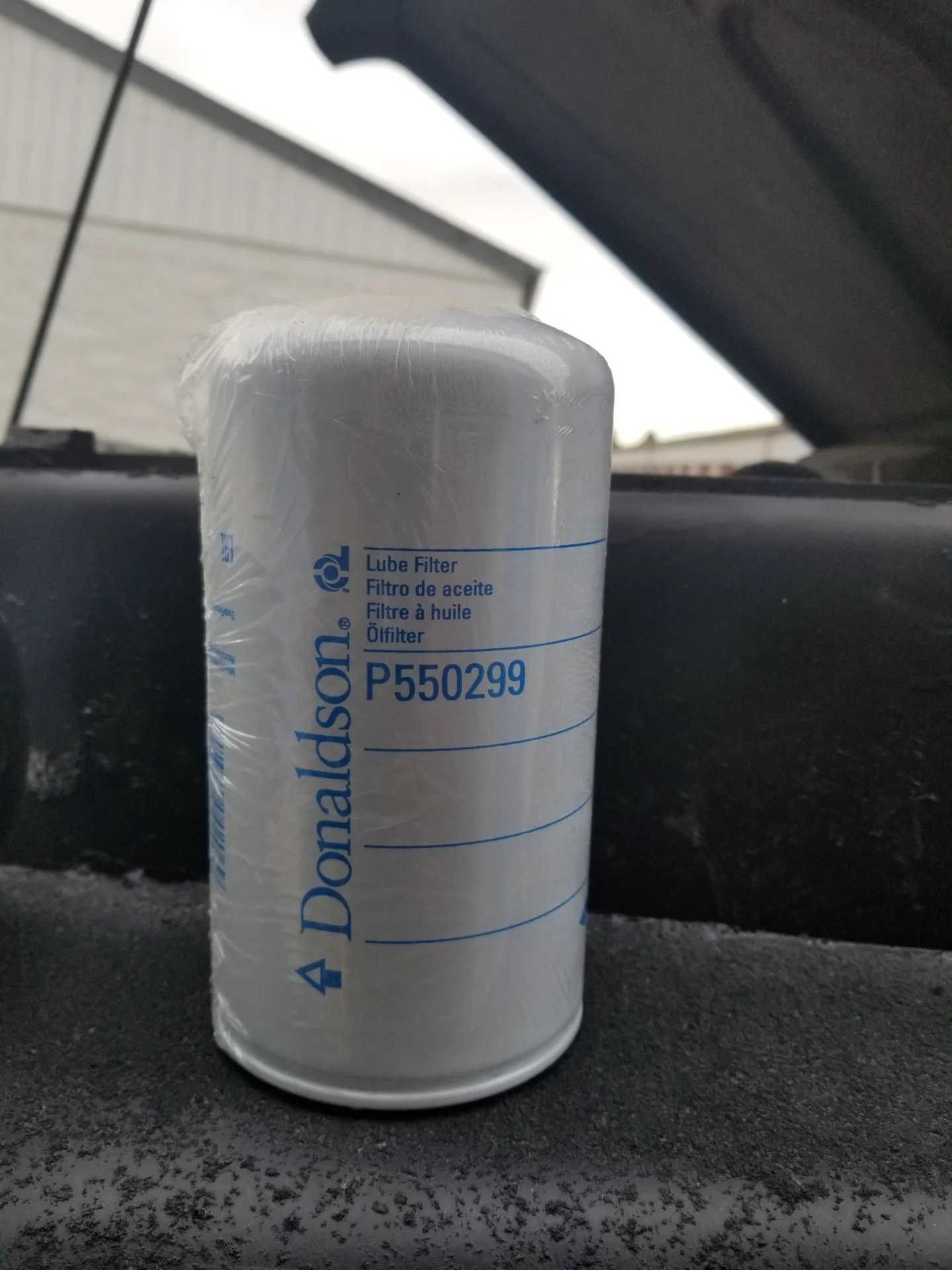

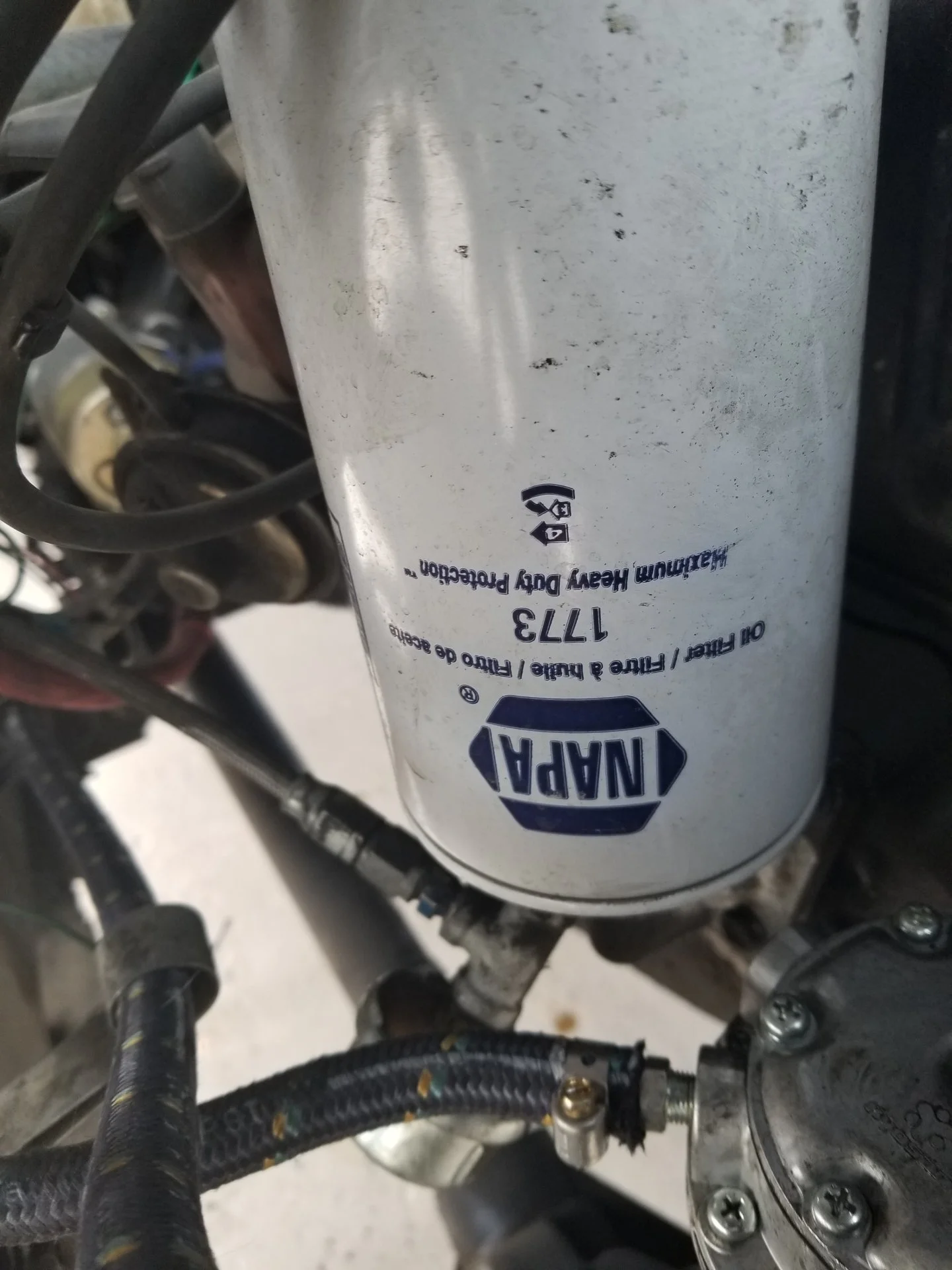

Hey there Pighead, what amount of ZDDP are you using and what is that massive oil filter?
I just grabbed a little bottle of the ZDDP off the shelf. Forget the brand name.
Is a Donaldson, same size as the Napa i pulled off.
Awesome, that thing is huge! I've been using the Napa/Wix 1515/51515. I remember reading about Donaldson filters (along with Napa and Wix) as being some of the top quality aftermarket filters. I'll give that one a try! What size holesaw do I use to clearance the hood? :rofl::rofl:

Actually, the Donaldson looked identical to the Napa, like they were made in the same factory.
No hole saw necessary on a 55, can't guarantee the same for a 40...

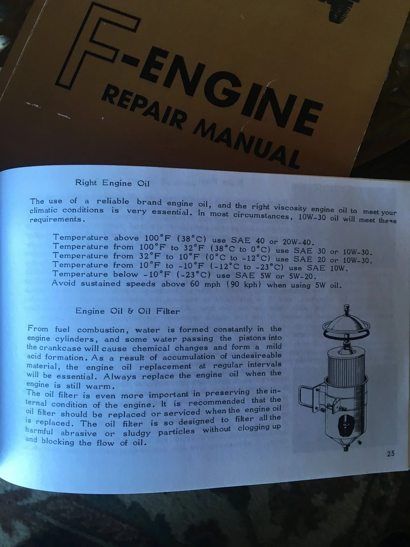

And just for completeness, here’s a pic from my 1958-1967 FJ40 Owner’s Manual
I‘m not very good at following <some> instructions 😂.

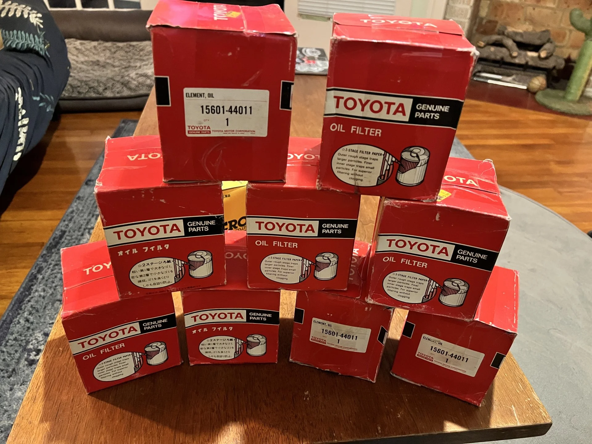

I no longer sell any parts but I do have a metric s*** ton of -41010 filters. :flipoff2:
:lol:

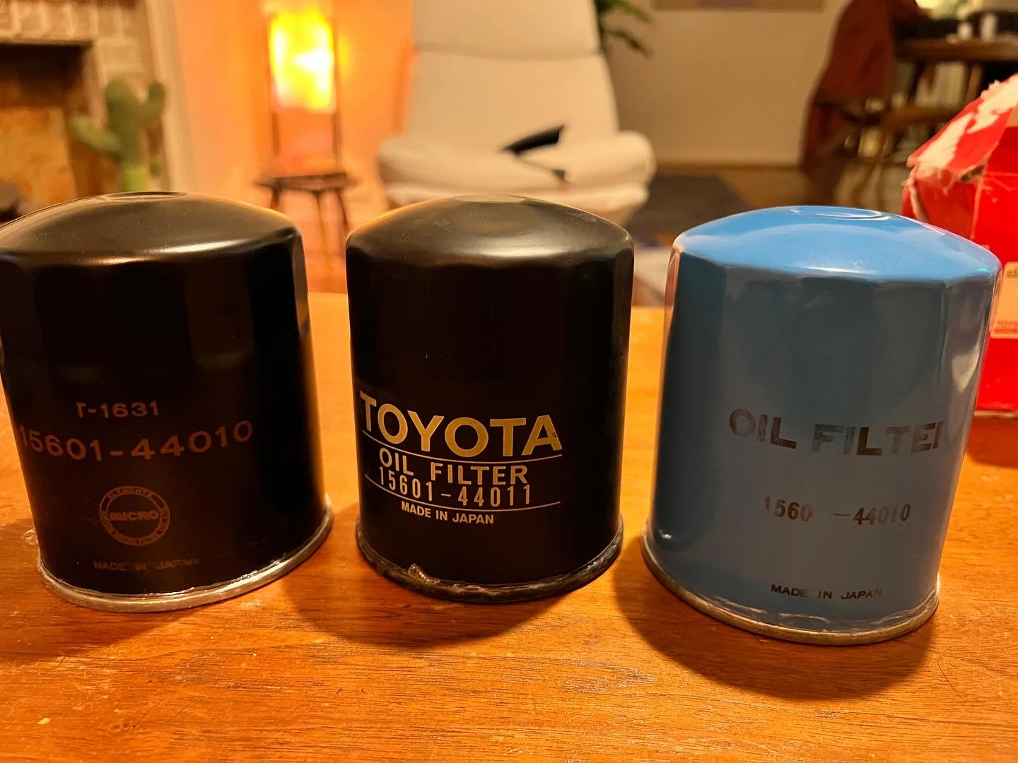

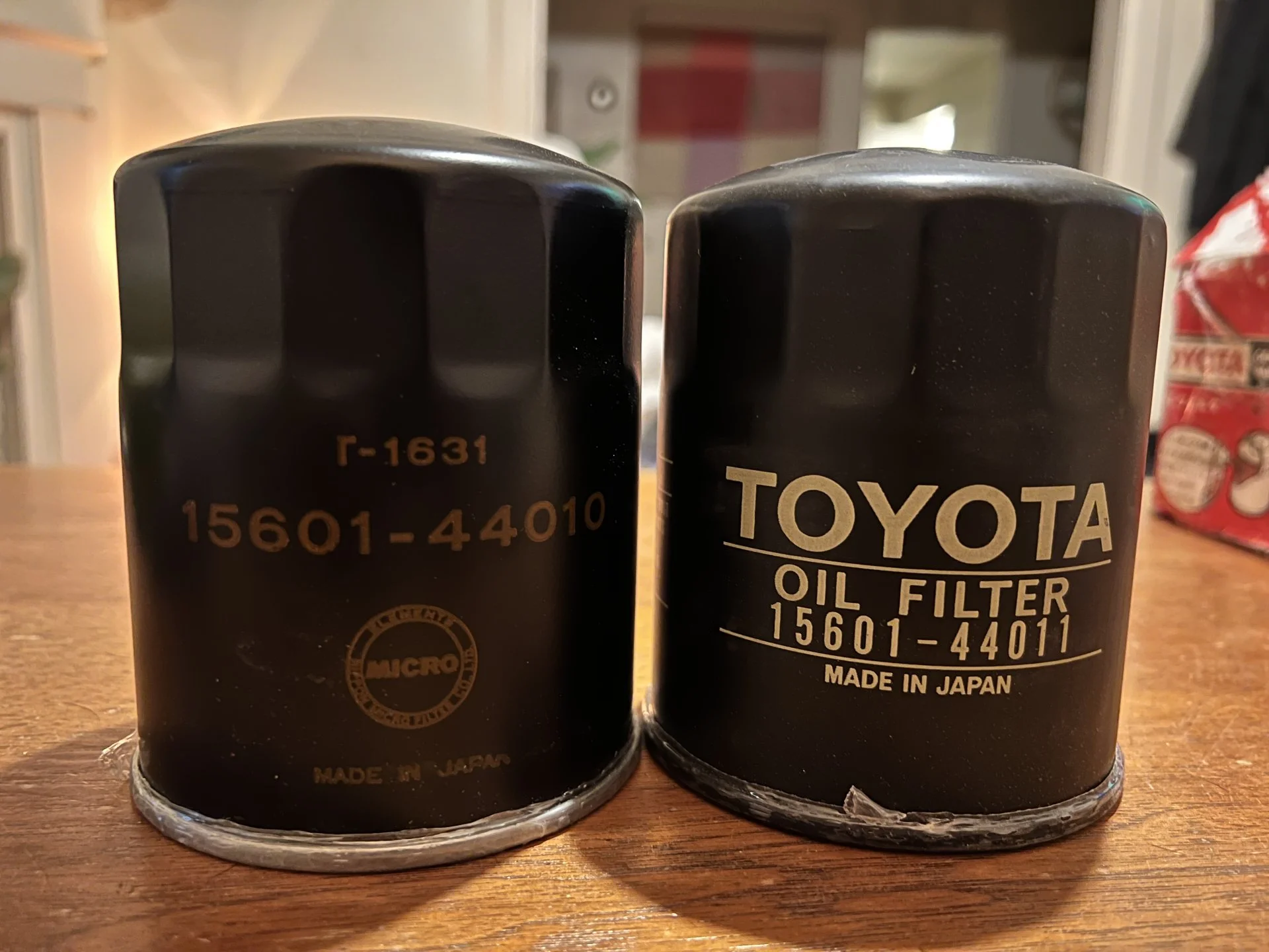

I may have an oil filter problem.
All of these are made in Japan.
