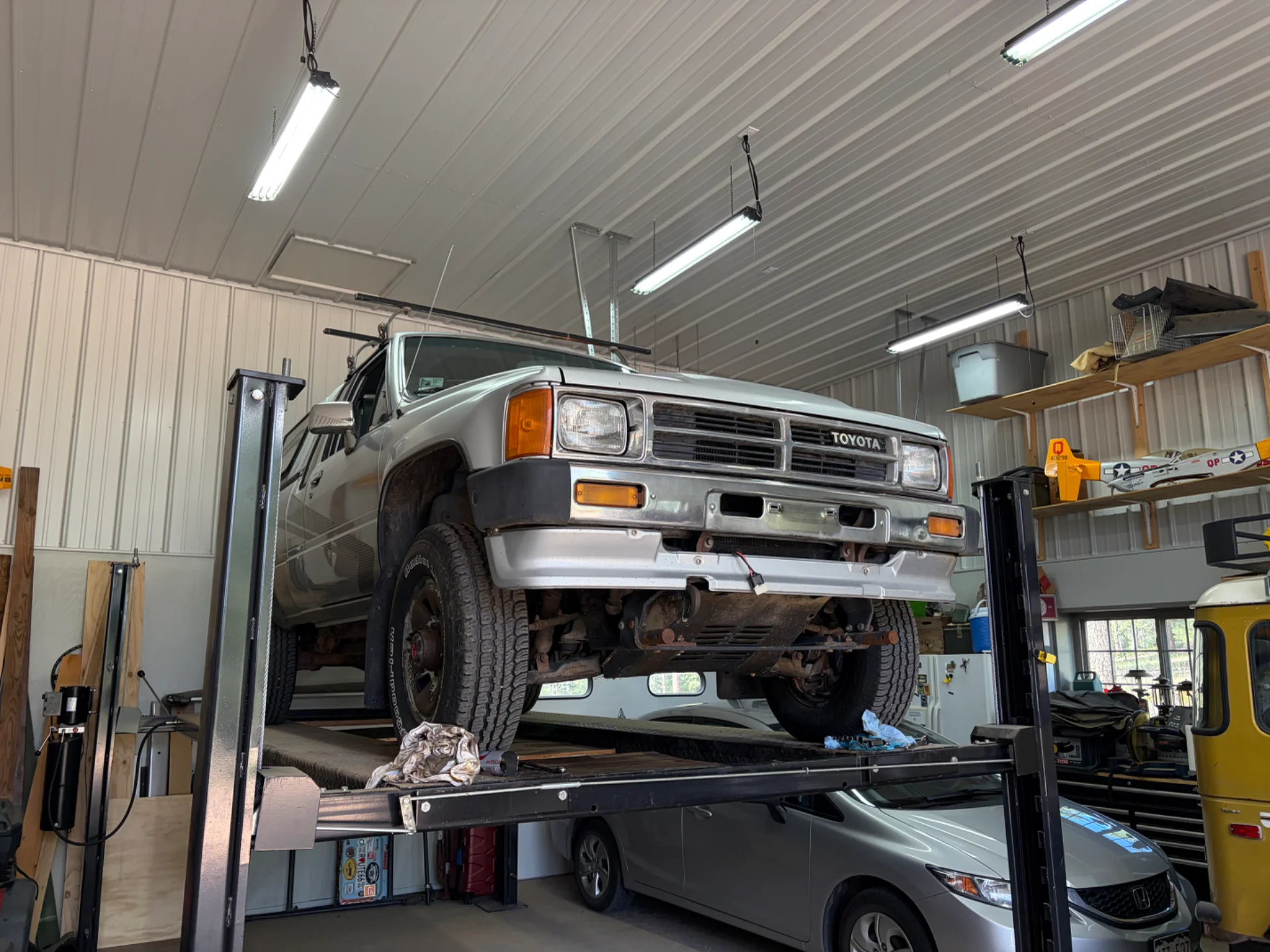

Got home. Within the first hour I had to remove the plow. Toyotas don't deserve all that crap hanging from the front end.
I didn't want to run this thing too long without fresh oil at least. Put it on the rack and put some new synthetic in and opened/topped off all of the gear boxes.

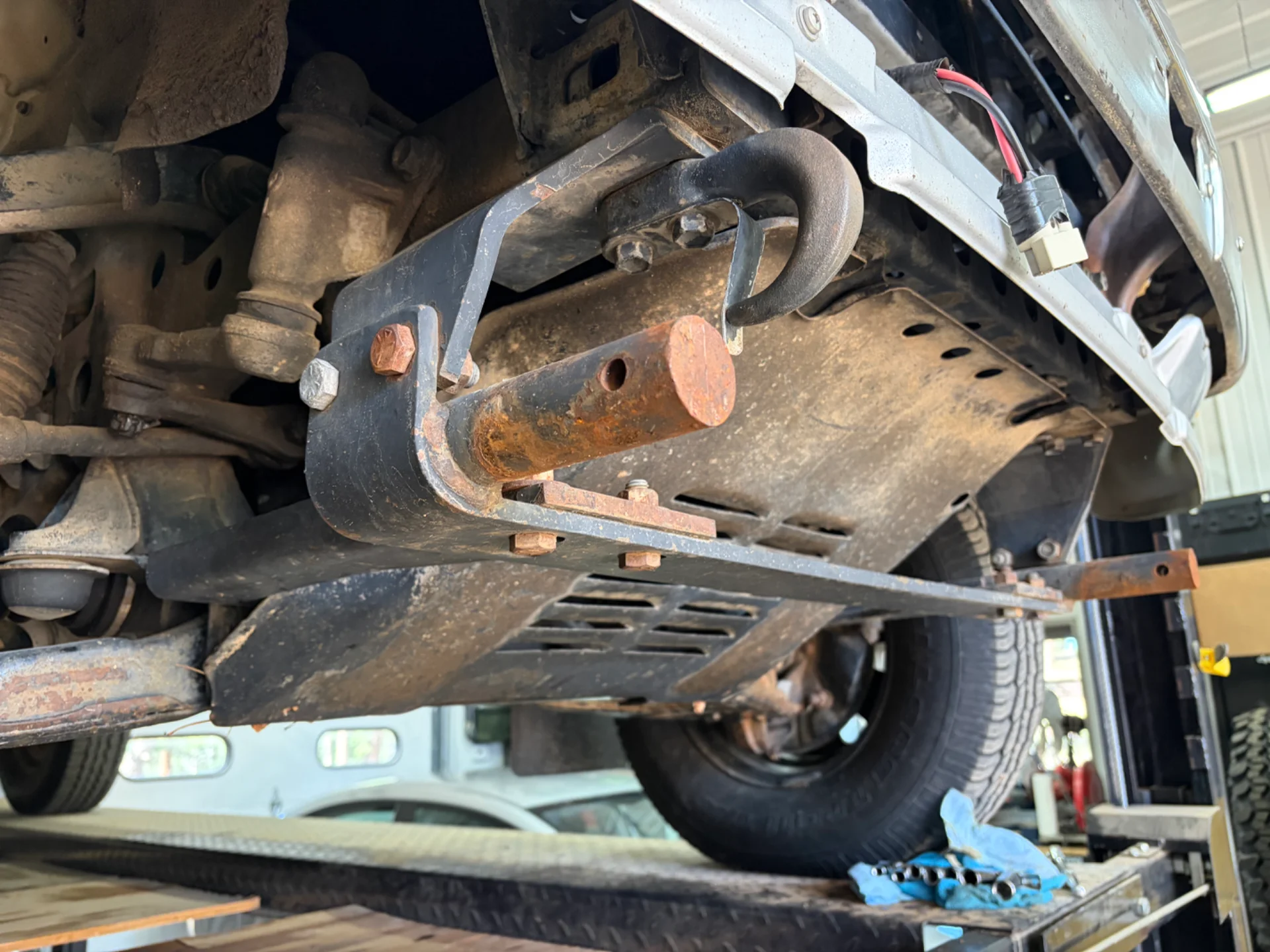

I had to remove the front skid plate to access the front diff, which also gave me the chance to remove the snow plow mount. Luckily, it was bolted on using the OEM holes and was an easy removal.

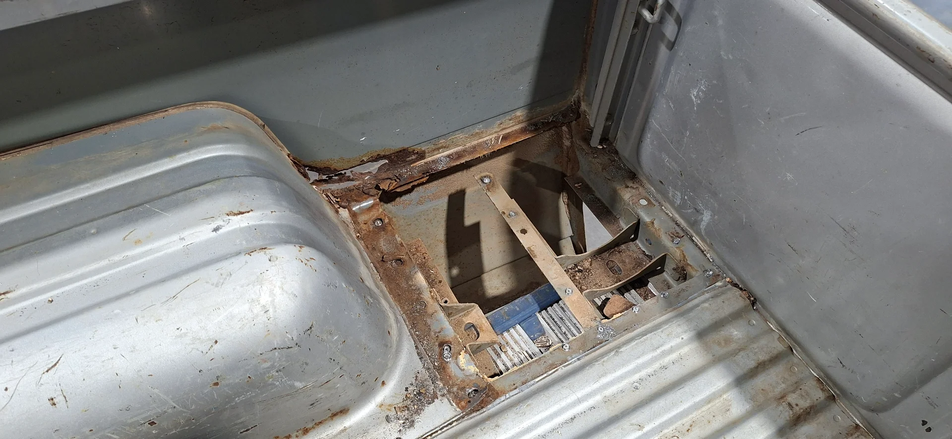

Rust. This truck has little to none other than on those pesky rear side panels. I've decided to pull the bed and send it off to my buddy @DangerNoodle for a proper reconditioning with new steel.

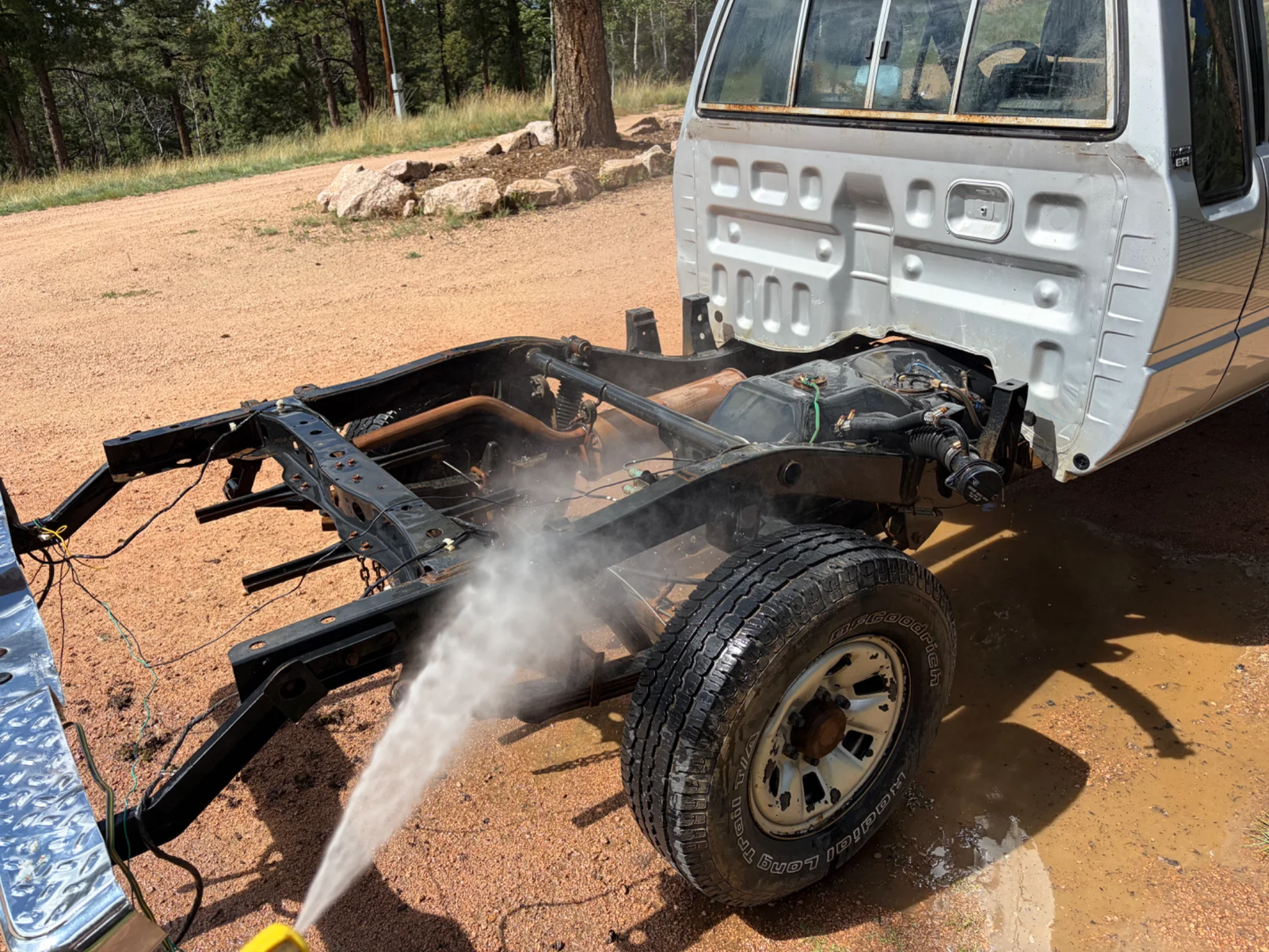

Looking forward to pressure washing the frame.

Dropped off the bed in Buena Vista for welding, drove some nice back highways, and did some pressure washing. DJ gave me a tour of his shop and we had a great time talking cruisers and checking out the famous LF40 Wheeler Build. His workmanship is top of the line unreal.

Original condition.

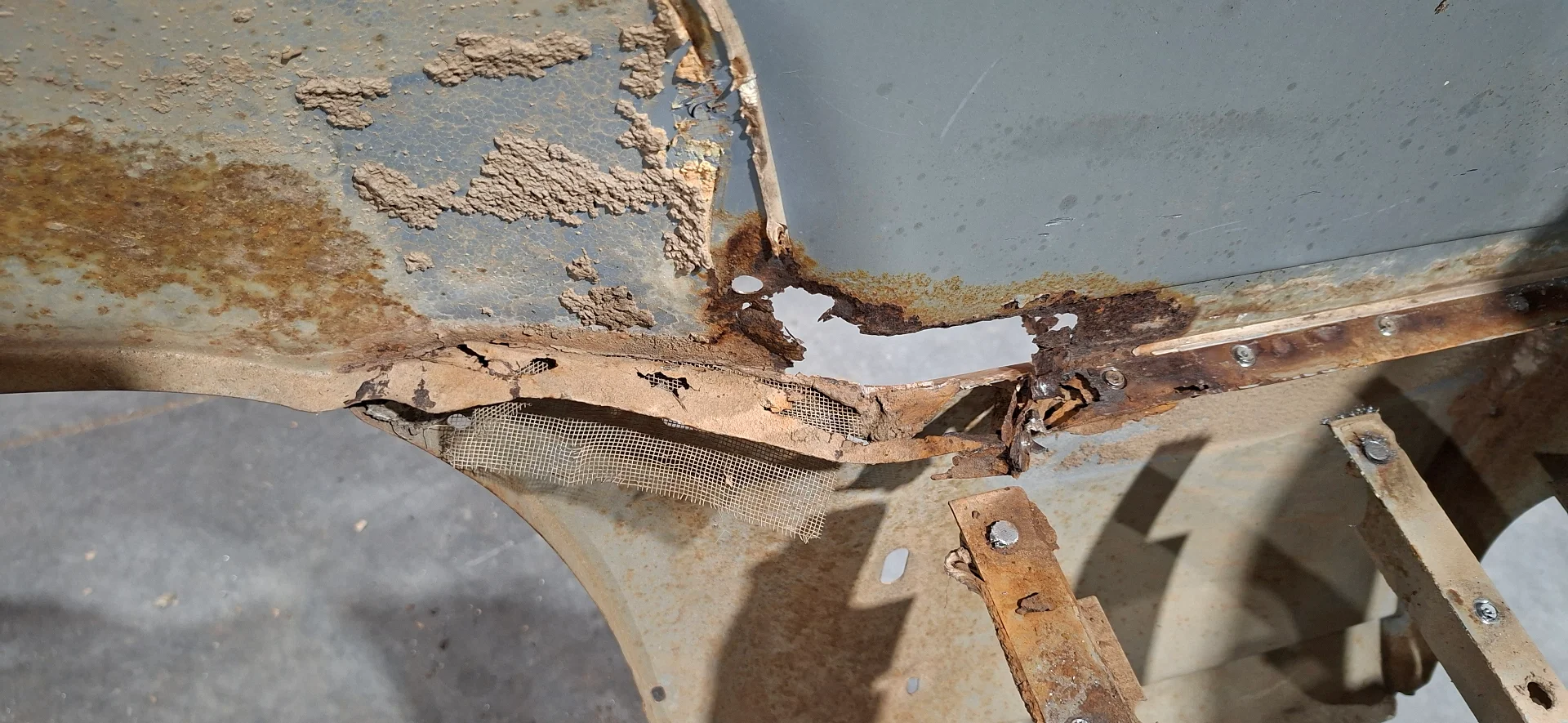

Passenger side p.1
Passenger side p.2
Passenger side p.3
Everything was 100% disassembled, sand blasted, patched, treated with a copper weld primer, and reassembled.
Driver side. I had to go slightly farther and pull the rear floor panel to easily access some rust pockets. I always go till i find clean metal between the seams, or it always comes back.
