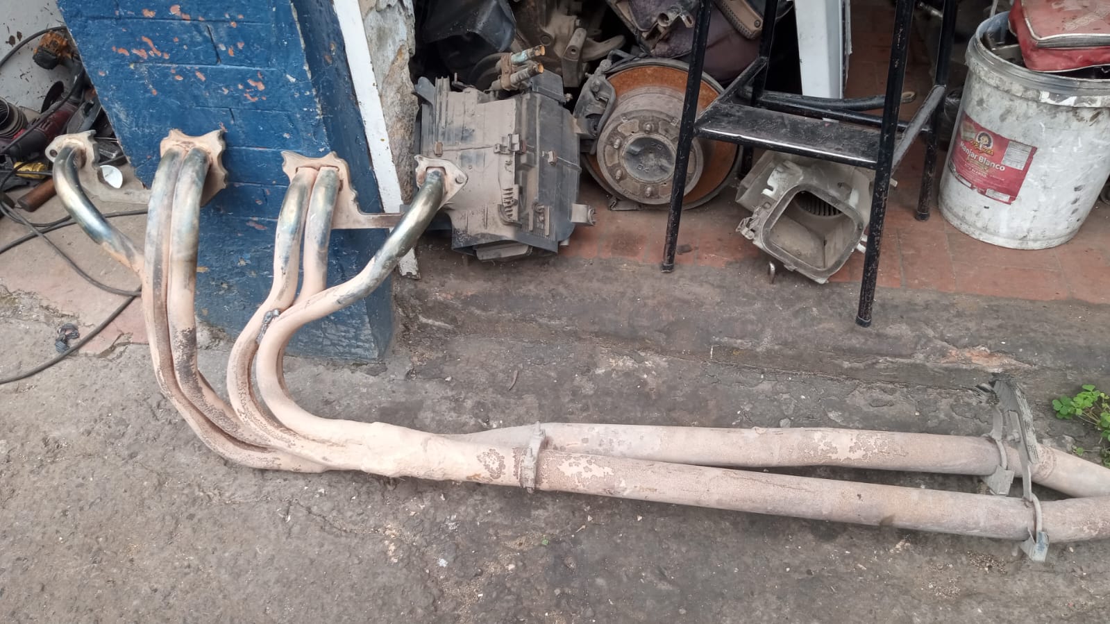

Guys, picked this up for $120.
Think it'll fit my 1978 FJ43...?
Assuming the ports line up, the flange thickness matches the intake flange thickness and you have a welder and grinder, yes it might fit.
Thnx. Measured everything.
Why is the join five feet from the curve? How will that affect the sound?
I have never seen one that looks like that. Managing the parameters like equal length, savaging the cylinder that fired before ... dictates the design if good INHO.
That mounting flange looks like 1/2" plate. So was the one on my man-a-fre. I made custom stepped washers to apply equal torque to the 1/4" flange on the aluminium intake. I used 2 Manny header gaskets that I applied wet. Made longer "studs" and used stainless steel nuts. "Planed the header on a big piece of glass with sandpaper glued to it. That header and intake plus gaskets has been on at least 2 different engines, 3 times total and no leaks.

Me neither. The join is about three feet from the curve, never seen that. It's definitely off a 2f though.
