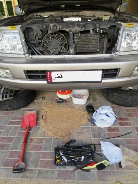

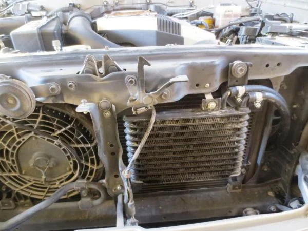

Something to note, some cruisers in the US came with an optional "tow package" this included an extra oil cooler mounted in front of the regular radiator to help keep the trans at optimal temperature.
If you don't have the extra tow package and you are towing large loads through hot climates with larger tires just keep an eye out for the overheat warning light. once you have cooked trans fluid it needs to be flushed and replaced.
Retro fitting an aftermarket cooler is VERY easy.
I run 315's in the middle eastern desert and if I'm not in low range through the very soft sand I cook my trans fluid (before I fitted the cooler.)
