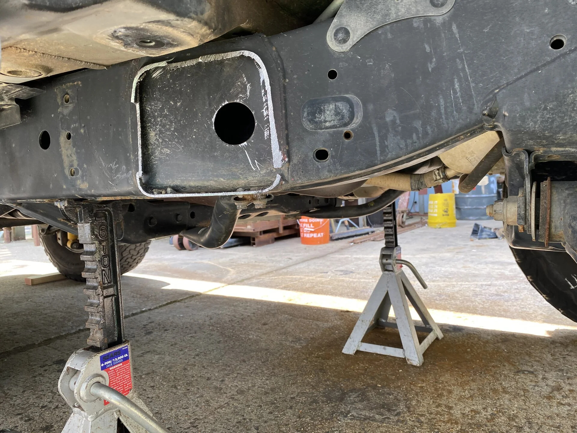

@JDUB fab Do you rub on the frame rail with 35s and the -10, thats what we've got and we don't rub any where but the rails.

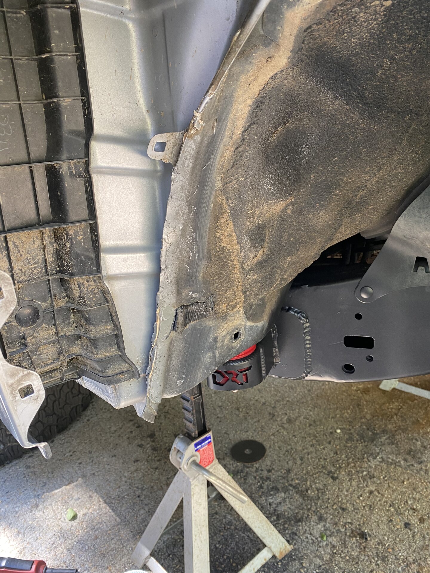

I don’t think so. I just checked and my frame is still fresh paint from the body mount relocation. I do think I’m rubbing a little bit of the fender liner still, need to do a bit more trimming. I also need to trim the rear a bit, already removed the mud flaps. I was hitting on the little piece of pinch weld that connects the fender panel to the body pinch seam, but I cut that off, now the fender panel has a bit of shim to it, I gotta fabricate a little piece to tie it back into the body.
