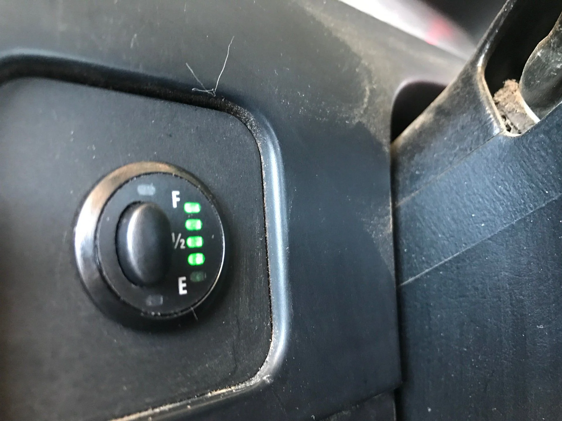

I know that Long Range Automotive (LRA) has a little transfer switch with LED level indicator- I can can get one of those- but the issue is : Matching impedance from the fuel sending unit float and voltage of the system. I'm not sure if the impedance is adjustable (for empty and full) and if the LED can handle 24v power.
The switches and LED indicator that are used by LRA seem to be all 12v. Here is a picture of the 12v one used by LRA kits. I think Toyota had a dash mount pod for top of dash for the aux fuel, but not sure available.

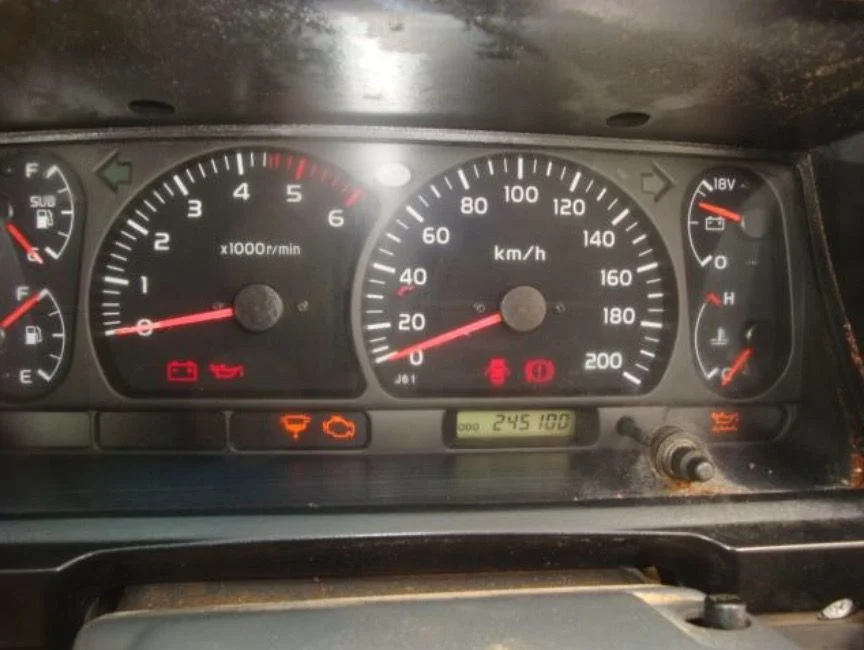

Have you considered the updated 70 gauge cluster with a sub-tank gauge inside? It's for the old style dash but was updated a bit. That might fix things on the gauge side. A bit more work figuring out the wiring but it will look better in multiple ways. It's what I bought and plan on trying to use. I snagged mine from eBay Australia.

FYI, my LRA/Apexus switch gauge (as shown) has the following specs:
