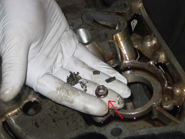

Ok here comes the photos get ready
the red arrow points to the nut that was found in the oil pan. you can see how the head is shiny from being milled by the oil pump.

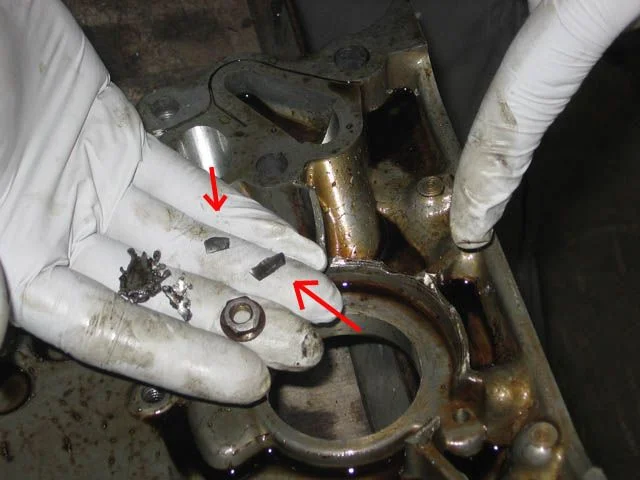

In this photo the two red arrows are pointing to the peice of aluminum that was making the most of the noise, and I am pointing at the broken jaged aluminum housing that set aluminum peice originated from.
those other two peices were accually a buncha shavings that had been mashed together and were plyable and able to be crumbled into metal chips.

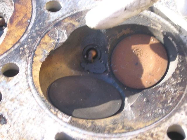

here is an out of focus shot of the head
more specifically the dent that the aluminum made in my head
sry its out of focus my camera was not up to shooting that close.
