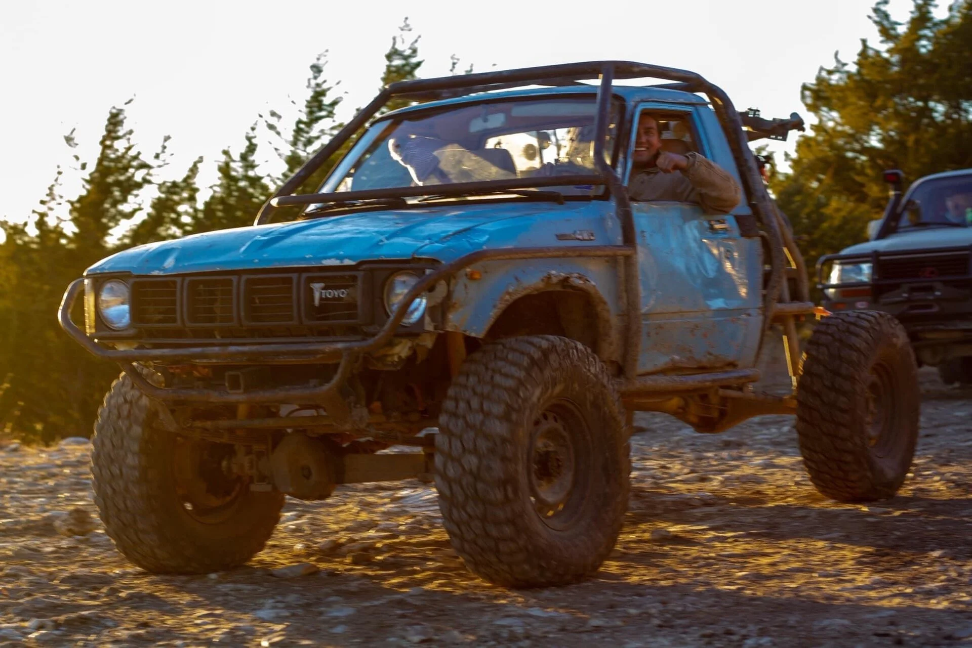

Planning on tackling the Rubicon later this year in my 1981 Mini Truck with a propane converted 22r. A buddy of mine built the rig a number of years ago and it's been a weekend trail rig so efficiency is not particularly important. Tackling the almost-17 mile Rubicon puts a slightly different slant on making sure I have enough propane to handle the trail.
It's got two 8-gallon forklift propane tanks on the back of the rig currently. Fabrication would be needed, but have another two at disposal. Puttering around the trails at the offroad park, it gets a full day and potentially some of the next on the 8 gallons of propane. Mileage is unknown on these weekend trips, but it's probably not quite 8 miles of wheeling (or half of the Rubicon).
It's my understanding fuel economy on propane is about what it is on gasoline - some variance depending on the source.
So, for those that have done the Rubicon on a propane mini truck or 4runner on 35s, how should I approach the fuel situation? Am I good with two 8 gallon propane tanks? Should I find a way to carry a third or fourth propane tank to complete this?
Thanks,
Jack
Pic of rig as a reference.

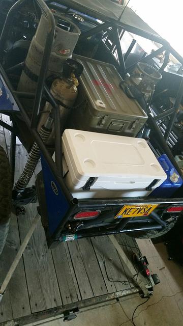

Here is my experience: I ran the Rubicon in my old truggy (22R on propane, 5-spd, dual cases, tons, 42's) from Loon to Rubicon Springs and back to Loon. Before the trip, I modified my cage to hold two propane tanks. I did that whole trip plus a half day wheeling back home on the large tank.

The larger one looks to be something like a 30 lb tank?
Thinking back on it, they may have been the same size and that pic one is sitting lower... No idea on the size, though.
That’s interesting. So, let’s say that it is the larger tank, that’s going to be a 10 gallon tank. You did a lot go wheeling on either 8 or 10 gallons (worst case). In my case, I’d have 16 just as it sits without modification between the two 8 gallon tanks.
How long did it take you to do the Rubicon? It’s possible that I will have more idle time doing this in 2 days.

I actually did two days to Rubicon Springs, then one day out.
