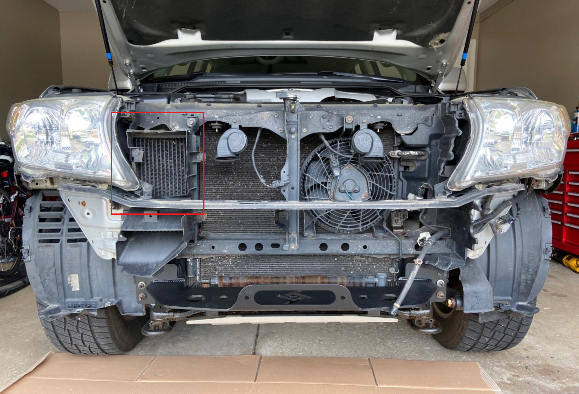

Is there any leak under the car? Could be as simple as low fluid. Either from a small leak or due to the incident you described. There is a transmission cooler ahead of the radiator that could be vulnerable (boxed in red), and the circuit does also tie into the bottom of the main radiator.
Unfortunately there is no transmission dipstick and it requires checking fluid level through a process that brings the transmission to operating temp and fill hole on the transmission itself.

Good call. After more examination the grill took a large (3") rock and the grill broke allowing the rock to lodge against the transmission cooler. There is no sign of a leak but I will need to replace the transmission cooler as it looks like the tube are bent slightly.

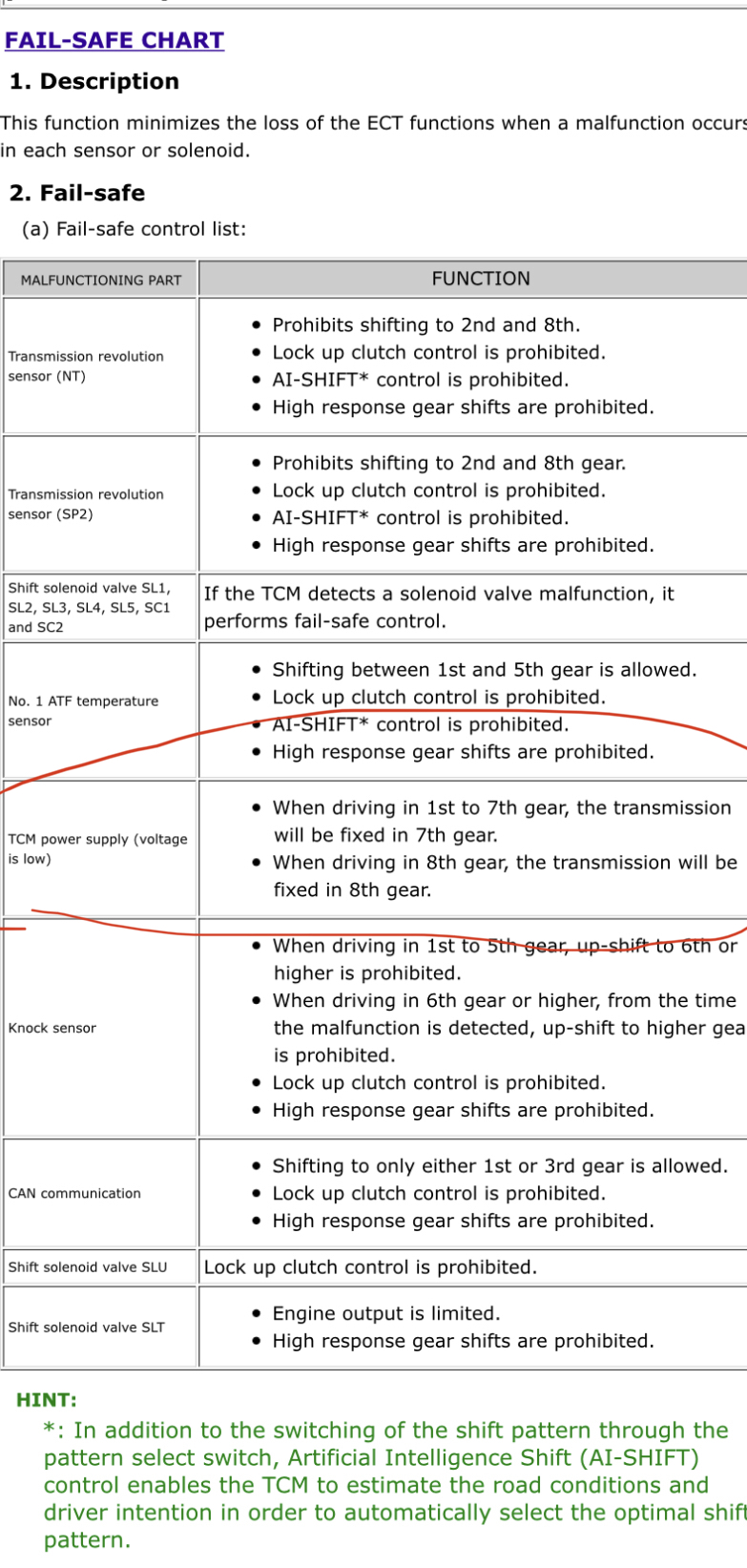

It very well could be in 7th or 8th gear. The gear indicator on the dash shows D, s1, s2, s3, s4, s5, s6, s7 etc. I don't know if the transmission would be 7th or 8th gear and the indicator show something different.
Reading above that says if the TCM senses a shift solenoid failure or malfunction it performs a failsafe mode. Does anyone know what performing a failsafe mode means?
I think limiting to only 7th/8th gear *is* the failsafe. It's a failsafe for when the TCM power supply voltage is low (or missing?)
