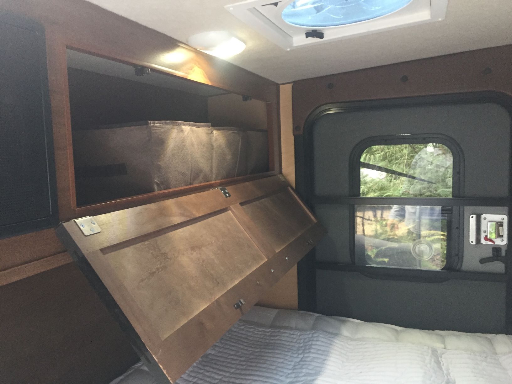

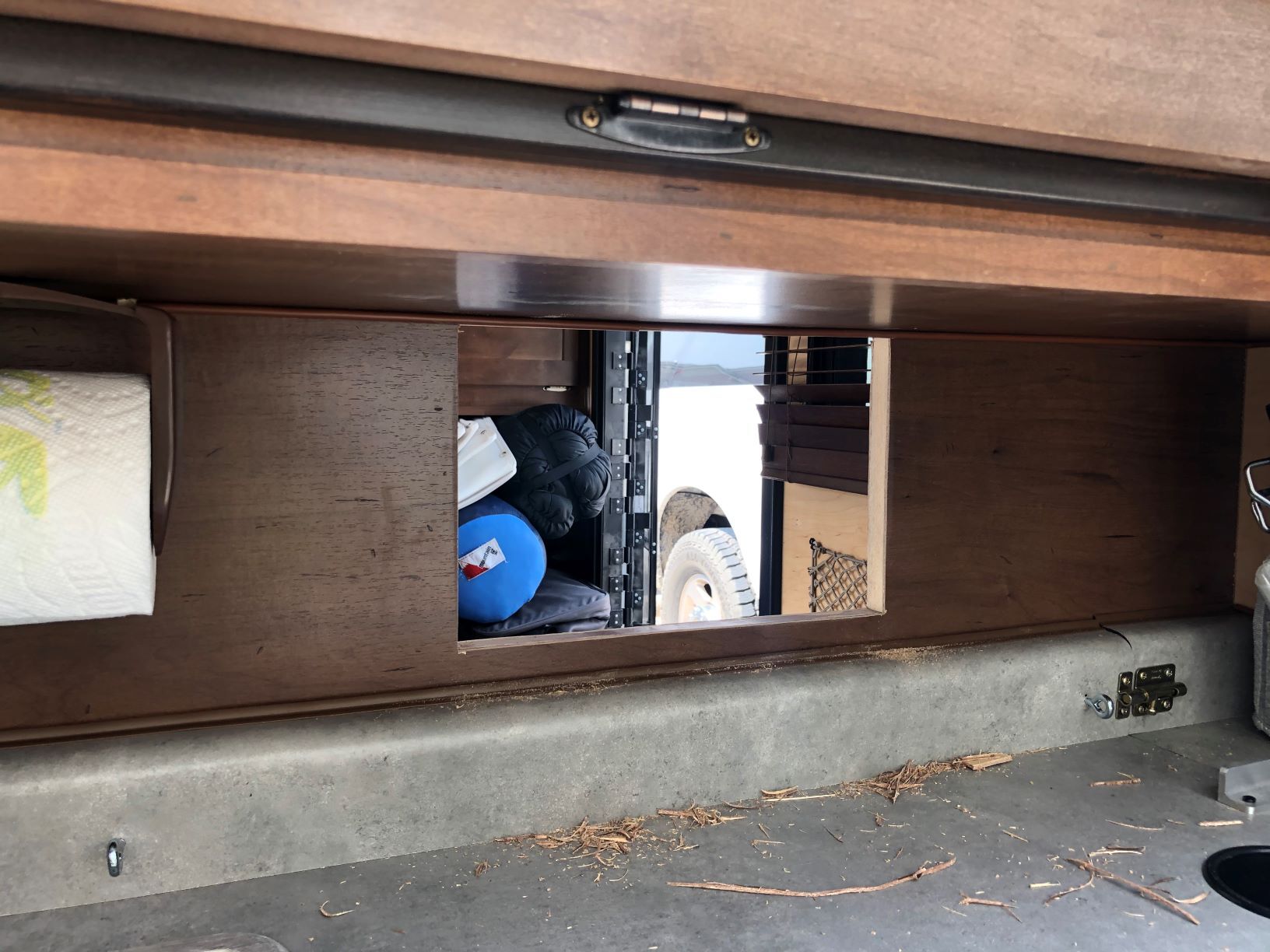

Got my brother-in-law, Dave, to install a pass-thru window in the wall between galley and sleeping area. It's not for me to "pass-thru", but for convenience. Other similar trailers to mine have this built in from the shop, but it wasn't a TFM option back in 2018. So what do you do? Improvise. Dave has considerable experience with trailer and houseboat construction and repair and offered to give it a go when I showed him what I wanted. Of course, he wanted to finish it off with more trim, but all I wanted was simple access to the galley from my bed. Turned out perfect for me. And just the cost of hinges, knob and I added some coat hooks from Lowes for convenience.
Wall above counter before:
Wall from sleeping area before:
During project:
Finished as far as I was concerned:
Midnight snacks with less chance of spilling food or drinks all over my bed and not having to walk around to the galley are now possible. Door shuts and seals sleeping quarters from bugs during the day.
