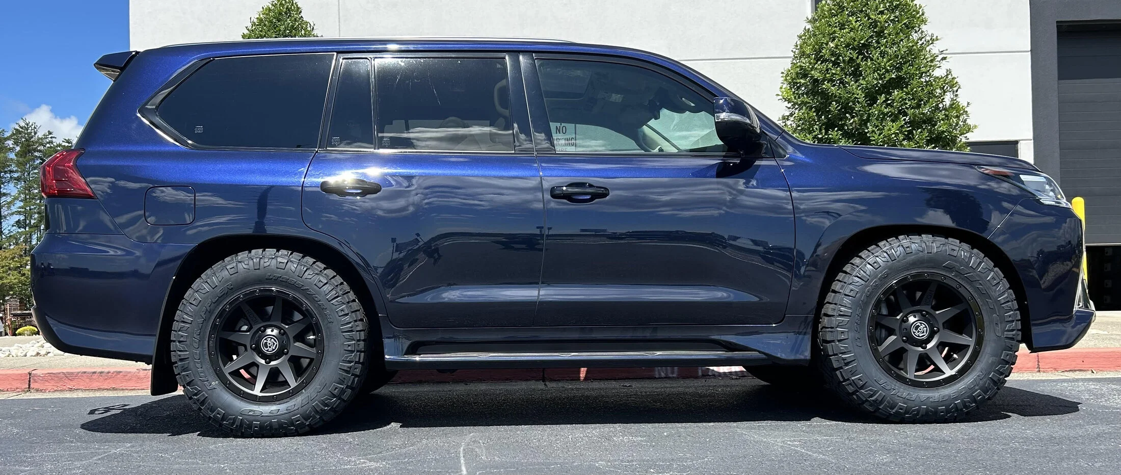

I'm not quite ready for the Dissent Offroad bumper w/ swingouts (very spendy), but I am looking for options to carry some jerry cans and other items that I don't want in the cabin. I guess a roof rack is the way to go for extra fuel carry etc right? I'm curious about the go to roof rack? What models should I look for? Included here is an obligatory pic of my 2018 LX.

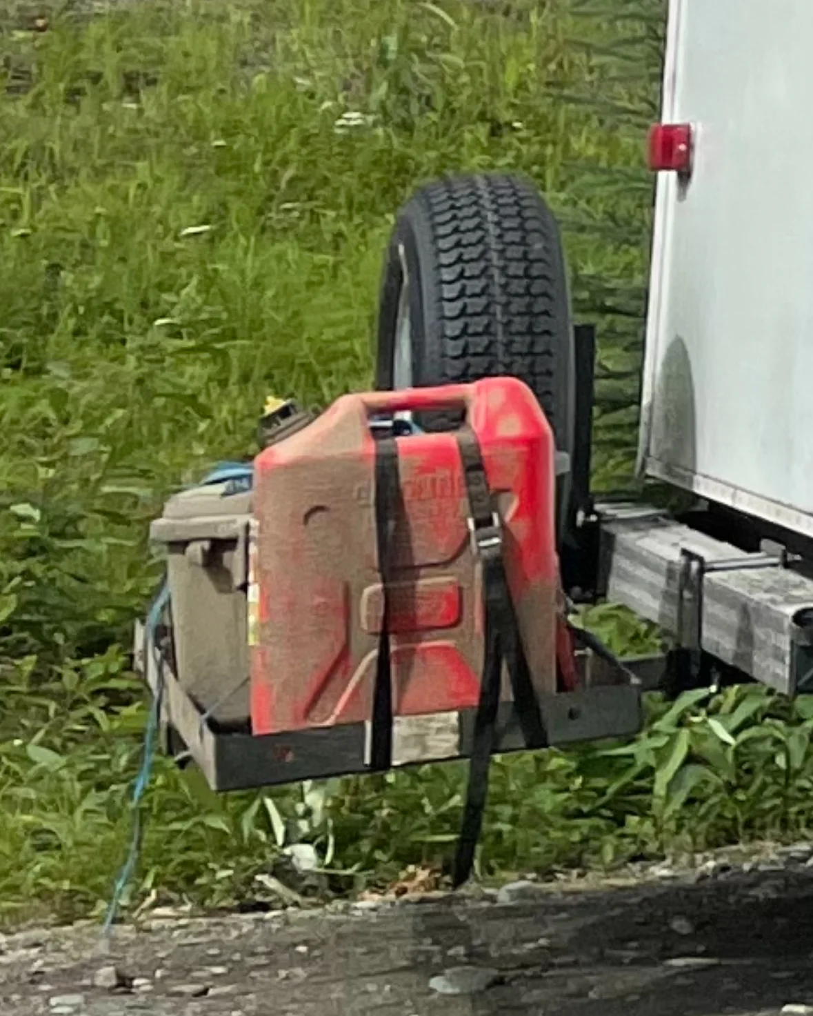

Hitch tray all the way for gas,…. I use one when I travel up above the arctic circle on the Dalton. 15 gallons of gas and a Plano with fire wood.
Here is my set up. This was on the back of my camper trailer on the way up 3 weeks ago. Just north of Fairbanks (AK) I park the camper and swap the rear tray to the back of my LX.

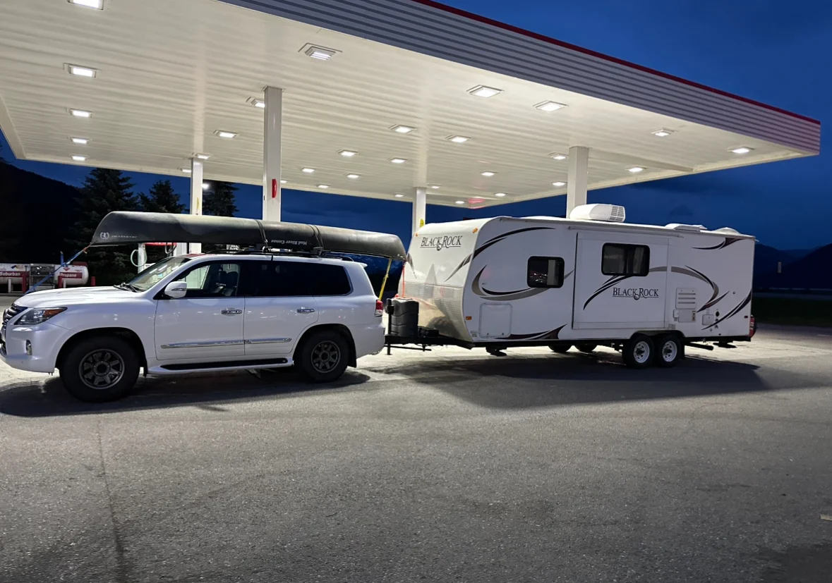

For a roof rack I’ve used yakama round bars for >30 years. I’ve had this set up of OEM LC rails with rail grab feet and 66” bars on my LX for 11 years (had the same crossbars for >20 years). I use it for: skis, a skybox, mega warrior basket, skinny warrior basket, bikes (when I have >4), a 16’ canoe, RTT,…. The bars come on and off in ~5 min.
