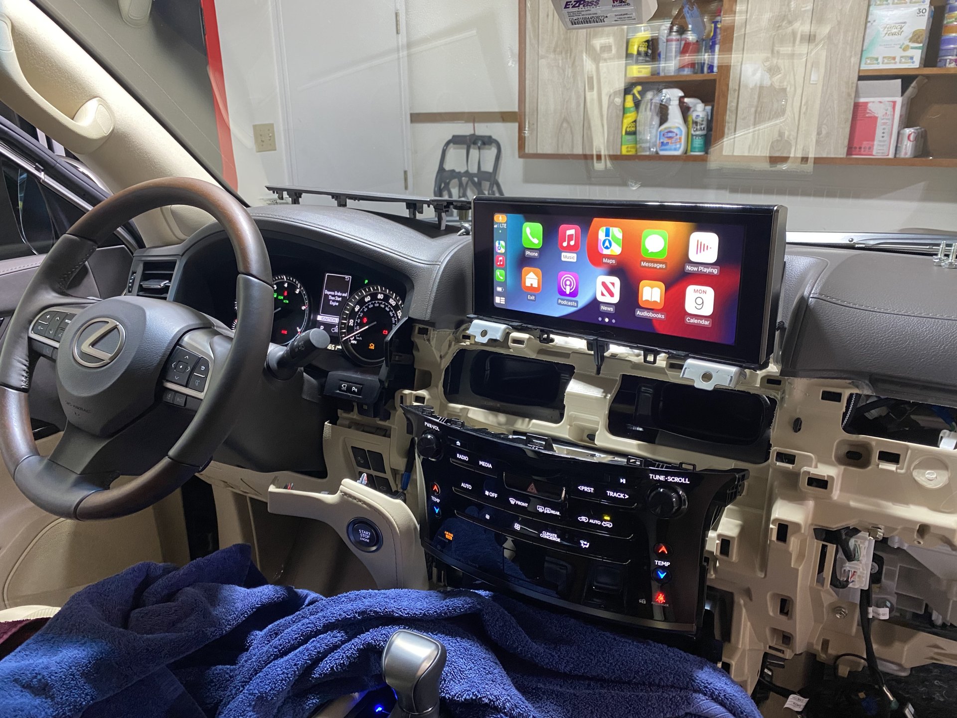

Got my 2016 lx570 right before Covid 19 and today I just finished doing the carplay upgrade on it. I did some researches and find a couple of solutions before I pull the trigger and want to share my experience with you guys so you know what to pick if you want to upgrade LX's info system.

I end up getting some unbranded carplay console from aliexpress and it is around 300 bucks. I think it is self developed system and it has more function than beat sonic which includes wireless and wire carplay, wireless and wire andriod auto, iPhone airplay (iPhone wireless mirroring function), USB video play but has less than Grom Vline since it is not andriod system. It displays carplay apps with a 5x2 grids and the resolution looks much better than beat sonic. The bad thing is that their technician has no idea on how to install it and the customer support is none when you have trouble to install it. But after two day's try and with the reference of beatsonic video on youtube, I am able to install it successfully and have it run smoothly. It supports our 360 surround camera when in back up mode but it does not support the auto surround-view camera when the vehicle is in slow speed.
In conclusion, I would say that if you have enough time to work on your car and love exploring new things, you can get the unbranded console from aliexpress and DIY but don't expect any helpful customer support during installation. If you want to save your time and have a fully supported customer service, I would recommend you buying beatsonic or grom vline even though their prices are higher but it is worth it.
