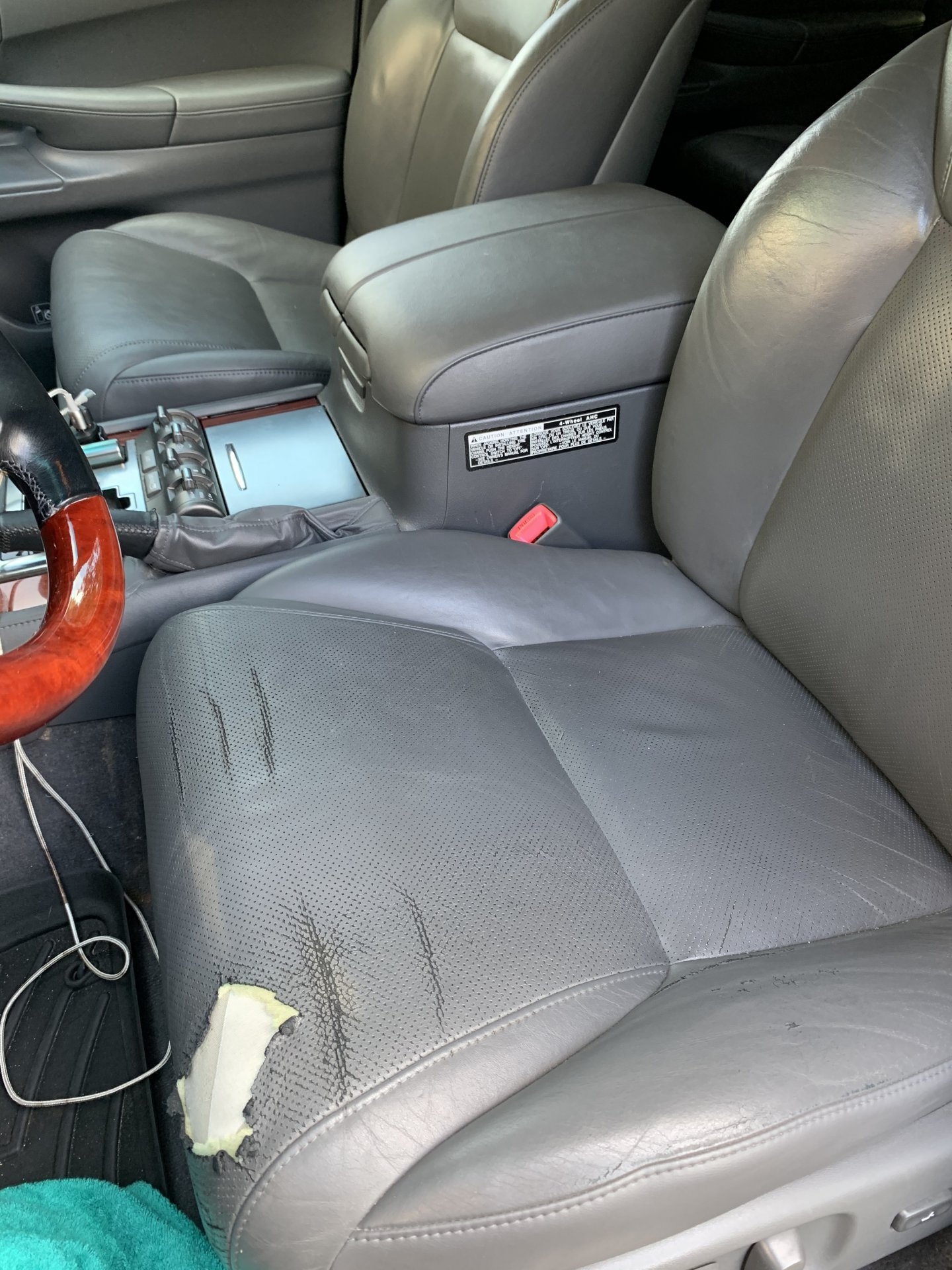

After: functional armrest but still a huge hole in seat cushion. Cant believe there aren’t any aftermarket seat cover options in grey perforated leather?????

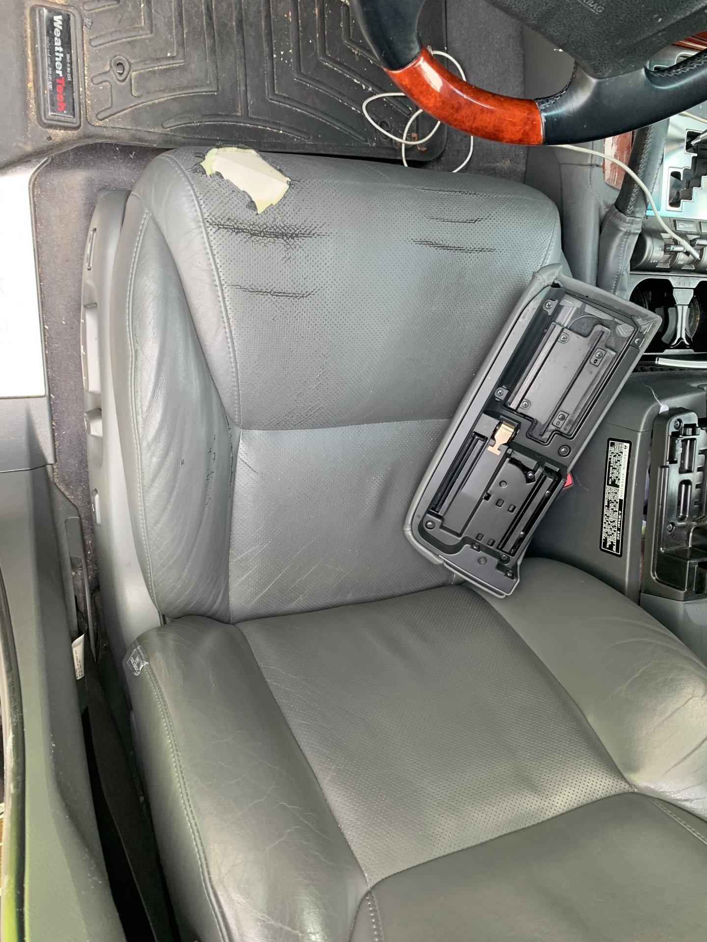

Step 0: open it up... pull the armrest off the base. If still quasi attached play around with a long pick, stick, screwdriver or a long rigid zip tie to get it to release. super hard to explain but aim your utensils of choice near the shiny metal, which is closer to the outside near the seat. I did this from the backseat stabbing towards the front of the car while peeping under armrest with a headlamp. Very tricky and frustrating, but eventually you’ll be victorious.
Once off, Flip armrest upside down and remove the 8 screws and use a trim removal tool to release the plastic underside from the top side. I’ve placed the screws near where they came out.

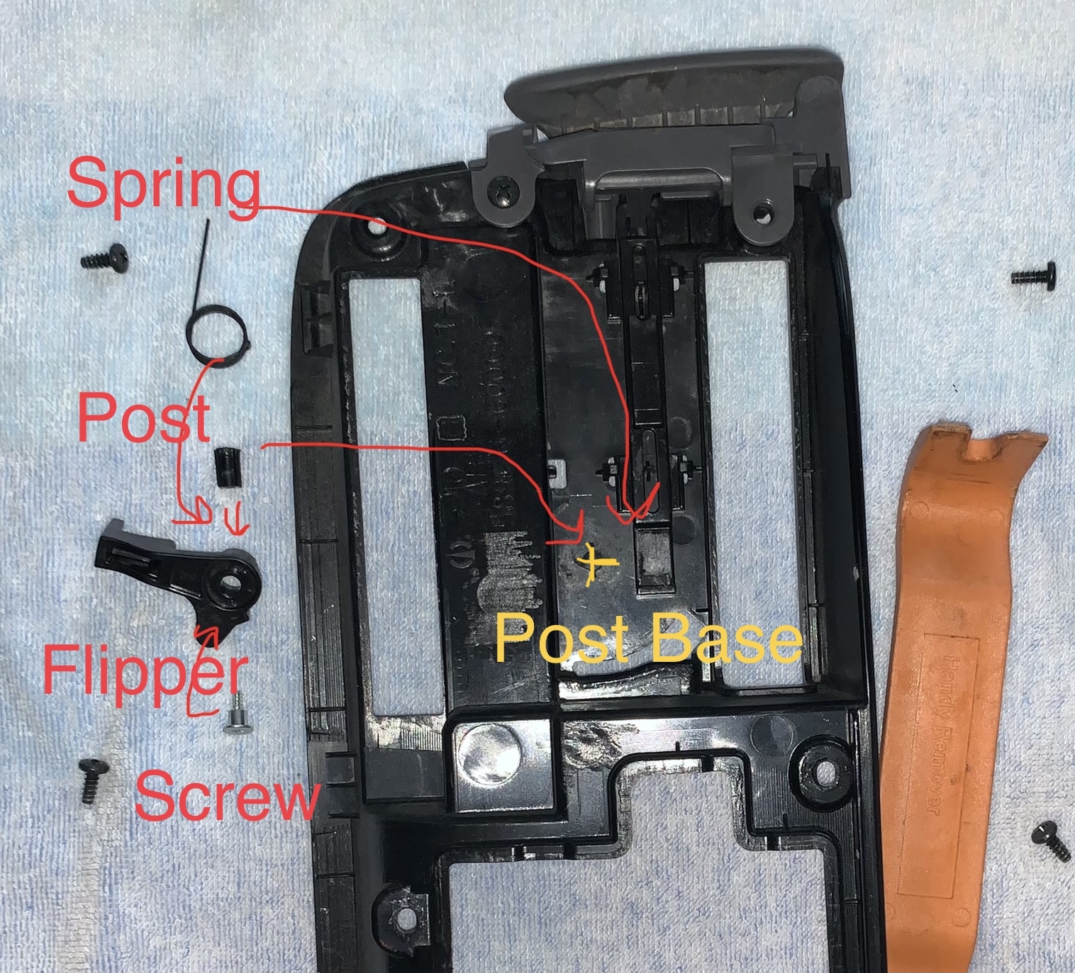

step 1: identify if it’s the plastic post that broke off. And if it is still present. The post goes inside the “flipper/flapper” that a silver screw goes into from the top of the flapper.
The post snapped off from the base, basically making the spring and flipper loose inside the armrest lid. The screw will still be attached to the flipper and the broken post will remain inside the flipper. Take a needle nose and hold the post while unscrewing get the screw from the flipper.

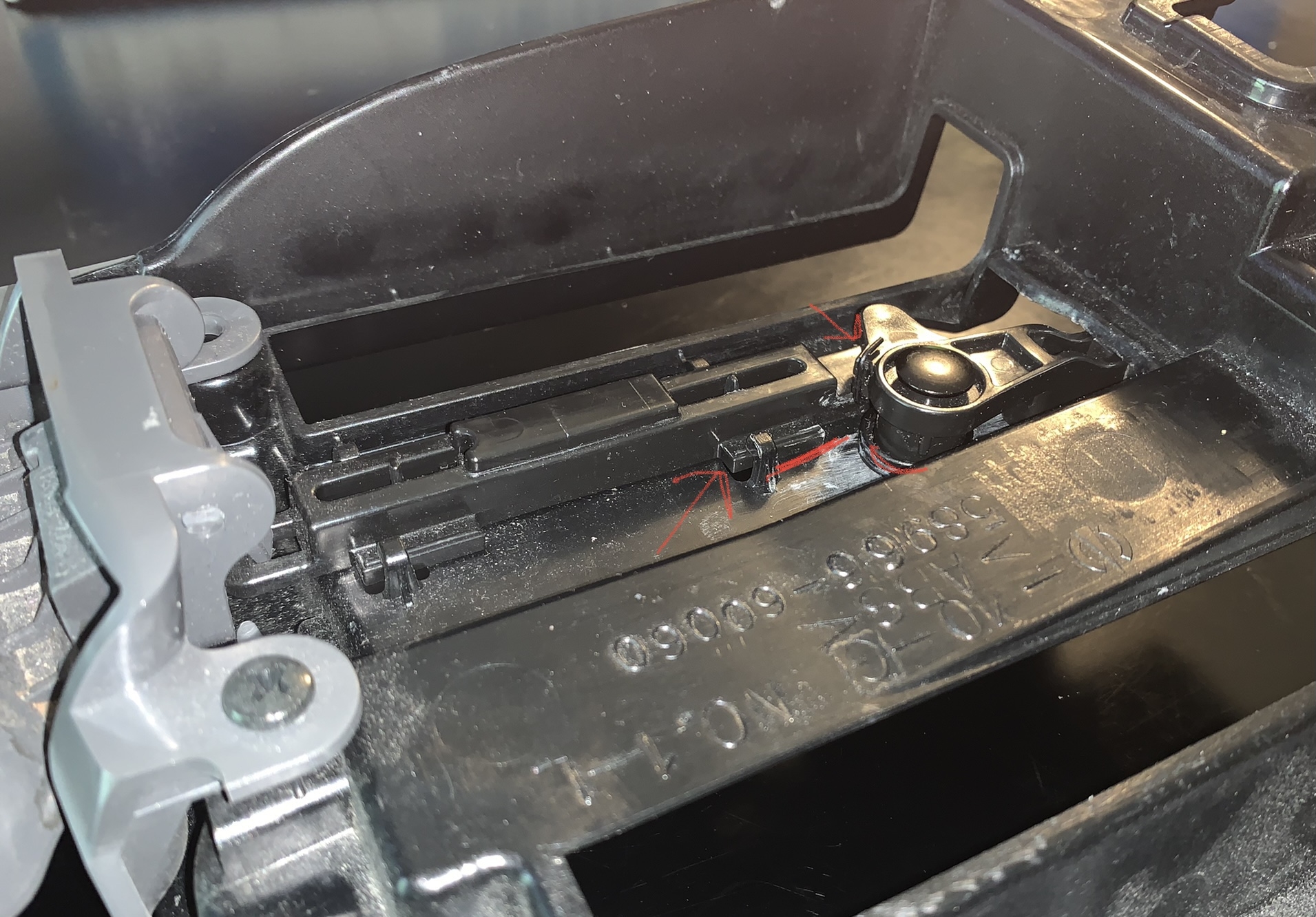

If the base and post seem mostly there and salvageable, you can consider jb welding it, but this may not be a long term fix. I did it and then reverse my decision once I found parts.
here was my temporary jb welding. Probably would hold for a while. Was pretty hard to snap back off once I found the hardware. Try not to leave too much at the base, wipe excess off before it cured so it doesn’t interfere with the smooth rotation of the flipper.

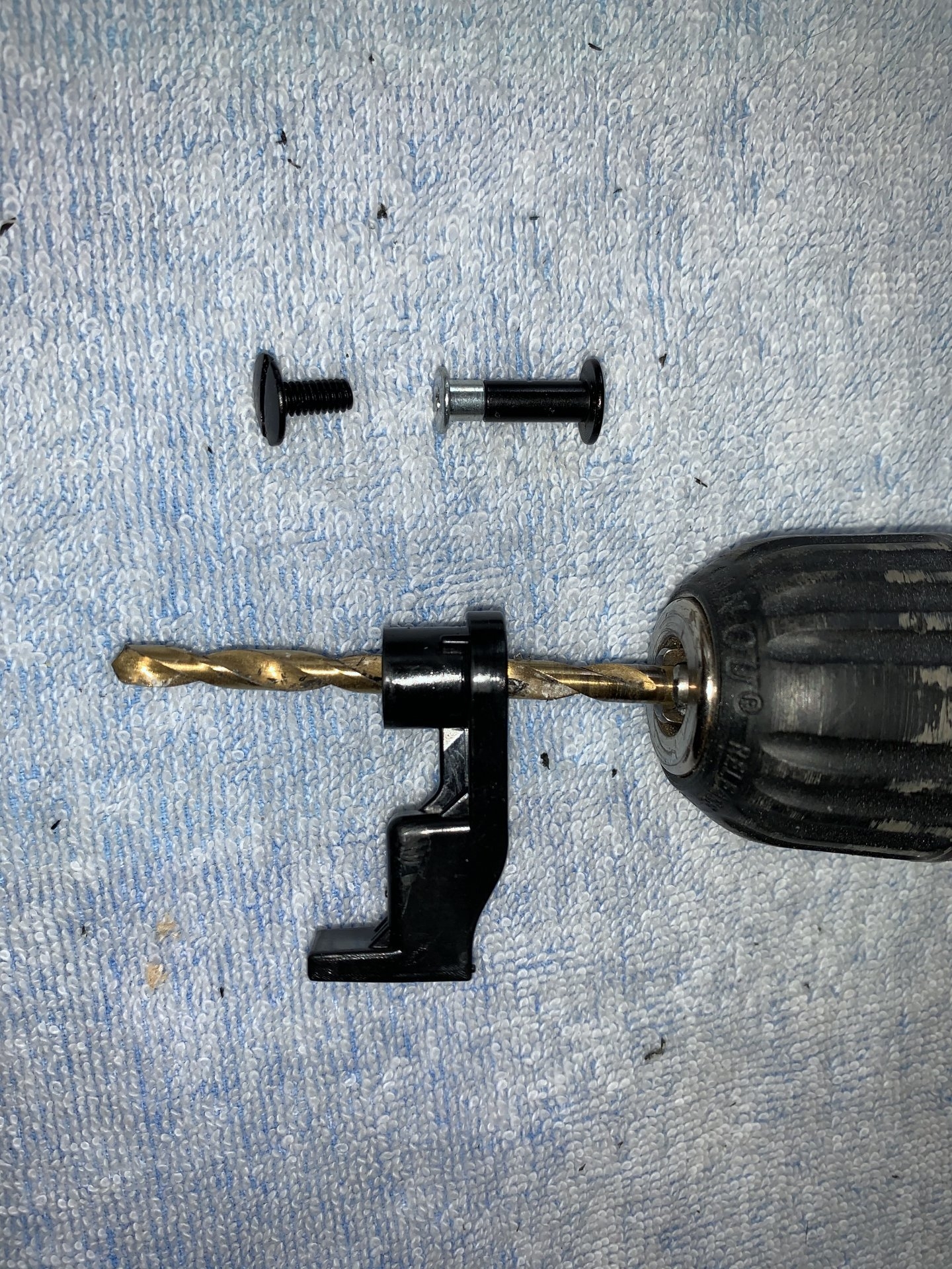

Step 3: do some drilling.
A. Fist we drill a hole in the lower armrest base to allow the new threaded black screw to go through where the original post was. This is fairly easy to find where to drill since there is a circular indentation, aim for the middle of that. Once the hole is drilled slide the screw upward from the base of armrest and attach you snug plastic nylon washer over the threads. Mine is pink and homemade from the top of an almond milk jug I found in our recycling bin because I was stuck in the house and couldnt get to hardware store due to a family commitment. I don’t recommend this, it was silly, frustrating and a terrible use of time but I was inpatient. I now have an appreciation for the cost of small washers!
In this picture you can imagine how ultimately the flipper will go over that screw sticking up through the pink washer, and then the new female black tube will go on top and through the flipper...
B. Test and determine if the black tube/ female part of the new hardware fits through the top of the flipper with enough clearance to smoothly spin without friction... but should be tight enough that the flipper doesn’t rattle around loosely. Mine needed a bit of surgery with the drill to make the hole on top of the flipper big enough to accept the female tube smoothly.
Note the size diameter difference between the silver screw and the née black tube... Hence why we needed to drill the flipper a bit

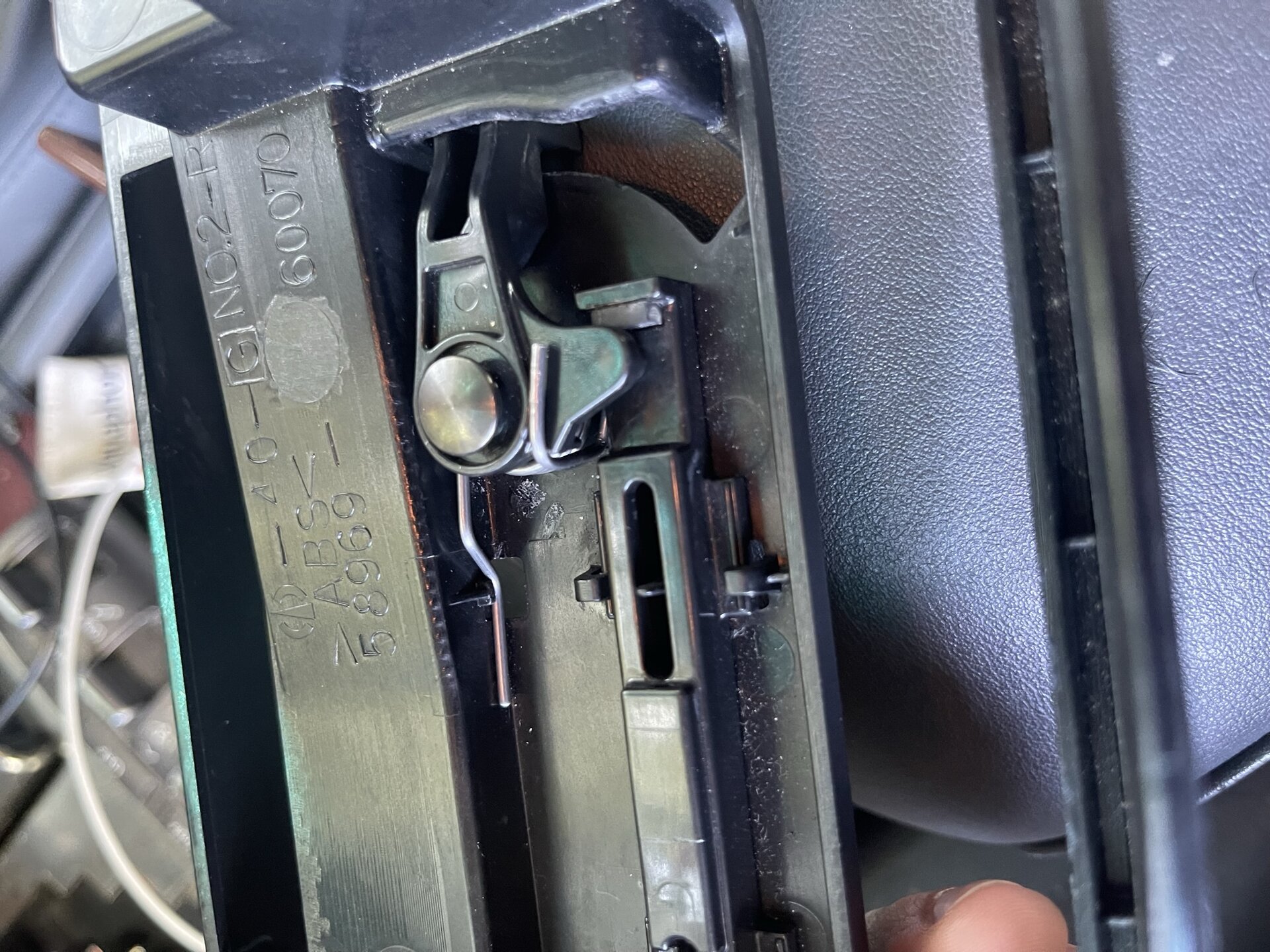

Once all bits are in place test out the handle on the left side of the pic above... confirm that when u pull the handle up, that the internal arm pulls the flipper towards the handle, rotating it counter clockwise.. then upon release it should snap back due to the spring. If it doesn’t keep finessing the parts, because they might not be lined up or in the right position.

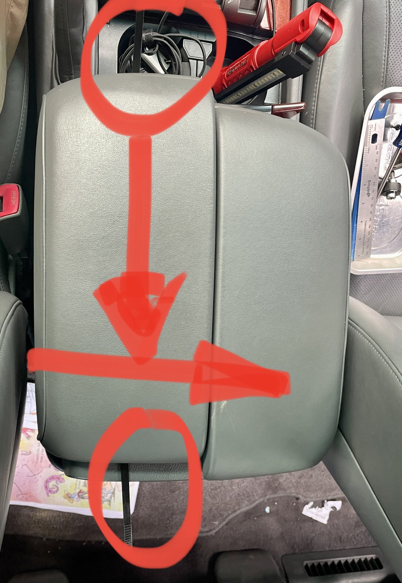

Few guys were asking about getting the arm rest off. I used a 24 inch zip tie. Insert it from the front, out the rear. Then start working in back and forth towards the center (metal clip) of the arm rest.

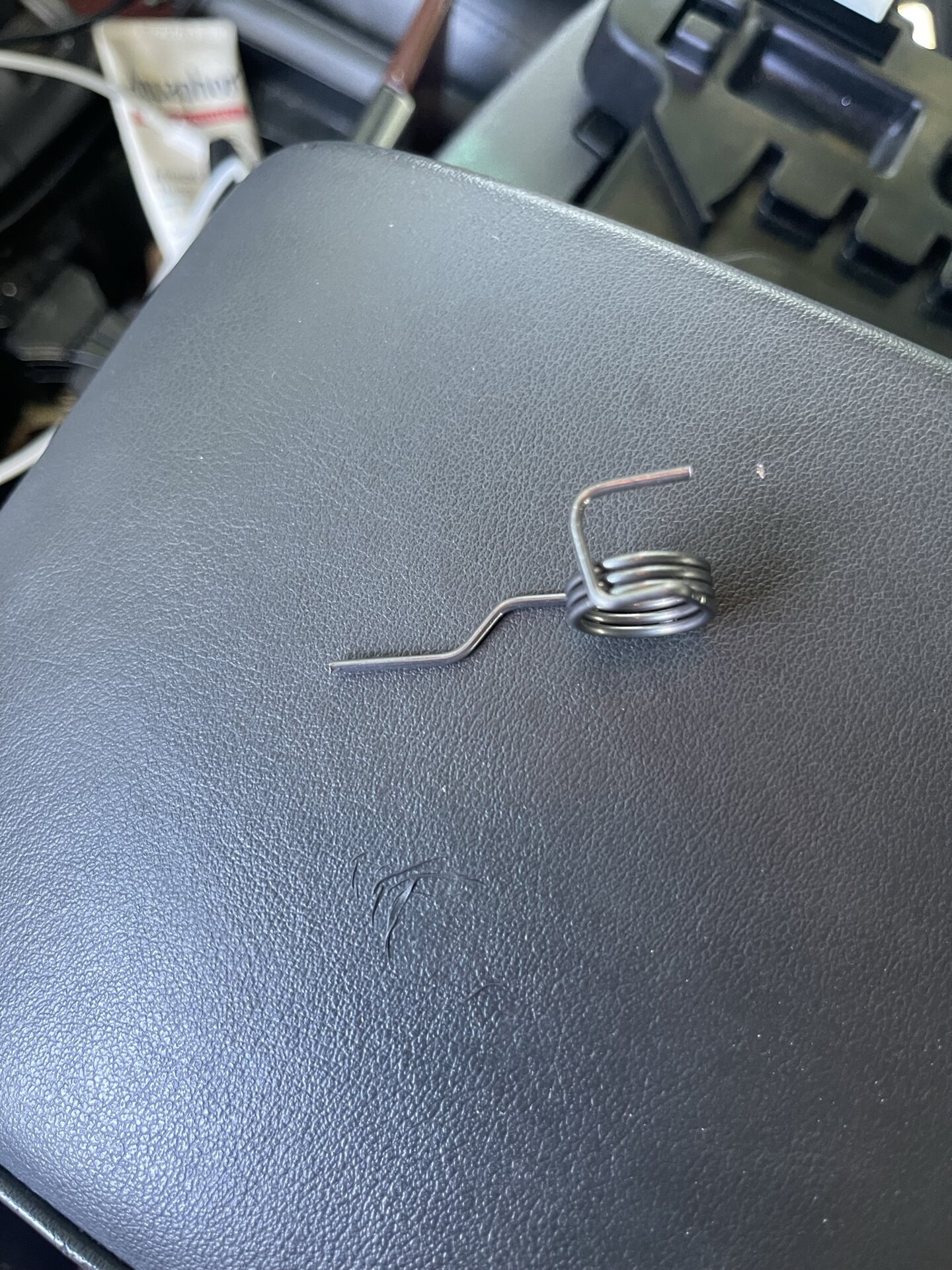

To those looking for a replacement spring, I have found something that worked for me with some adjustments. Had to get something from eBay so I can't give a part number and links will die eventually, but here are the specs of the spring that worked for me:
  • 1.5mm Wire Diameter
  • 16mm Outer Diameter
  • 3 Coils
  • 60% Angle
I had to bend one a little to get it to fit my armrest, but in the end it works perfectly and I am satisfied with my handiwork. Here are some pictures showing how I got this torsion spring to work for me.
One thing I did not have control over is the winding direction of this spring. Not sure whether this is "Left" or "Right" winding, but this was the wrong one for my passenger-side armrest. It worked with the bends you see in those pictures, but it would have been easier (and probably stronger) if I had gotten the other winding direction. Also noteworthy, I believe this winding direction would have been perfect for my driver-side armrest.
P.S. If you are having trouble finding a compatible spring, try looking up "Small V-Shaped Torsion Springs." That may turn up some more options.
