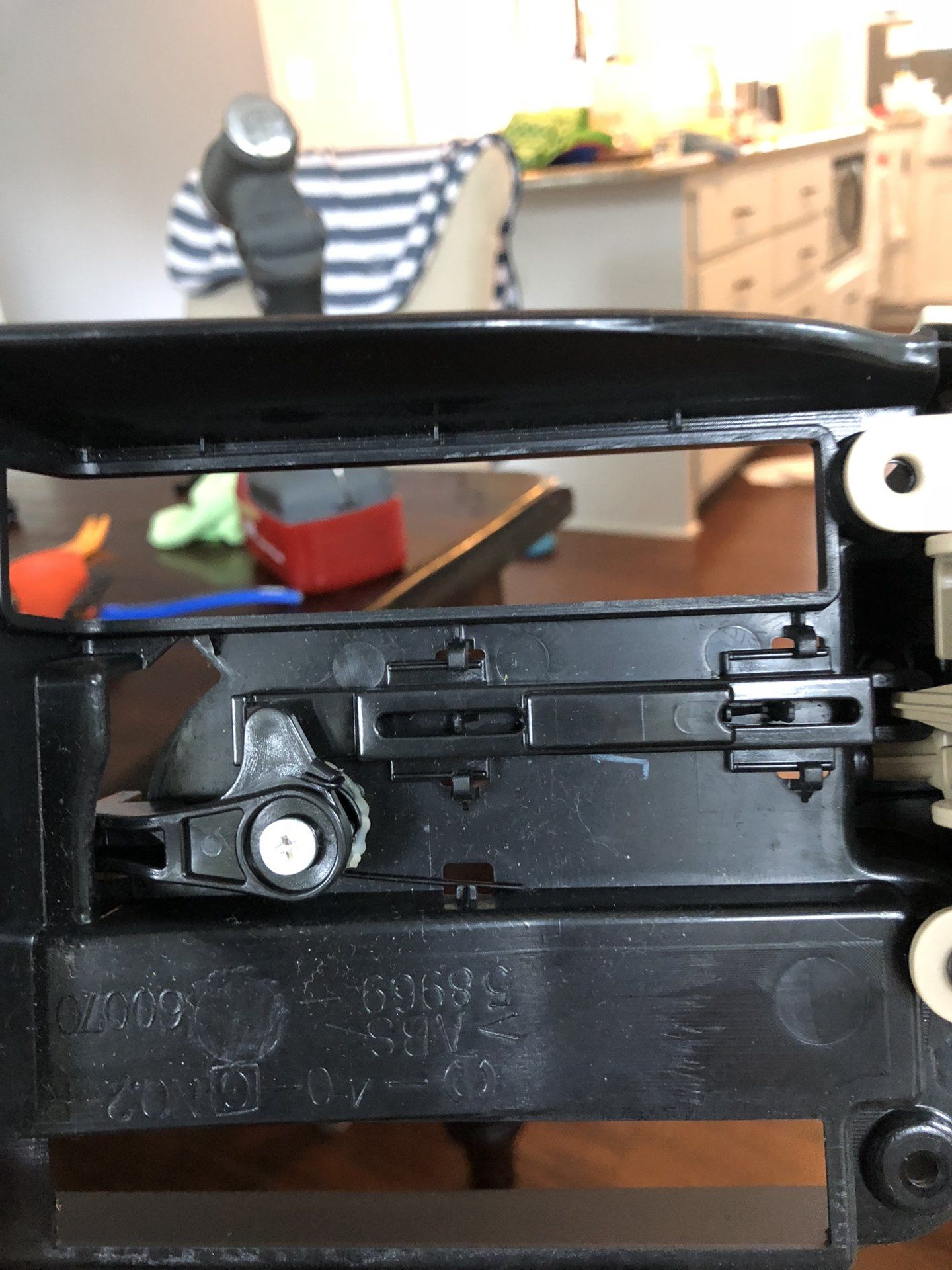

The picture below is what is broken. Forget plastic glue - worthless. Buy an elevator bolt and a nylock nut, drill out the hole and the plastic bit that broke and use the bolt. Grind the bolt head as flat as possible and sand down the hidden plastic in the arm rest where it glides so it doesn’t rub. Reassemble. Stupid plastic
This was sent from my phone so not as detailed but let me know if you need more. Easy fix!

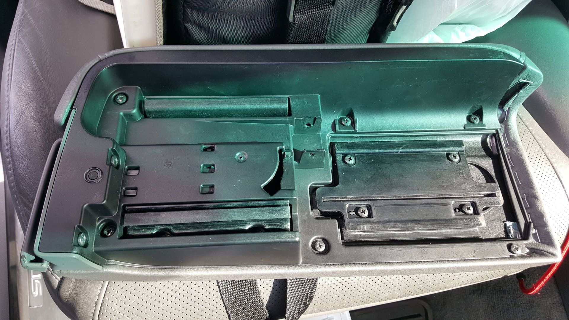

yes, please send more pictures. I would appreciate it. How do you get the armrest back onto its base after that piece is reattached? also I don't have the spring that goes around that piece (flipper) that broke off. any extra comments or details would be appreciated. It looks like on mine a piece on the base is also broken, not sure how that will impact operation. I know that the front right corner of the armrest pad moves up and down when pressing on the armrest (not sure why that is. ) I will post some pictures shortly. thank you so far

May take the screw it from underneath option. Here are some more pics of mine.i wonder if any junkyard has a console lid? Not sure what is missing from this CAVITY that has 2 holes in it.
Most of the pictures I took are unfortunately different angles of the one I posted, but if you send me your email i'll send you what I have.
Not recalling right off the top of my head what might be there, but I do believe that with a spring and that piece attached, it's actually that arm that locks and holds the arm into place. If you secure that (and get a replacement spring), it should hold. I ran the bold directly through that piece, Lowe's sells those elevator bolts that are the correct size. I don't have the exact size but they are called Torsion Springs, and you can find them online. (Grainger has some). I'll post a close up of how the spring is shaped

yeah - on mine the flipper itself was fine, but where the screw attached it to the armrest itself inside had broken. I drilled straight through, used a bolt and nut to hold the flipper back in place, but the bolt head is proud of the plastic, so I ground it down so that it was as flush as possible. Turn the armrest upside down and you'll see the gap that is present as it slides back and forth. Wherever the bolt head touched, I sanded down a little to give it more space.

On mine, the shaft that is attached to the armrest that holds the flipper on had snapped. I tried gluing it back and then screwing the top in, but none of that worked. Instead i just used an elevator bolt and nut in place. Do you have a picture of the inside of yours (like my pic above)?
