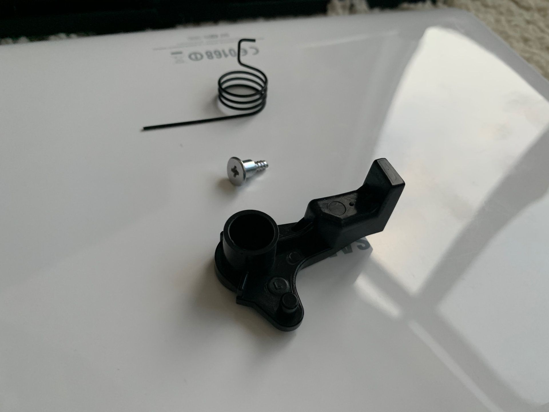

Just as I thought if anything else could break on my truck, the driver side armrest became loose. Turns out this little guy here was broken somehow and it was an easy fix with super glue:

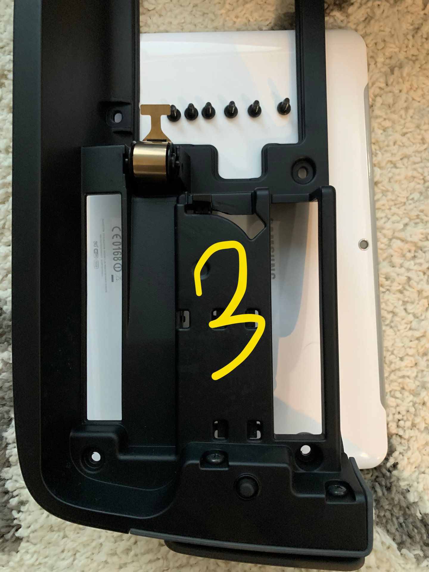

It wasn’t clear to me how to assemble the rest of the part so i’m posting the following pictures to help the next fella with the broken armrest:
Okay now here is where I’m stuck, I can’t figure out in which direction (1, 2, 3, or 4?) to assemble this little guy, any thoughts?
It will only fit 1 way when you reassemble (I thought it was facing the front but am not so sure). I wouldn’t trust the glue though, I tried and it snapped almost immediately.
Yeah thanks. You were right it only fits one way, which is #1. Assembled it back before dropping the truck at my trusted garage for some AHC diagnoses. Let's see how long does the glue holds up!

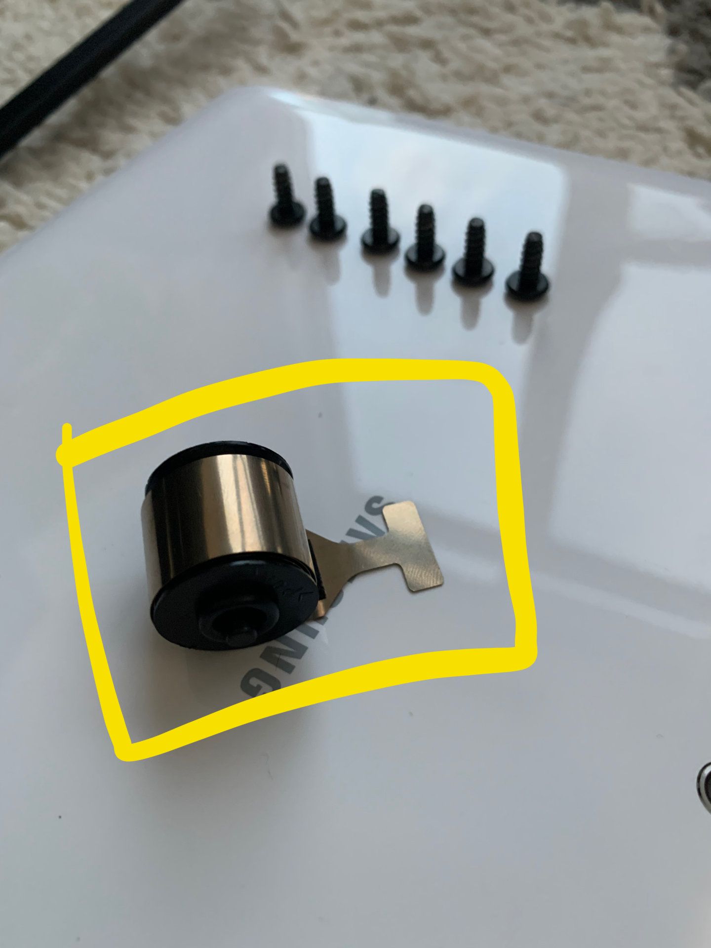

I am gluing the broken bracket back together like you all have done. I am missing the silver roller spring thing.
is that going to be a problem?
