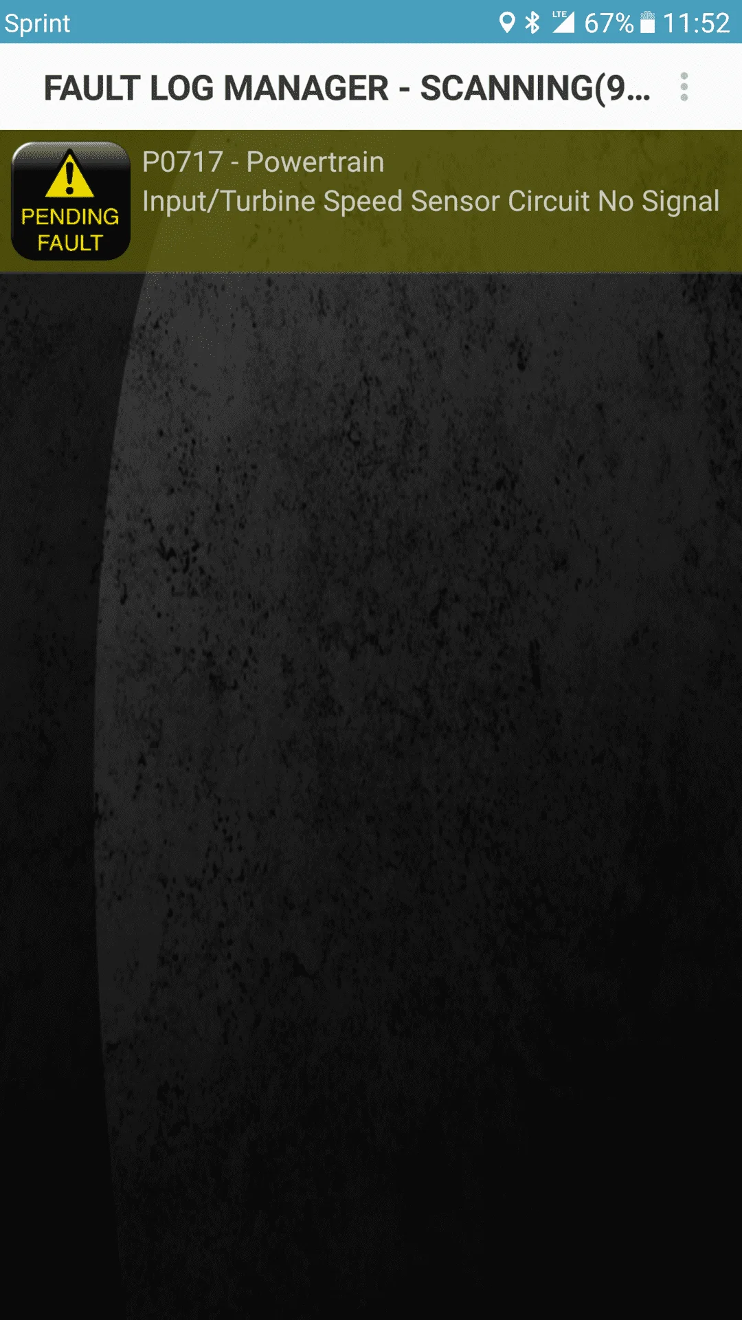

CEL p0717 is the code from my torque app. Quick lookup states might have something to do with speed sensor circuit no signal.. Anyone ever have this issue/cel come up on 200 series platform? I don't have a 200 series FSM avaliable so don't really no where to start.. Google search just provides random issues with other Lexus models....

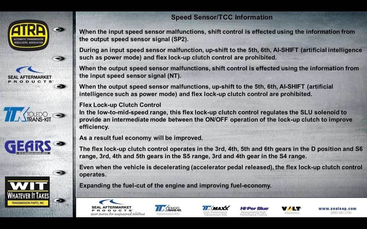

Think I found all my answers... Awesome youtube vid about the AB60 toyota transmission... Here is a link and a couple pics from vid

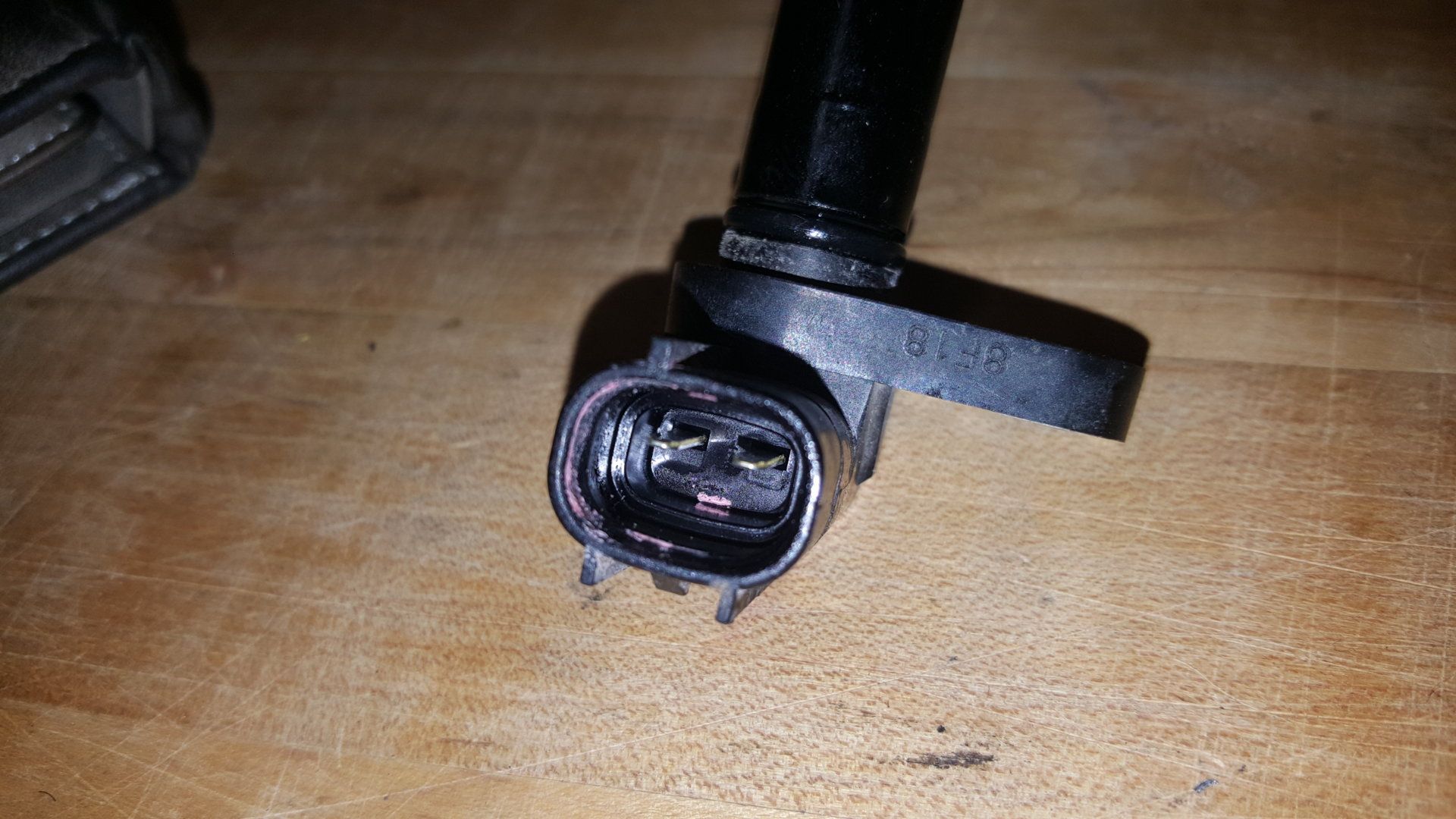

When I first got the truck couple years ago, it had the dreaded valley leak. Coolant would leak from the back of the engine down to the bellhousing, then to the passenger side of transmission. I am starting to think that coolant must have got into some of the terminal/connections of the sensor we speak of (Turbine Speed Sensor). This has happened to me before with the 80 series, well sort of. PHH was dripping coolant onto my NSS on side of transmission and over time, the coolant corroded a couple pins and they broke off when I went to inspect that plug/terminal. I suspect that there is either a contaminated pin/s in Turbine speed sensor connection or it might be already corroded .. I will report back today..
Well, well, well..... Definitely looks like dried pink coolant to me...... Have not disconnected terminal / plug off yet or sensor waiting for the catalytic converters to cool down because I don't want to get burned...Looks like it's going to be a tight squeeze.... Can't wait to see how pins look inside.... On a side note, when I started it this morning the CEL was off...
Coolant did get in plug, but male and female pins look good... Will have to test sensor..

Resolution: Searching for the trouble code here helped a lot because I saw @cc93cruiser had the same lights on the dash. My truck was perfectly fine otherwise no other codes, and again, seemed to be running fine. I ordered part #894130C021 (Transmission Revolution Sensor) from my local dealer and it was delivered the next day. The sensor is just like the pic above (passenger side) and only takes a 10mm wrench. After 5 minutes, clearing the code and driving 15 miles the permanent code for P0717 is gone.
I wanted to note my original sensor didn’t seem to have coolant and/or visual damage whatsoever. I also feel my transmission shifting is smoother and if I was paying closer attention I wouldve caught how jerky the shifting actually was prior to changing the sensor. If you get this code please don’t drive too much.
