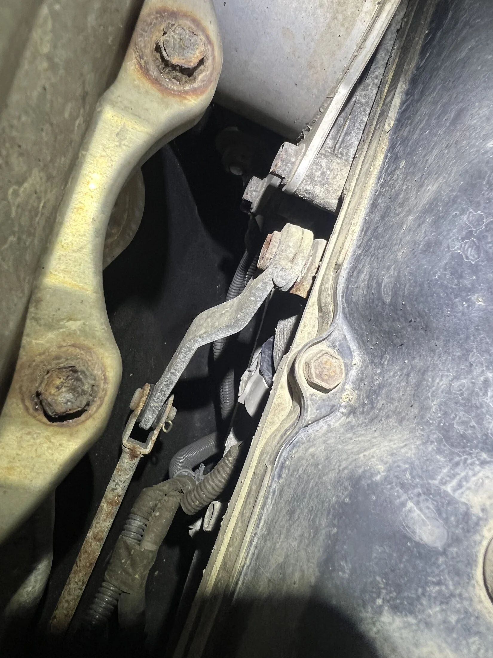

Alright, here's an update and not a particularly good one... The lower rear sensor was pretty easy, one I figured out what I was doing. The upper front sensor was very difficult for me to reach so I decided to remove the 12mm nut on the transmission linkage to free up a little room for my hands, and I sheard the F'ing nut off. Considering that I was under the truck, on a hill, I didn't dare move the linkage for fear of somehow slipping it and killing myself. So I didn't replace the front sensor, and now I'm trying to figure out next steps. *&#@!
Hopefully your parking brake works. How did the nut shear off? Do you have a picture?
Yes, fortunately the parking brake works. The nut was seized and I over did it. Here a pic, three is a nut missing from the lever in centered in the frame.
