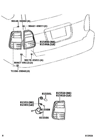

From the parts digram on the 2006 LC it looks like the housing carry the LED's and the turn signal, marker and reverse lights are standard bulbs.

The OEM has a different cable harness for the LED ones (2006-07) - at least for the outers, I don't have the inners, so I don't know about them - It will be possible to make it work if you are good at electronics, otherwise see if you can buy the small cable harness. Further, get pfran's cree LED for the reverse light.
