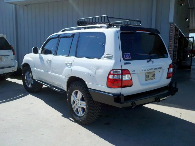

They fit. Connectors are the same. I have them in my 2000 model.
Glad you guys want to upgrade to proper LED tail/brake lights. Safety on the road can start with proper brake lights
Safety... Maybe, I installed them because they look cool ;p. That and I broke my left side out on a trail.
Did you get them off a wrecked 06-07 or buy them new? Did you change out anything else?
I bought them new. There was limited availability on the used market and I bought them for 5% over cost from toyota. I did not have to change anything else.
