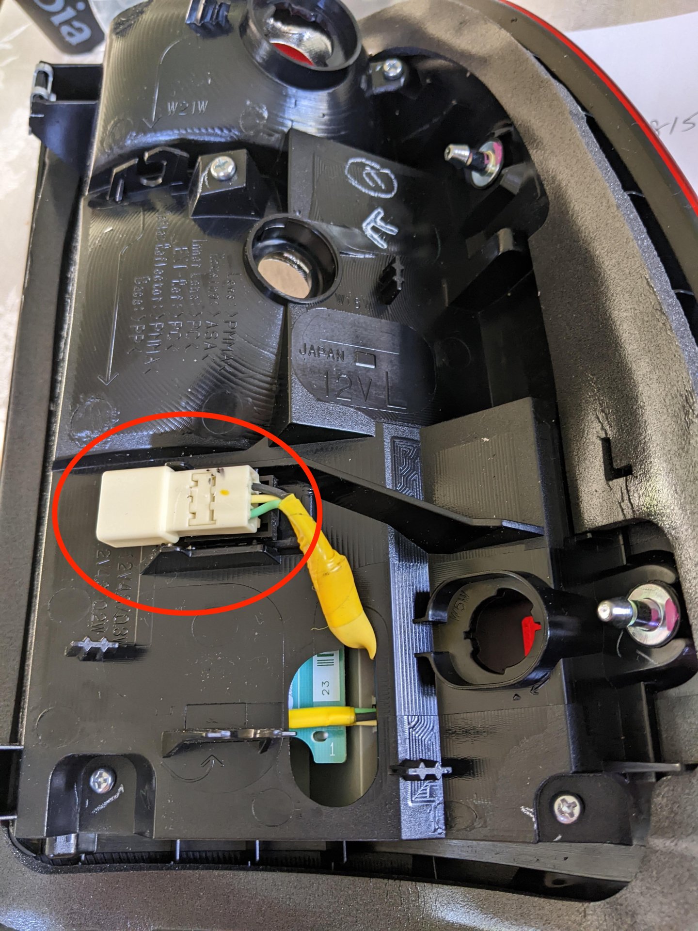

Also, can anyone tell me what this is for? When I picked it up, my local dealer told me there are no LED lights in the housing, but I believe there are. It seems like the wiring harness (81555-60760) only has three bulbs with no other connecter.
