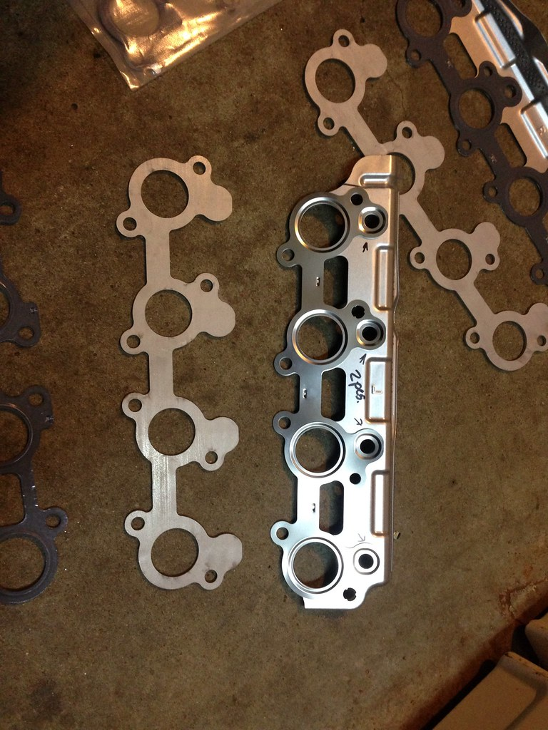

After reading of multiple issues with the Thorley SAI headers for the 06-07, I'm looking at other install options.

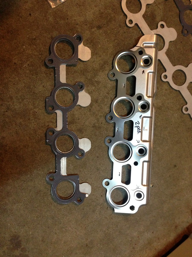

Currently waiting on a quote for stainless steel (304) block off flanges/plates that would allow installation of the earlier 98-05 Thorley headers on 06-07 trucks. With SAI equipped trucks, you either need to block off the SAI head ports with a plate or tap the holes and block off with nutserts and hi temp threadlocker. Obviously plates are less permanent.
The way this works is: install 06/07 OEM gasket, then stack block off plate (1/8 or 3/16"), then thorley gasket, then header and bolt down.
Pros:
-98-05 Thorley headers are significantly cheaper and seem more readily available
-No concerns with primary tubes rubbing on frame/mount like the 06/07 SAI headers
-easier installation - no blind bolts w/ the SAI tubing
Cons:
-for 'off road' use only
-have to disable/bypass the SAI system (Hewitt kit for $100ish)
Probably more pros and cons I'm missing...this is not a new concept. Folks have been doing this on other 2uz vehicles for some time (Tundra, GX, etc).
Anyways - let me know if there's any interest and post up concerns, etc. This would be at most a small batch production and not a regularly stocked item.
Block offs would look something like this (These are 2uz tundra block offs)
Got pricing on these block off plates.
Pricing is $200/pair in 304 stainless IF we get minimum 3 buyers. This eats into the economics of using 'cheaper' non AIP thorley headers so not sure if the math actually supports going this direction now. I'll crunch numbers later. Most of the cost we'd be paying is setup/table time on the water jet.
If anyone is interested let me know. This would be a one-off batch.

Just to put a bow on this - there was no interest so not pursuing it. Cheaper to just tap and plug the SAI ports in the heads.
If anyone decides they want the block off plates, hit up the owner @ dirty deeds. Great communication and nice guy.
I missed this originally, sorry for that, however I tend to agree with your conclusion ultimately. Thanks for the effort!!
