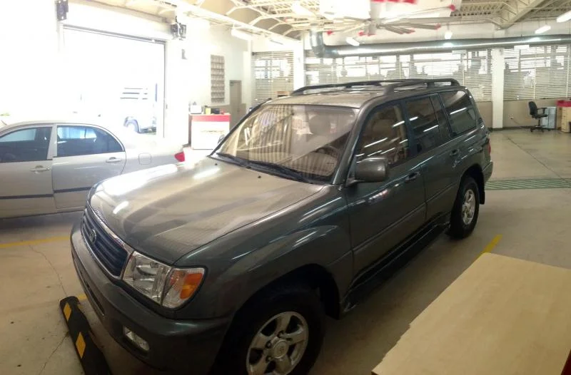

https://forum.ih8mud.com/attachment.php?attachmentid=759905&stc=1&d=1368837442
That's the one I bought.
