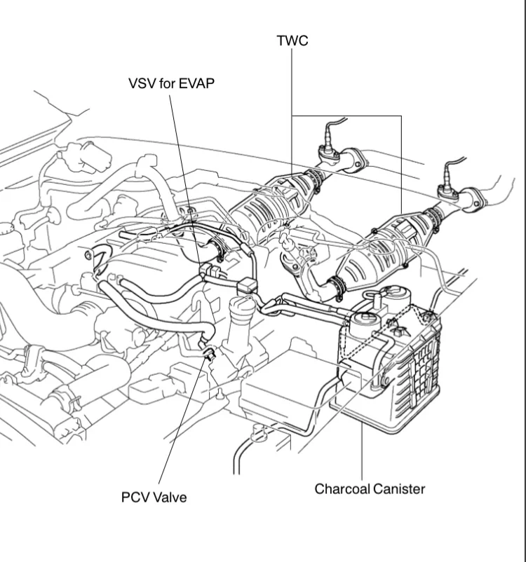

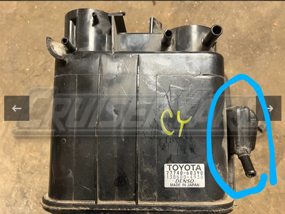

It's a 2000 so it has the canister under the hood. I'm looking for where the hard line connected to the port circled in blue goes to. Mine got disconnected and I can't figure out where it goes I have the pic from the manual but it doesn't show where it terminates. Thanks.
I don't have one here today to confirm. But IIRC it just to daylight . Just a drain, open at end.
Yup @2001LC is correct. Mine terminates into the frame via a hole below the battery. There should be a small black clip for it mounted on the frame below the fuse box. Let me know if you need a picture and I can take one later today.
