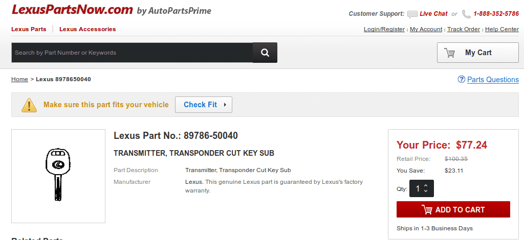

For example, in this website, LexusPartsNow.com, they have this key.
Will this work as a "master key"?
Will the remote unlock the car, and the key start-up the engine?

The key you linked to is listed as a sub key. You cannot open the glove box with it and there is no remote. It can be programmed as a master though.
Edit:
The keys I linked to are the long blade style. I am pretty sure year 2000 uses the short blades.
