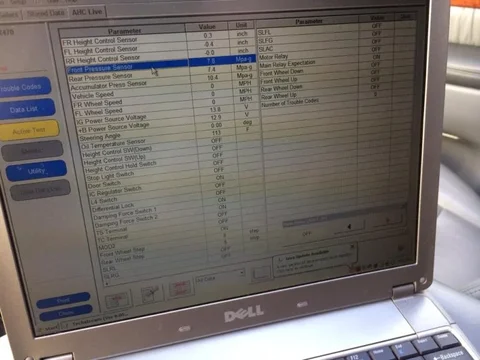

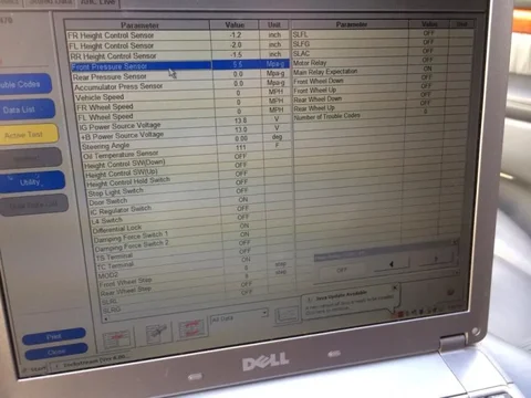

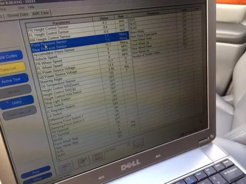

Measuring the pressure has the following "procedure".
After starting the engine and connecting the Techstream, go from Low to Normal.
The pressure will be shown at Front Pressure Sensor for the front, Rear Pressure Sensor for the rear.
Low ImageUploadedByTapatalk1394066641.259512.webp nuteral ImageUploadedByTapatalk1394066658.702370.webp high ImageUploadedByTapatalk1394066668.256438.webp

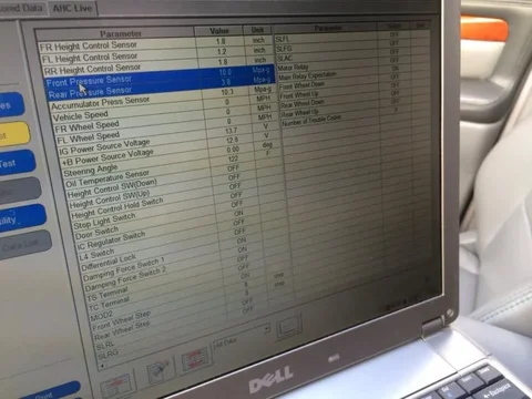

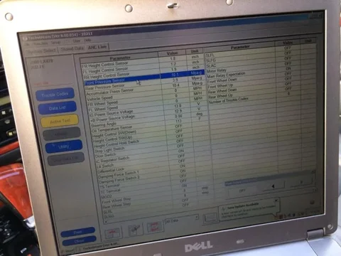

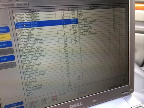

Ok so I looked at it again and it's a different reading ...
Low ImageUploadedByTapatalk1394067098.075747.webp nuteral ImageUploadedByTapatalk1394067131.420732.webp

Your front height sensors are close to their tolerances if you are on level ground but I wouldn't be concerned. Your front pressures are high and need to come down about 0.8Mpa and your rear pressure is pretty high and needs to come down too, but adjust the front first as that often lowers the rear a bit then see if packers or new coils are needed, Height accumulator pressure is normal. I wouldn't worry too much about the reservoir being above max, there is plenty of volume in the tank so it's not going to overflow or pressure lock, just makes it a bit more difficult to get an accurate assessment on the number of grads. If you won't sleep at night worrying about the high level you can suck some out with a turkey baster or bleed a cup off from any of the bleed points. I wouldn't bother. Only the low to neutral height pressure readings matter wrt neutral pressures.
