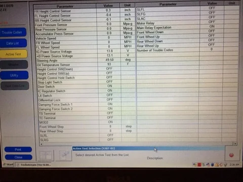

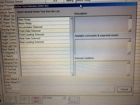

Ok I really don't know how to use this thing but I took a pic of the AHC parameters do they look good or bad? What should I be looking for? ImageUploadedByTapatalk1394016776.792278.webpImageUploadedByTapatalk1394016784.837841.webp

Ok I really don't know how to use this thing but I took a pic of the AHC parameters do they look good or bad? What should I be looking for? View attachment 871799View attachment 871800

You haven't actually read your pressures yet, attached is the procedure out of the FSM. Note there is a typo for front pressure; you want to target 6.9Mpa and not 6.5 as is first printed, and for the rear you ideally want to fall around 6.2Mpa within the 5.6 to 6.7 range so trim packers or new coils may be the answer there. Height acc usually comes in around 10.5Mpa, nothing to adjust for this one. Your FR/FL height sensors suggest you may not be on level ground, if you are on perfectly level ground you may need to tweak the sensor adjusters at some time. But one thing at a time, so get your front pressures read and TBs adjusted accordingly.

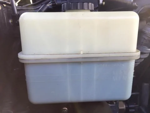

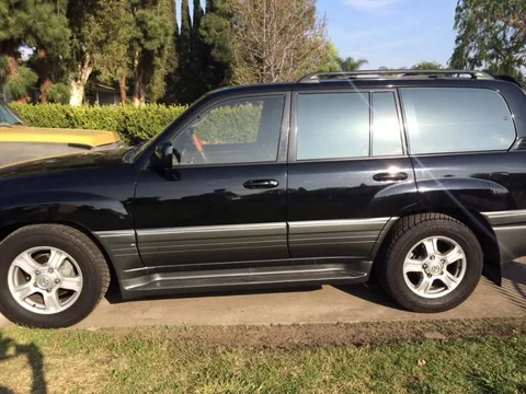

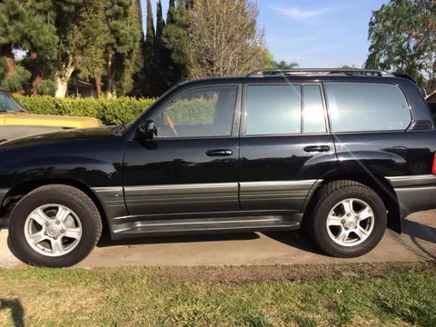

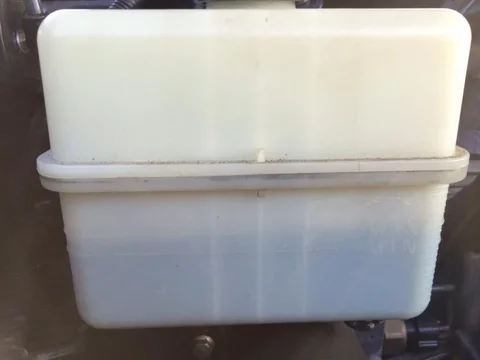

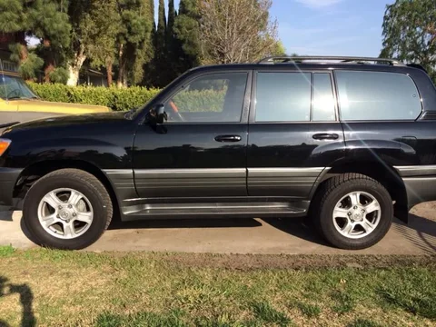

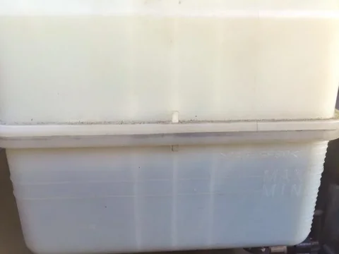

Ok I did the globe testing with the fluid change and first off I think the dealer somehow slightly over filled it because at no point is it ever under max ... But with that into consideration it still moves 7 notches but I think it would be more of the lvl was not overfilled took some pics let me know what you guys think? ImageUploadedByTapatalk1394063162.692584.webp high
ImageUploadedByTapatalk1394063177.408035.webp nuteral ImageUploadedByTapatalk1394063210.647754.webp low ImageUploadedByTapatalk1394063225.633203.webp high ImageUploadedByTapatalk1394063240.671473.webp nuteral ImageUploadedByTapatalk1394063268.052639.webp low

I am taking it to a place in Huntington Beach Monday (Top Line Performance) as they were listed here as recommended of knowing a bit about land cruisers and such. To have them over look the suspension.
