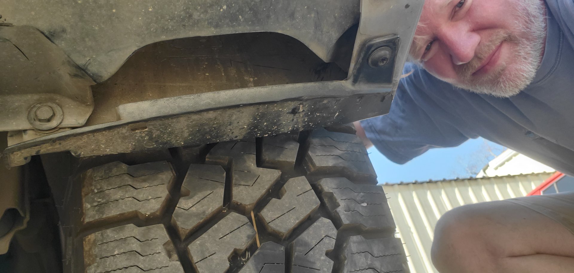

Just did a full removal and trimming/reinstall of rears. Thanks to everyone for the good pics.
Do you really even need to trim/ reinstall the front guards? Doesn't seem to have a large hole like the rears

I removed my front flaps and did nothing. Still looking for options on the rears. I know there's a small business on the 100 series page that sells rubber mud flaps similar to bigger trucks. Wish there was an option like this for the 200 series.
I used a set of generic rear flaps and cut them to shape. Made a cardboard template to locate the holes and shape, and just transferred it to the flap material. Cuts with scissors, cost $12 or something like that.
Followed others lead and trimmed the stock mud flaps. I use a small cut off wheel on a air compressor and it turned pretty good
