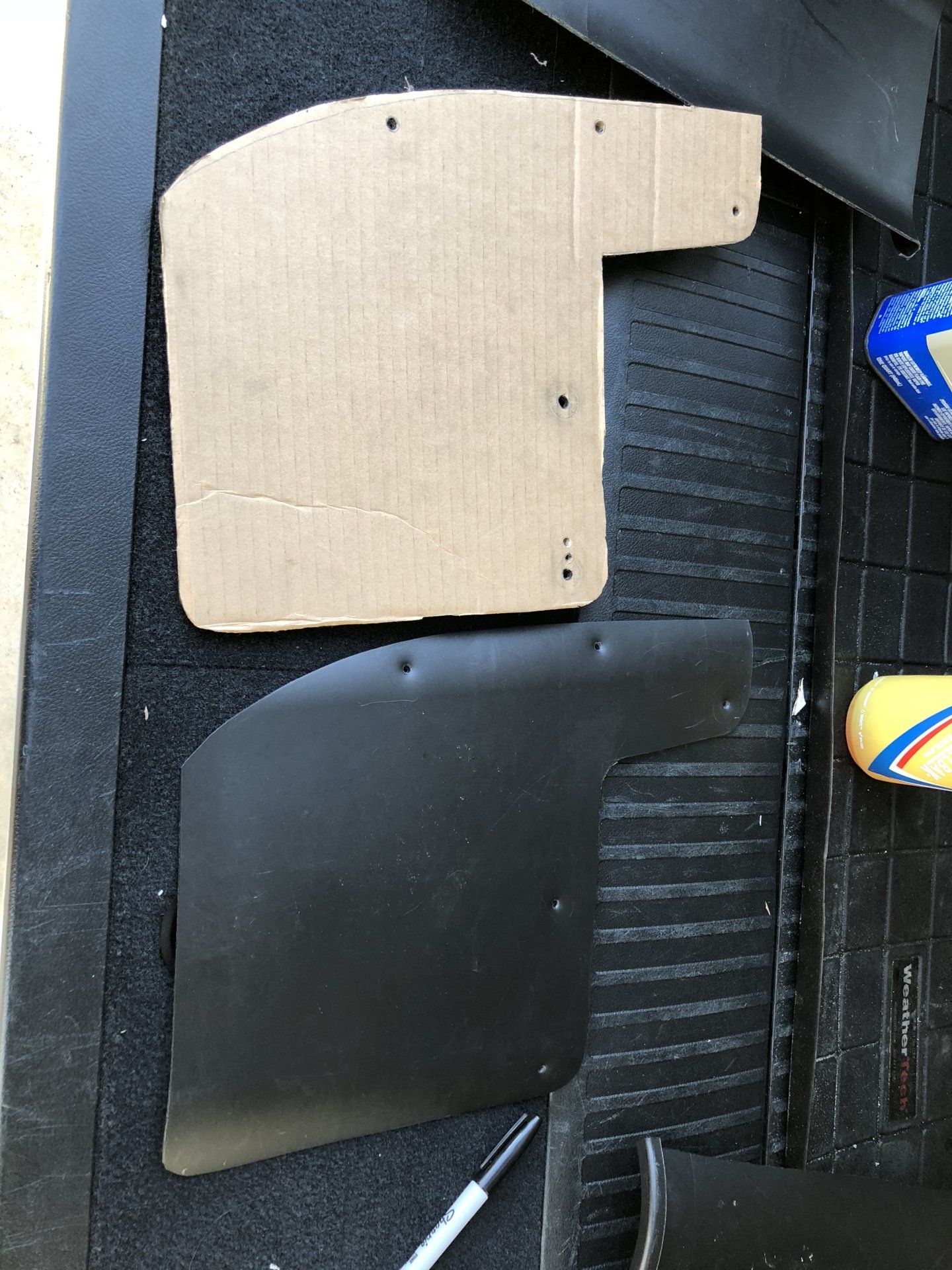

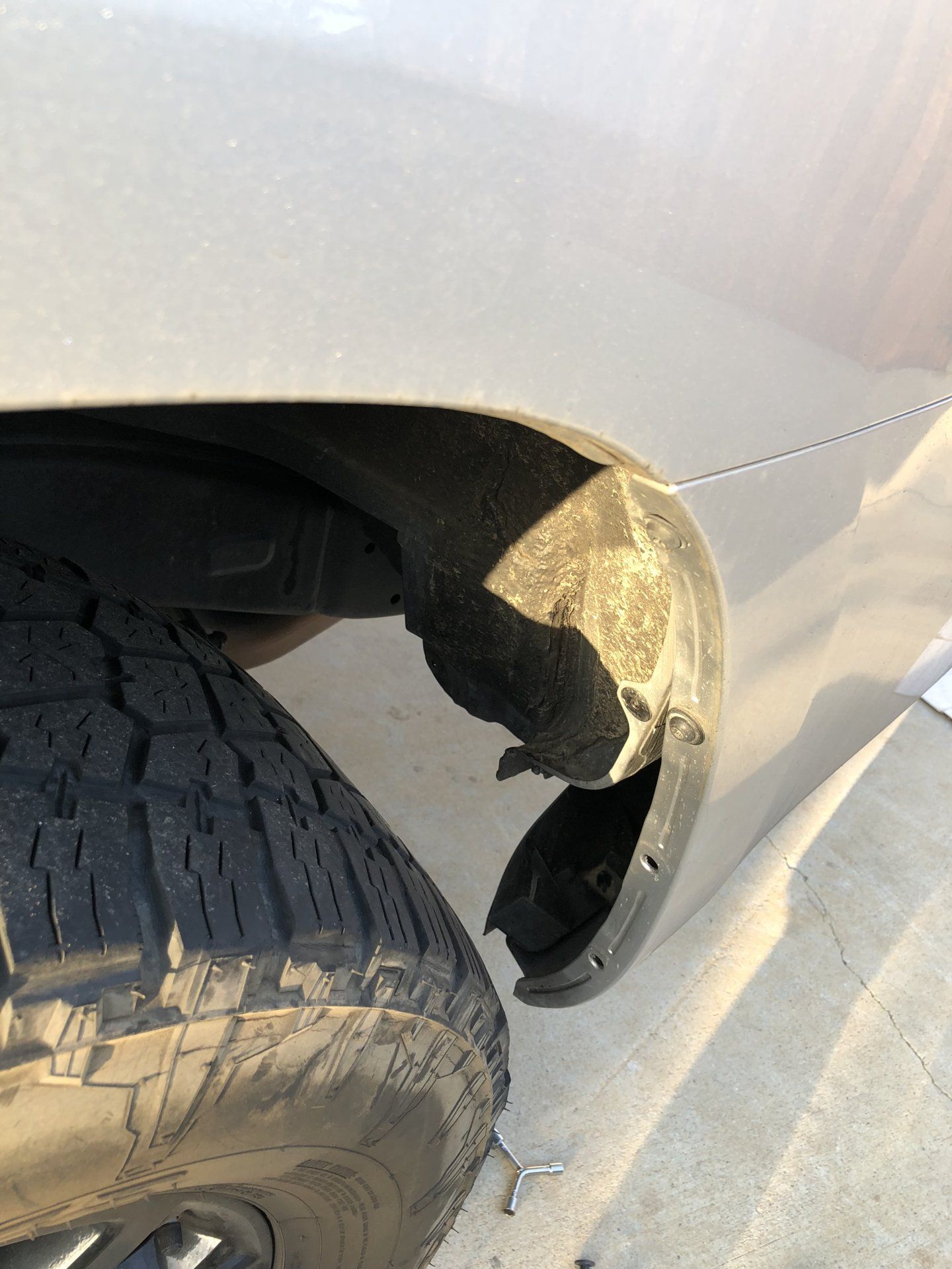

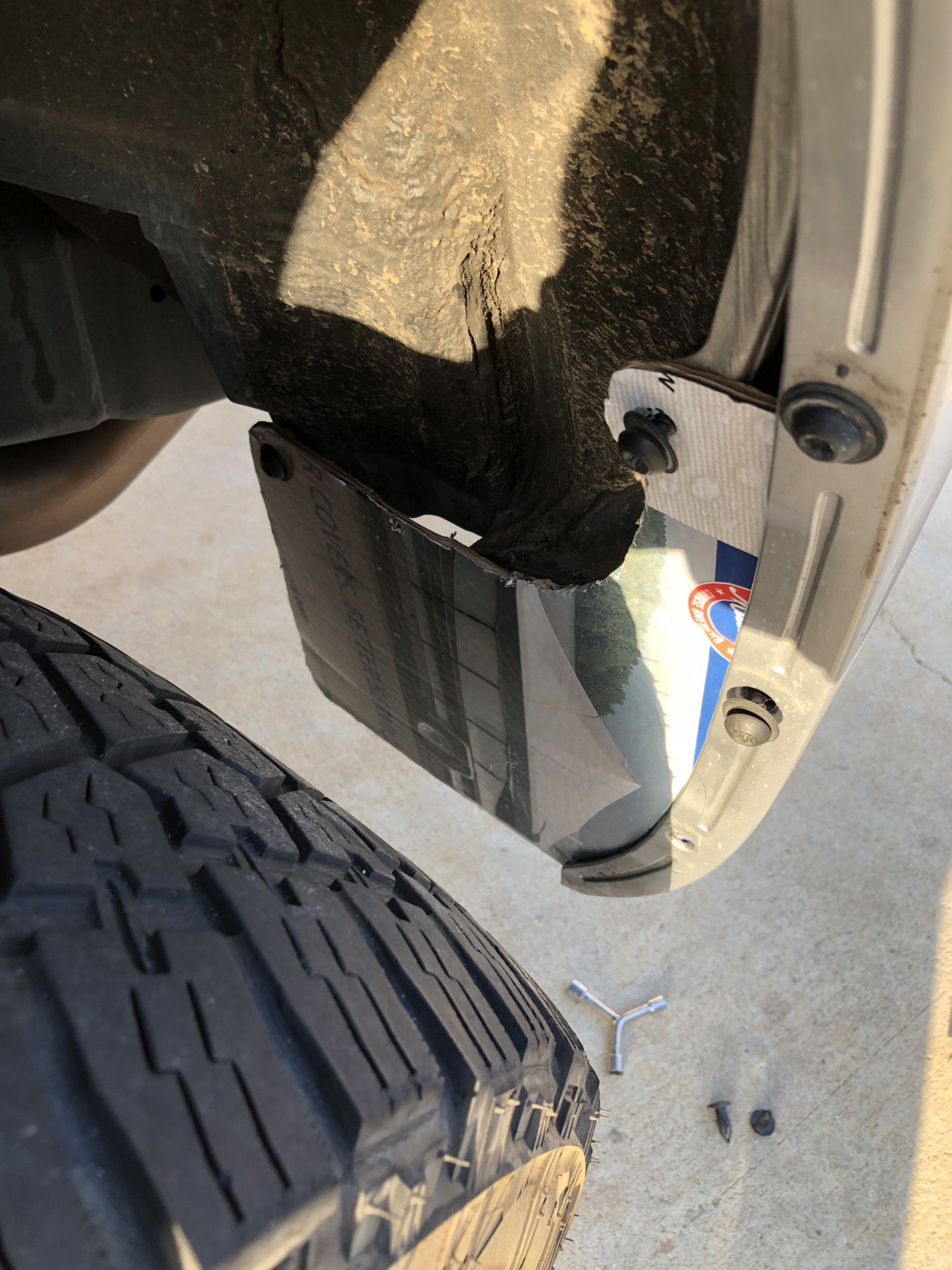

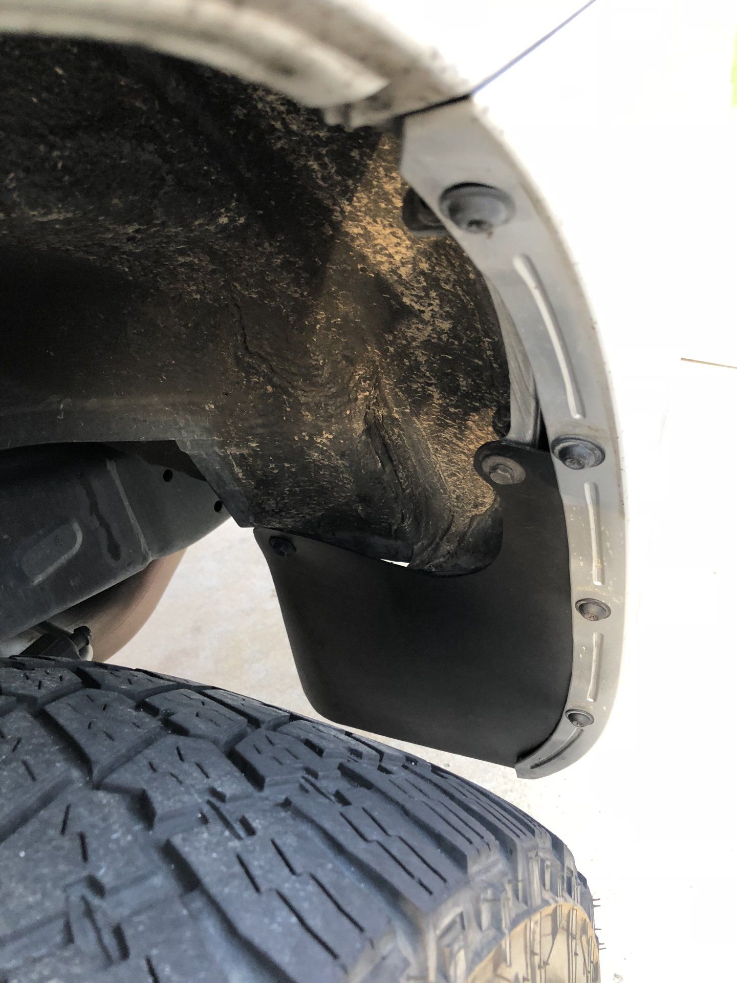

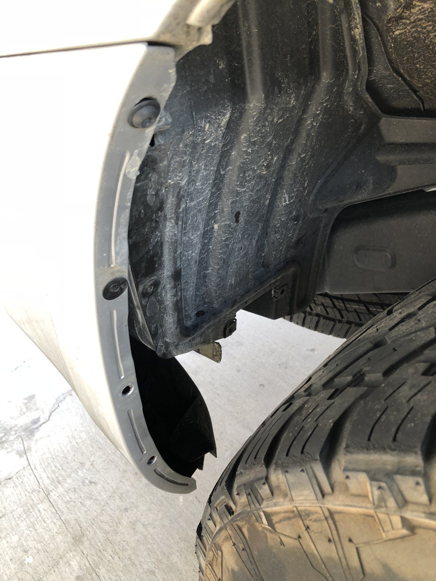

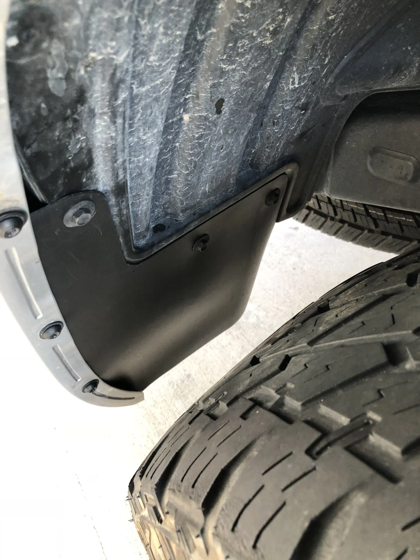

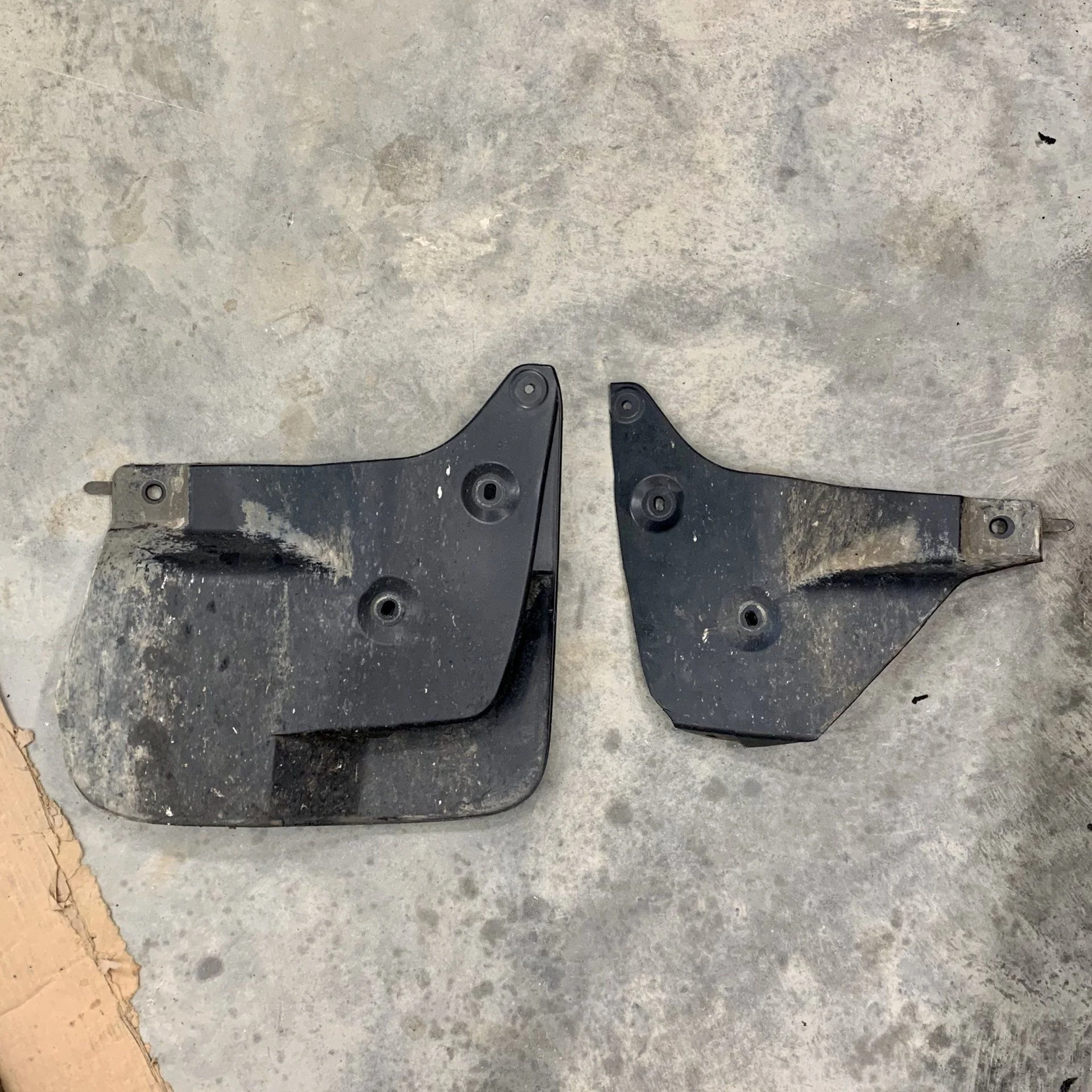

So a while ago I removed the rear mud flaps on my cruiser.
Love the stout look from the rear without but hate the holes it left in my wheel wells.

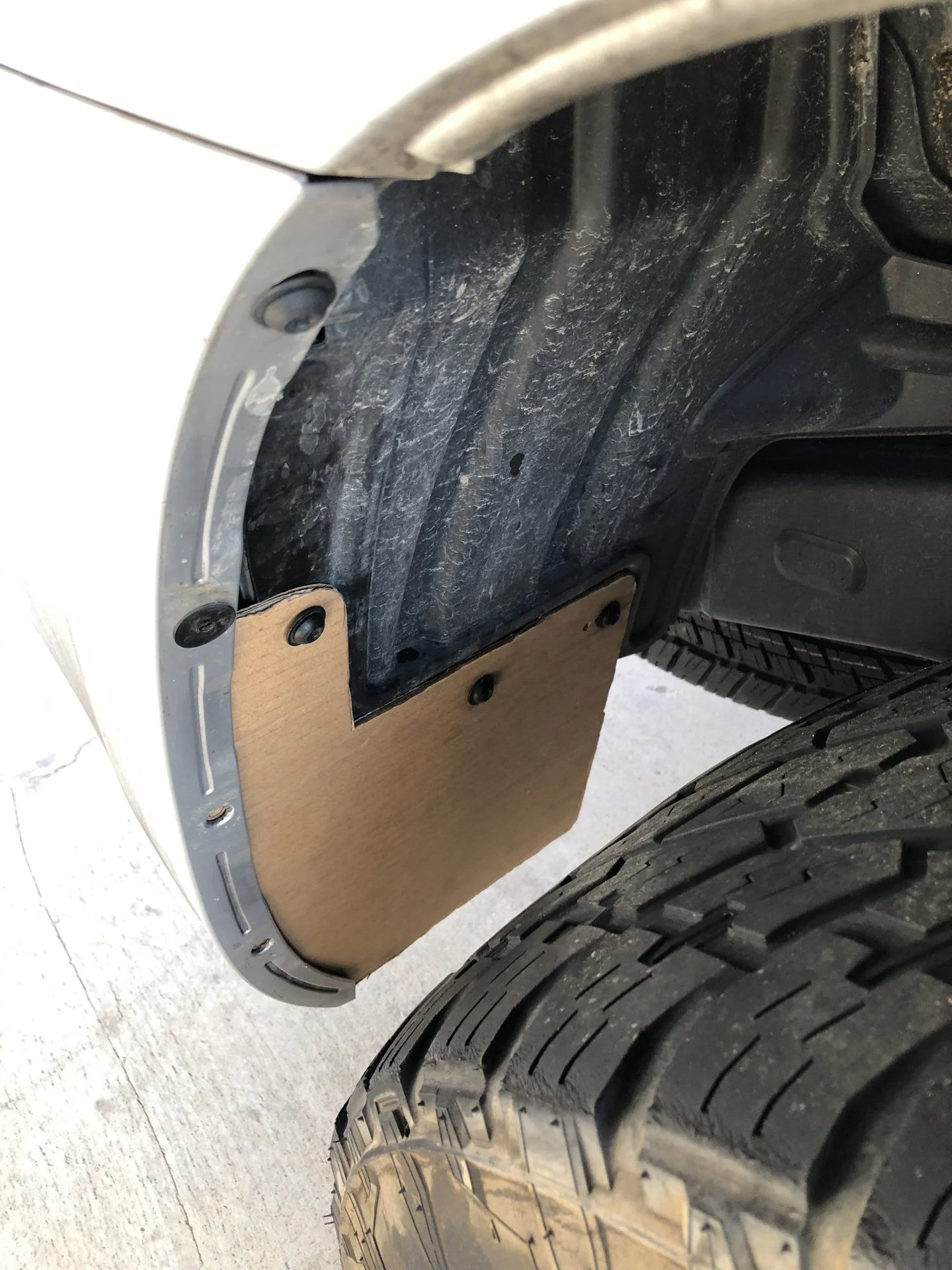

Got inspiration from a forum member that did the same on his 100 and fab’ed some plates to fill the holes.
But wanted to use black plastic for mine.

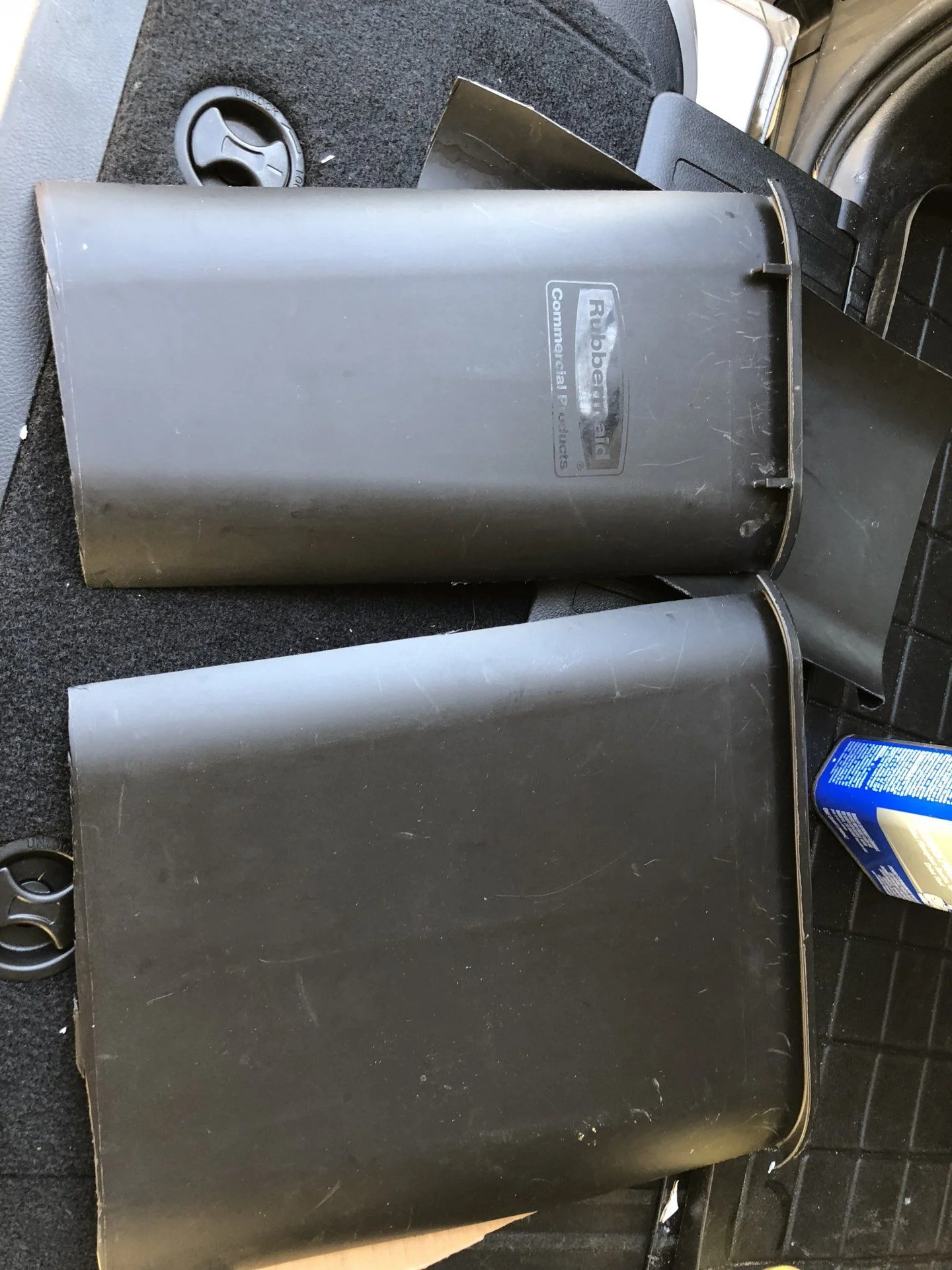

i was in the same dilemma. i think im going to have to copy your idea, didnt think about using plastic trash cans. thank you for the inspiration.
Thanks Guys.

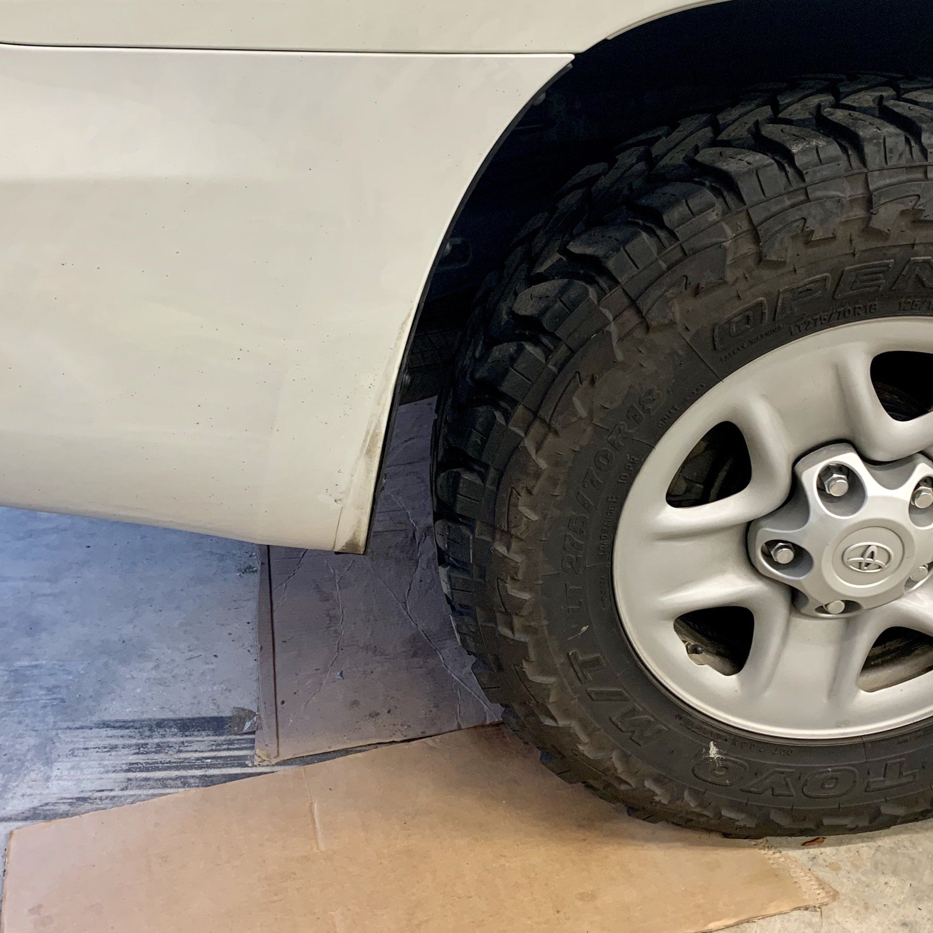

The trash can was an afterthought when i had difficulty trying to find black sheet plastic.
After looking at several places and not finding what i wanted, started to poke around the garage and the can ended up being perfect.

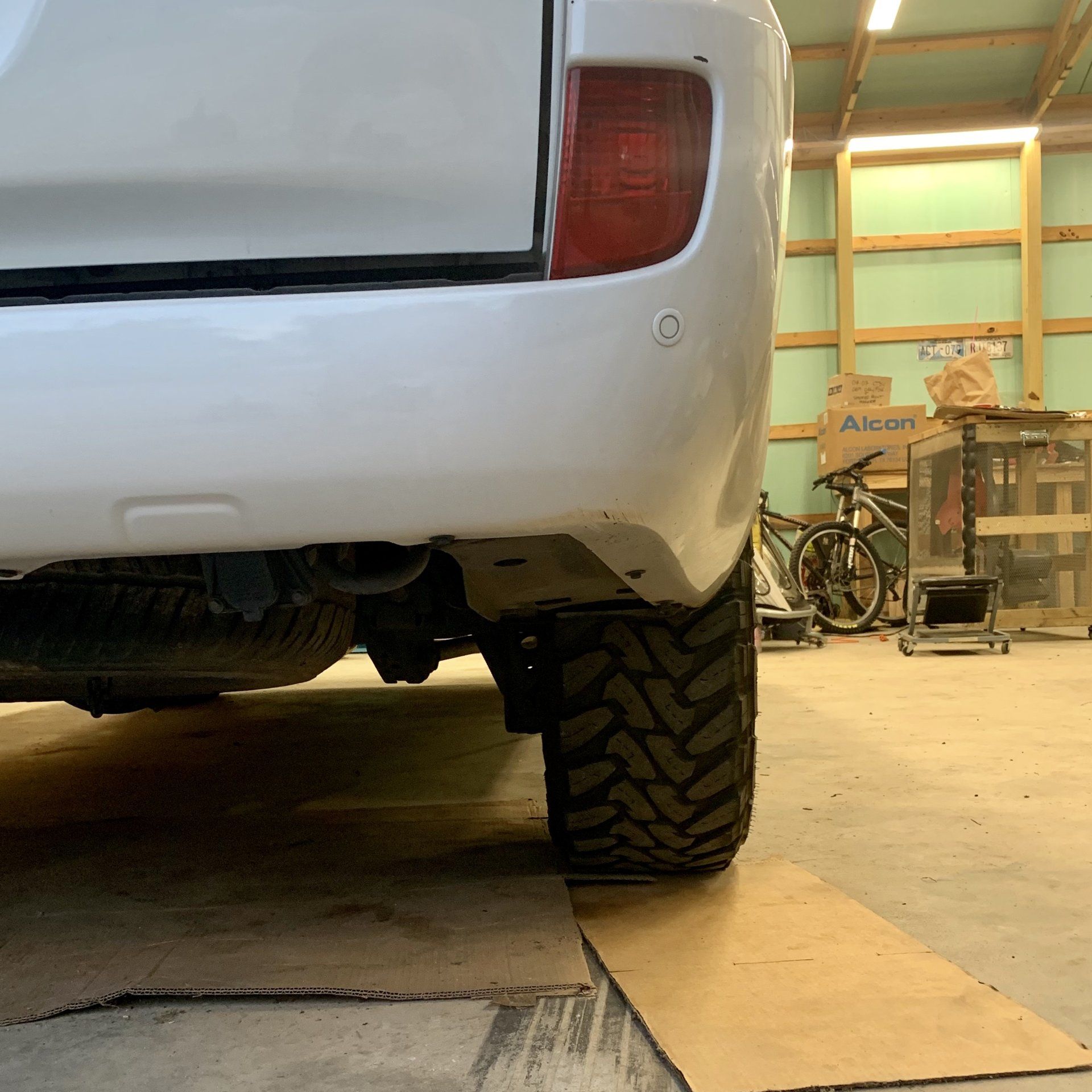

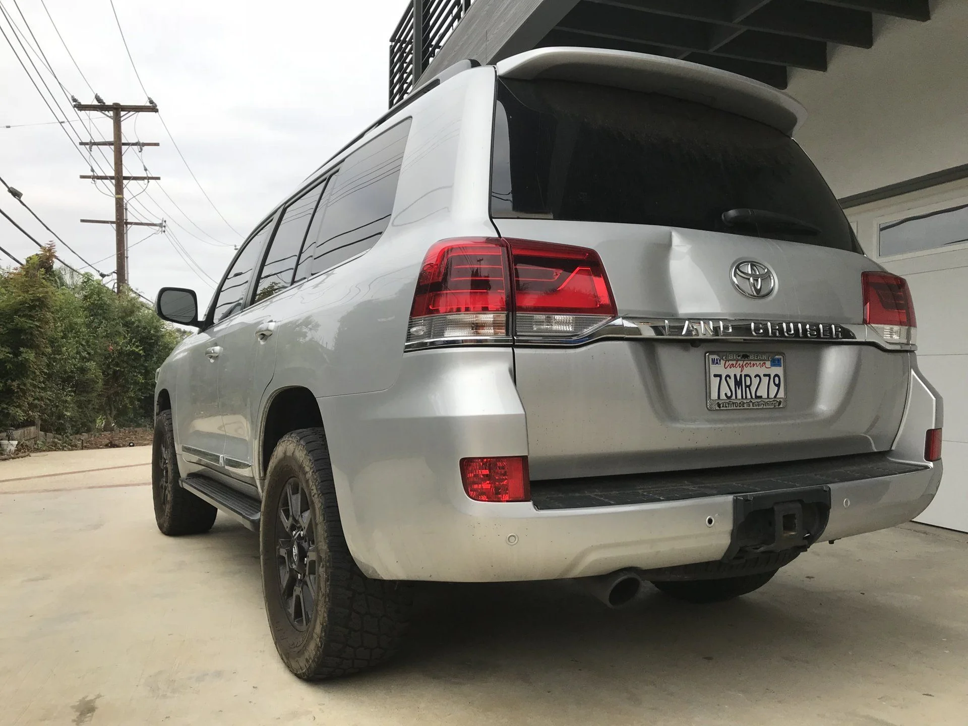

Shot from behind:
Is that a dent in your back hatch? Or a trick of light?
Nice going on the flaps. Great idea.
Yeah its a dent alright.
Last year while my son was learning to drive, he backed into a tree.
My fault as much as his cause I wasn’t paying attention & he wasn’t looking behind.....DOH!
Plan to replace the bumper with an aluminum dissident and get a new liftgate shell from toyota.
Seen em for around $800 new.
Unless someone out there wants to sell me their liftgate shell . . .

Even better than cutting up generic mudflaps. Sweet.
Looks realllllly good. I hate those enormous flaps, went to take them off when I first got the truck, but realized they were pretty intregal to the structure and weather protection in that area. Looks like that will be my next project.
Thanks Guys.

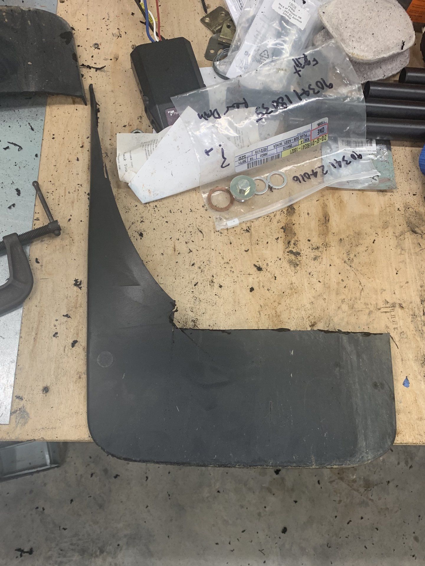

@PaulC - unfortunately I dont have the template anymore but it was very easy as I only used one for both sides as the exterior curves are the same and only diff is a couple of bolt holes and the interior profile.
Good luck!
Great idea for 'upcycling' -- I have a couple of kitchen trash cans where the automagic lids broke, so they're currently just storing pool noodles, shovels, and random wood.
