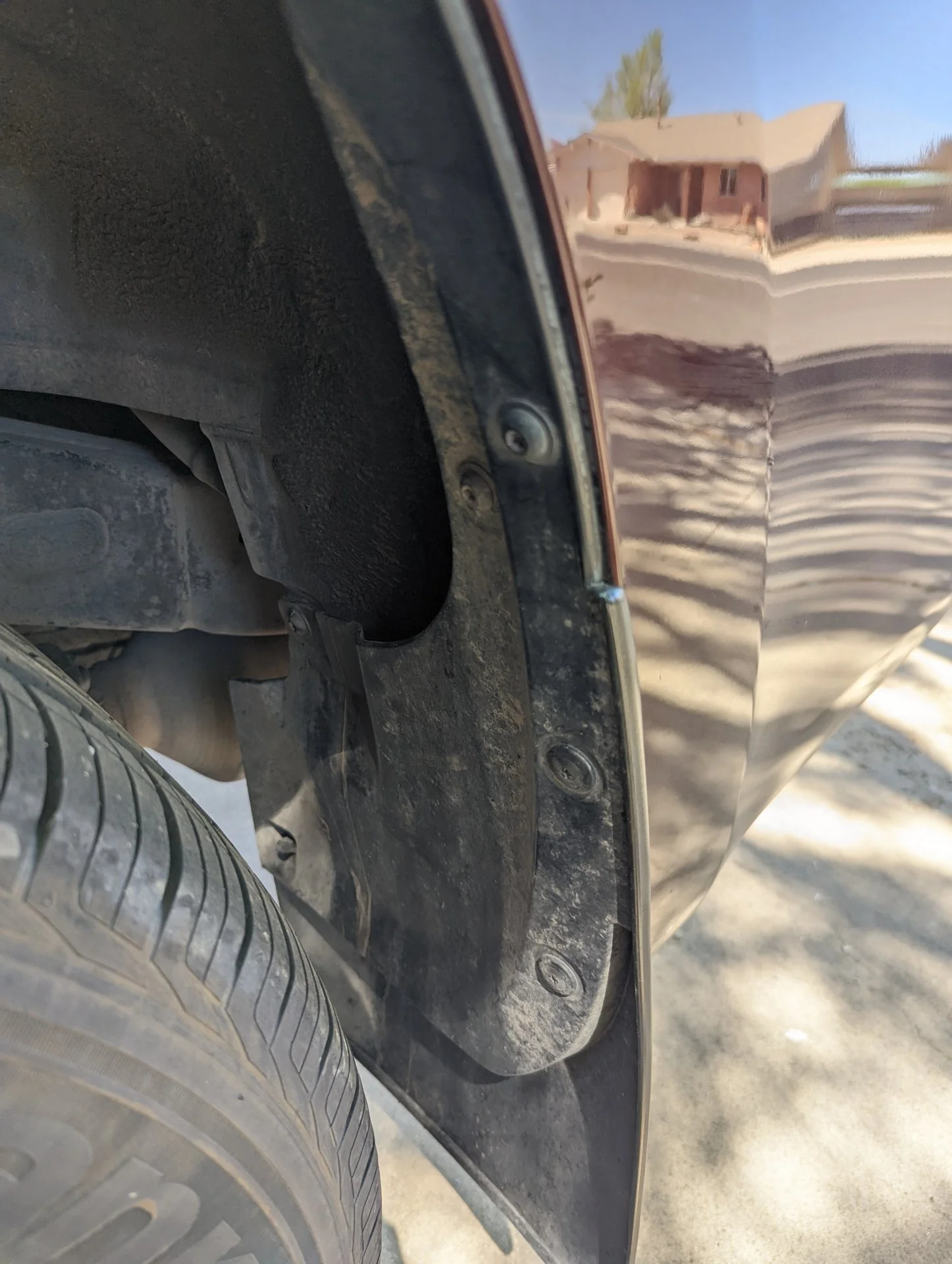

I suspect the front fender, where front flaps would mount, will be the same between all years of LX/LC. If anyone knows differently, please let me know.

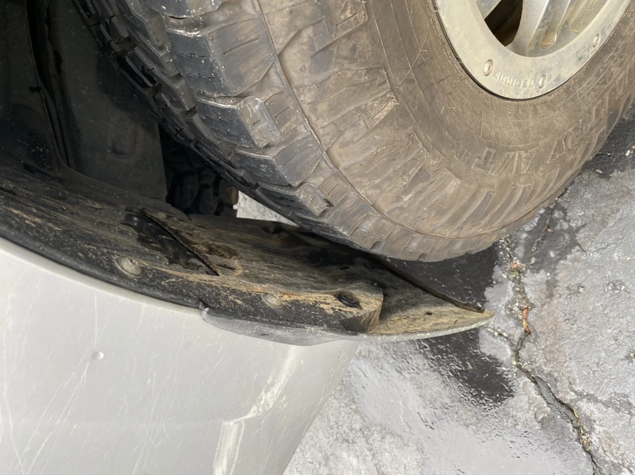

The rear is where things usually get complicated.
I need some help verifying the rear mounting bolts are the same between the body refreshes and the LX/LC.
I could use some shots of how that area looks with the stock bumper and the various aftermarket bumpers. That will help me get started on brainstorming mounting techniques.
This is the area I'm looking at on the rear of my 100 (wife has the 200 right now)

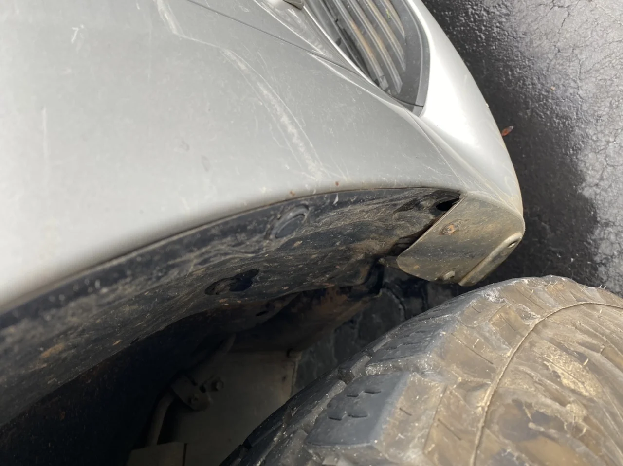

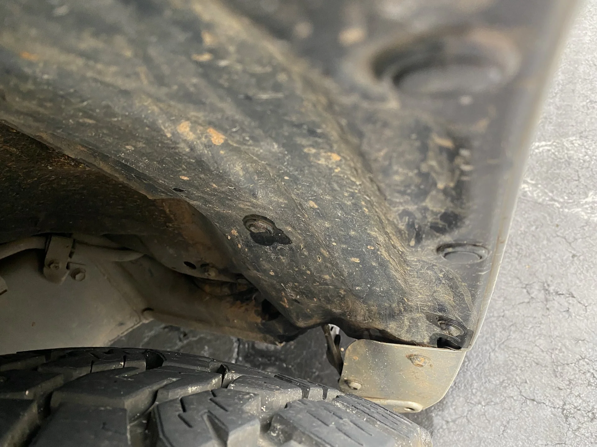

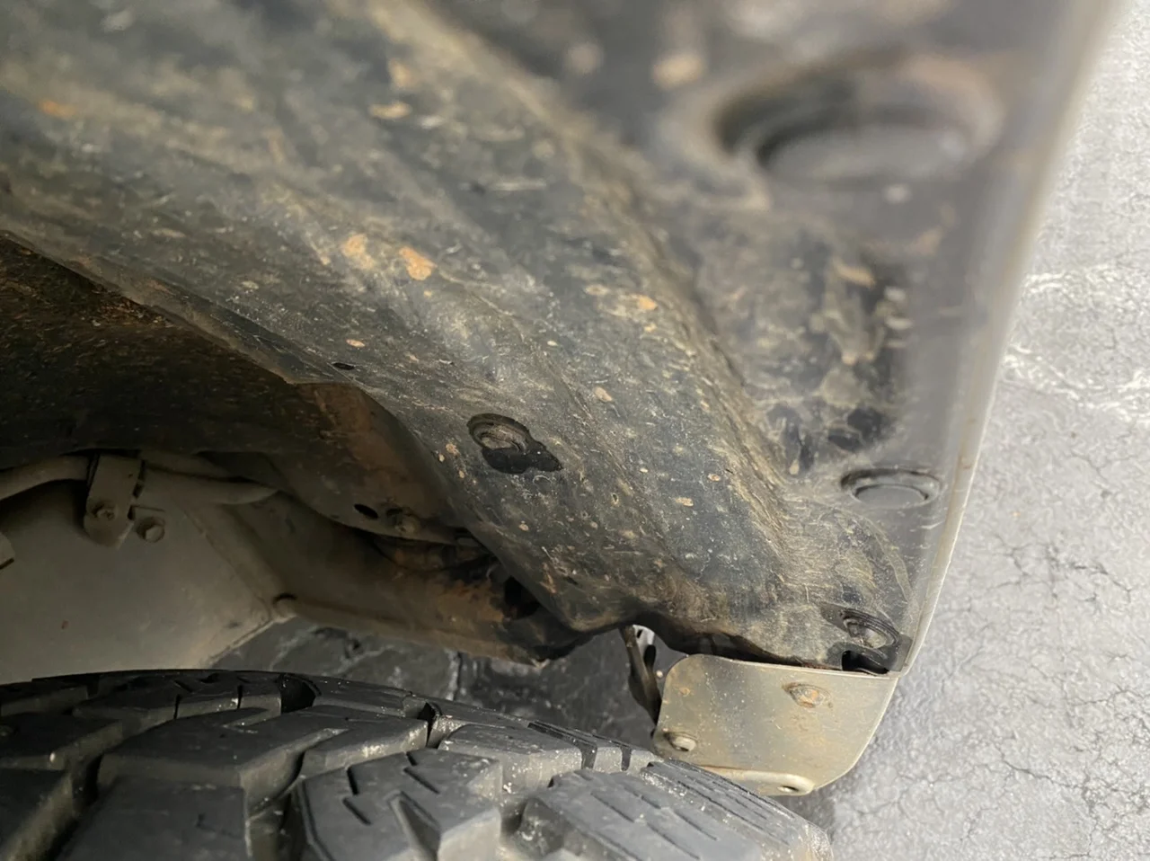

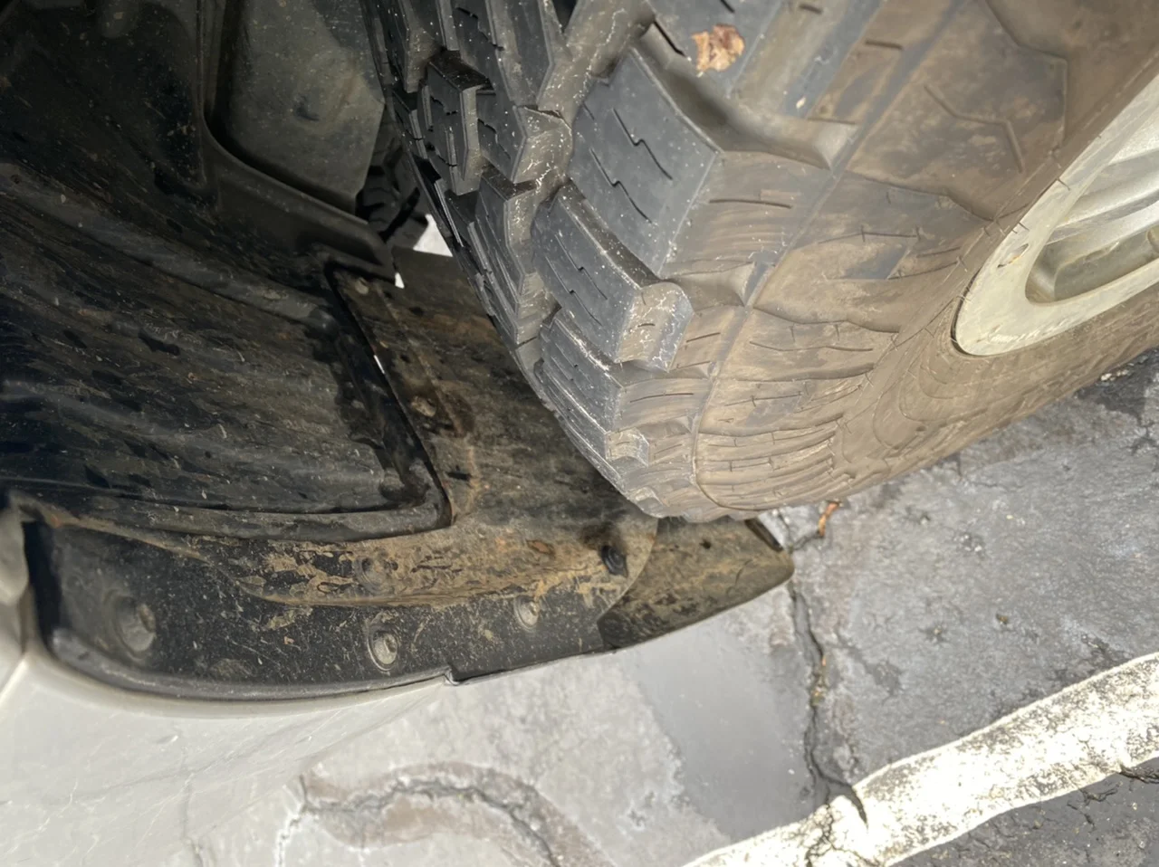

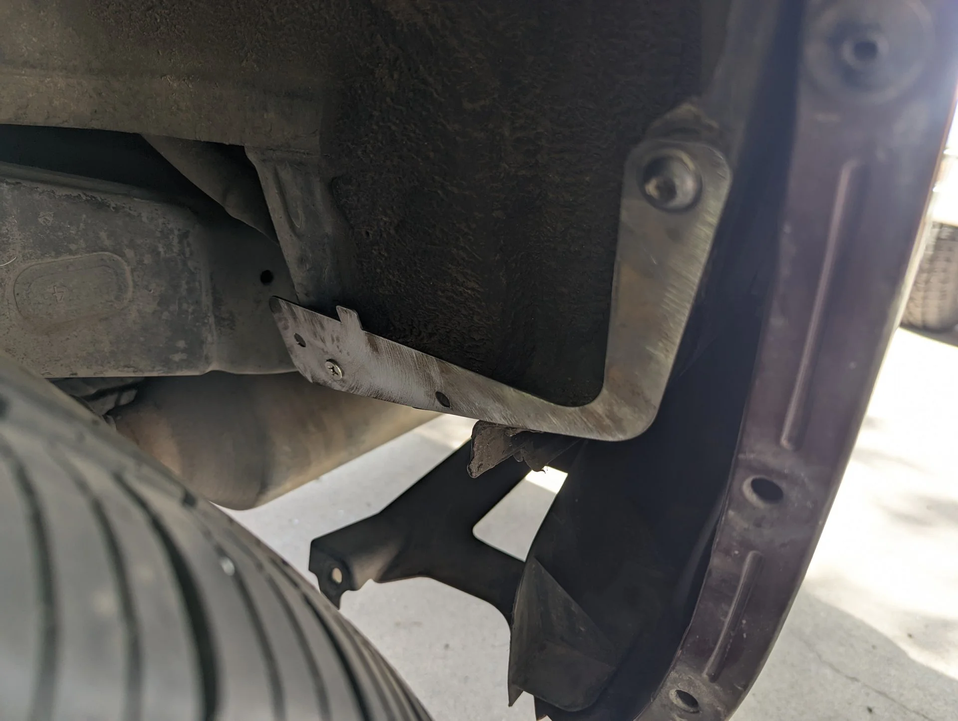

Not sure how interested I would be either. But here’s some shots of a 2010 LX. Stock in back and mudflaps removed in front.
Not sure how pervasive this problem is on the 100...but on the 200 if you go with tires bigger than 33s we all had to do some sort of modification to the front mud flap areas (in my case, muflap is removed and the liner is molded back a little further with heat. Others go as far as to bend some of the metal behind the liner back and then mold the liner even further back. If you product can't work with that, it will rule out a decent number of 200 series owners.

Thanks for the photos! Looks the same as our 17 LC.
The 100 has similar issues and the flaps help me clear 35"s as they hold all that plastic back further from the wheel well. I only have stock tires on my 200, so I may have to put my old 34"s on it and see how it clears.

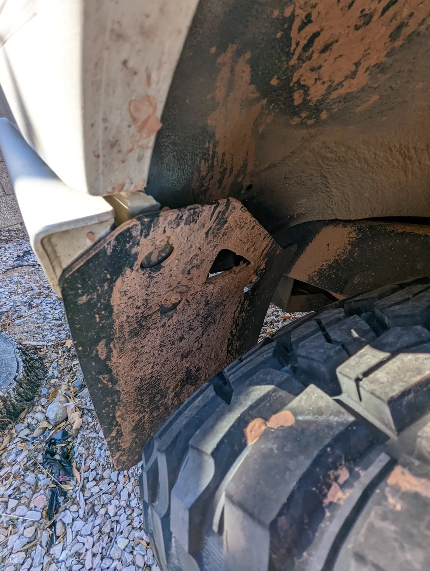

Rear bracket prototype is done. This should (hopefully) work with both slee and dissent.
Doesn't look like much because I'm using scrap. Final brackets will be nice clean stainless.
One cost saver will be using the factory flaps to hold on the rear bumper. They will require cutting, but shouldnt be hard. On the 100, I included a large bracket that holds the bumper, but it drives cost up significantly. I'm thinking most would be okay with cutting the stock vs paying $50+ more for a separate bracket.
