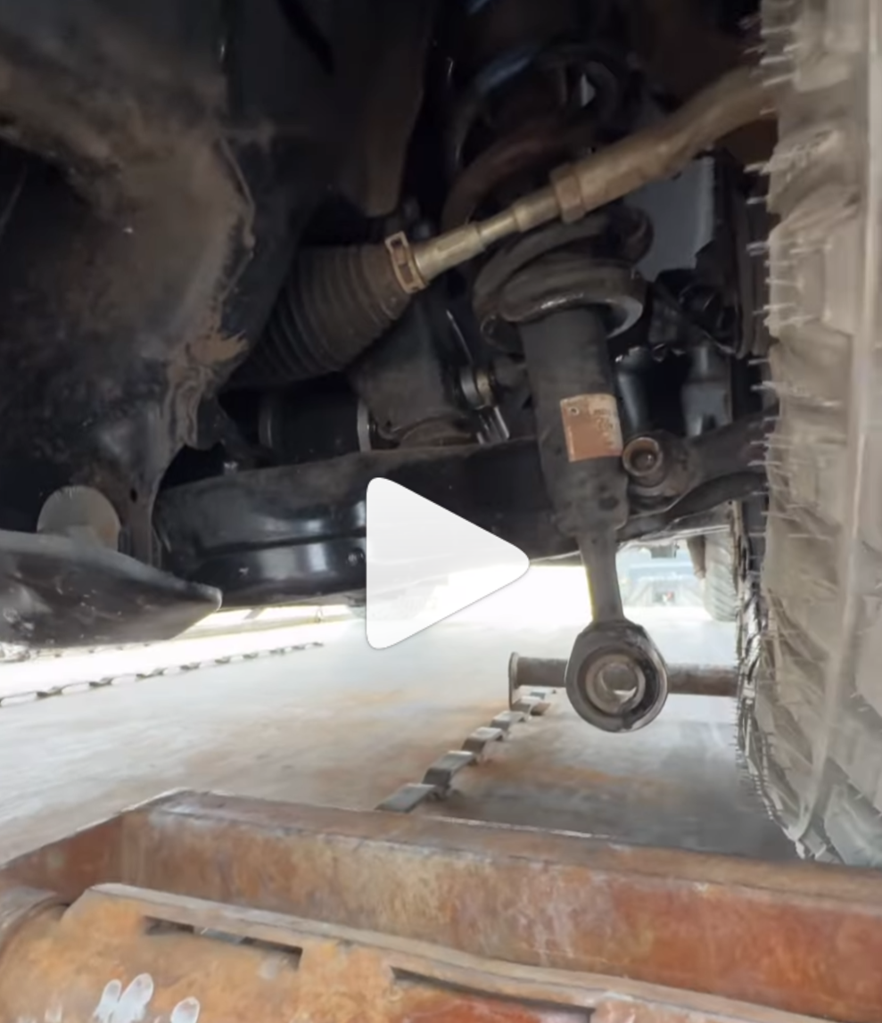

More evidence why you don't use a light duty cruiser to do HD Cruiser things.
LC250 towing campervan over Australian washboards. Stock suspension failed coming off lower link.
Definitely a weaker configuration mounting in single sheer.
