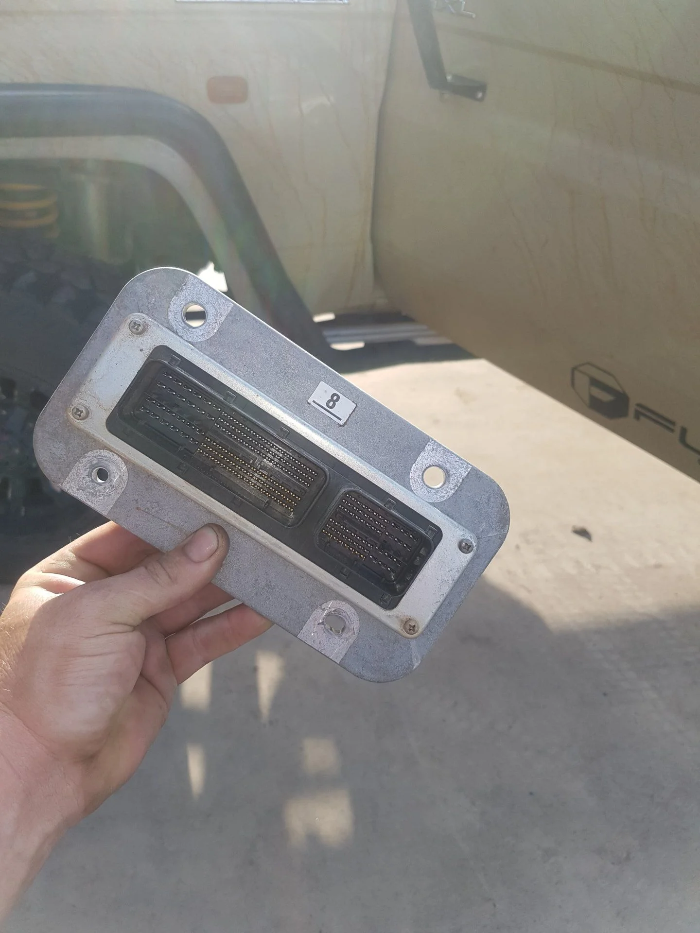

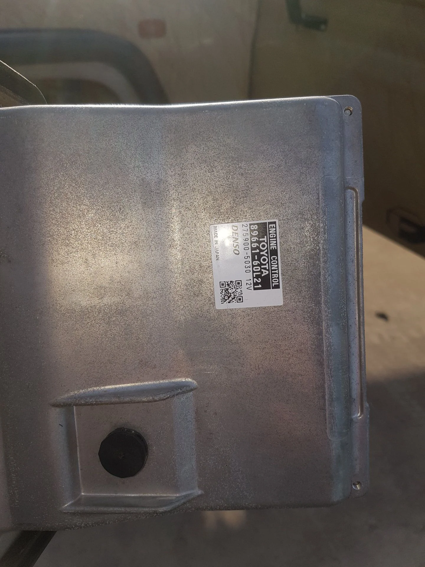

I'm gonna pull my ECU tomorrow to get some data from it ( part number etc ) I would not give up .. ( not yet at least )

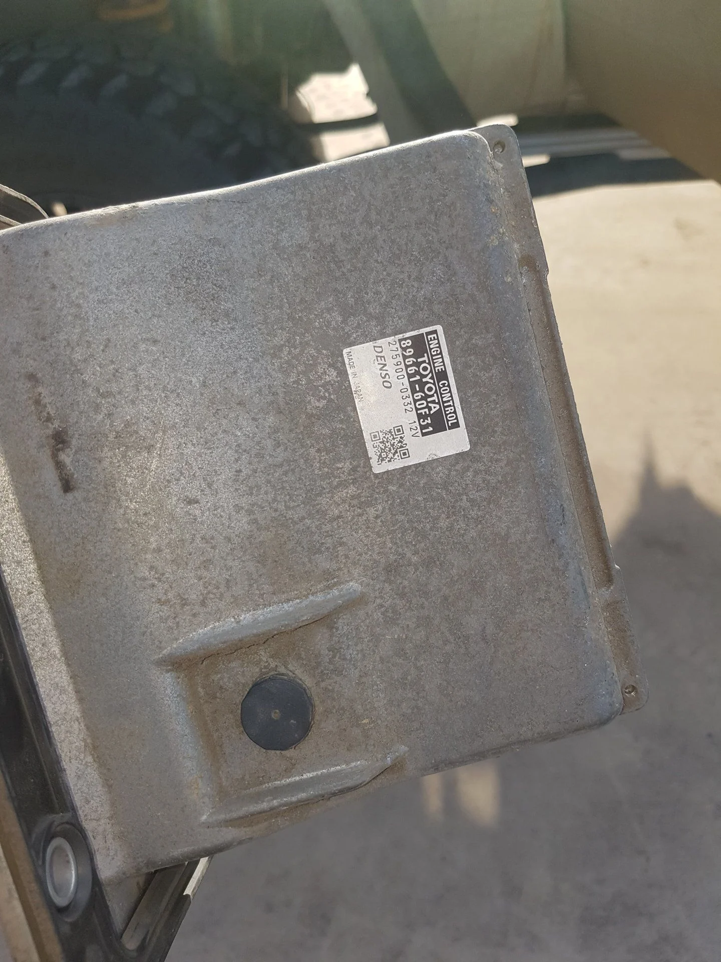

Can you use any of these
GCC-LHD-only part number.
Be careful David. You don't want to let the smoke out of that. :)
I'll source another one " compatible " ECU and will keep mine safe and sound ..
