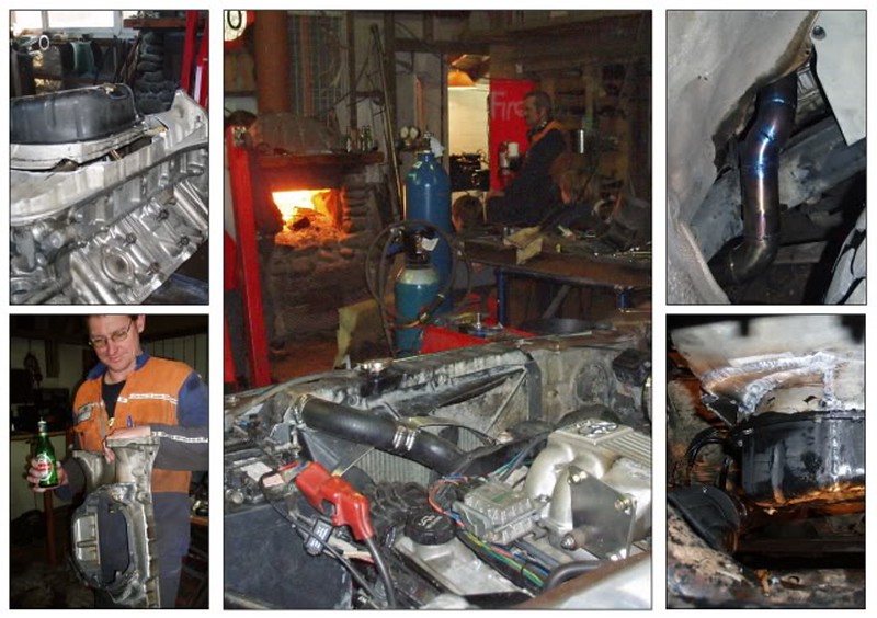

Mine was a mid sump & we had to cut & shut both the alu & steel parts to clear the diff. Rear sump may be close to clearing but I wouldn't guarantee it.
I did have a pic of the 3 different 1UZ sumps lined up together for comparison, but I can't find it, have a google, it was online somewhere.
