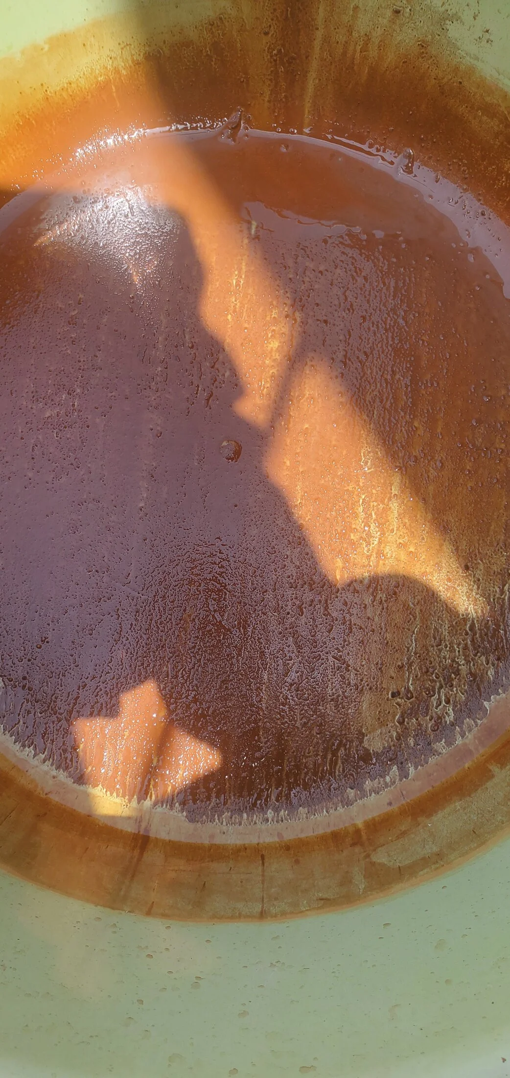

I am now thinking of flushing the engine from harmful oil deposits, as well as the channels and tank, with special products from the German Liqui Moly.
Now the question that attracts my curiosity is whether these products are harmless to the engine because it is old or worn out, and will their results not be adverse and lead to engine damage?
What is the best and safest way to flush an old or worn out engine, and what is the alternative method?
What products are suitable for engine condition?

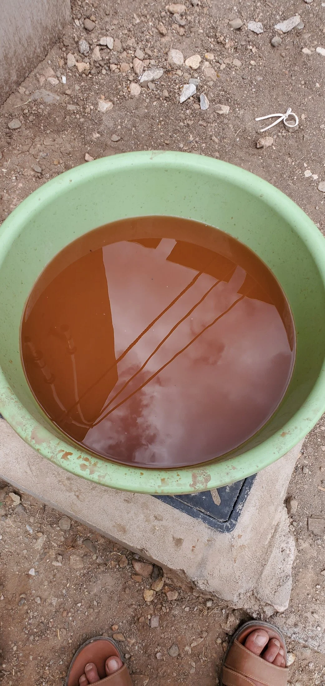

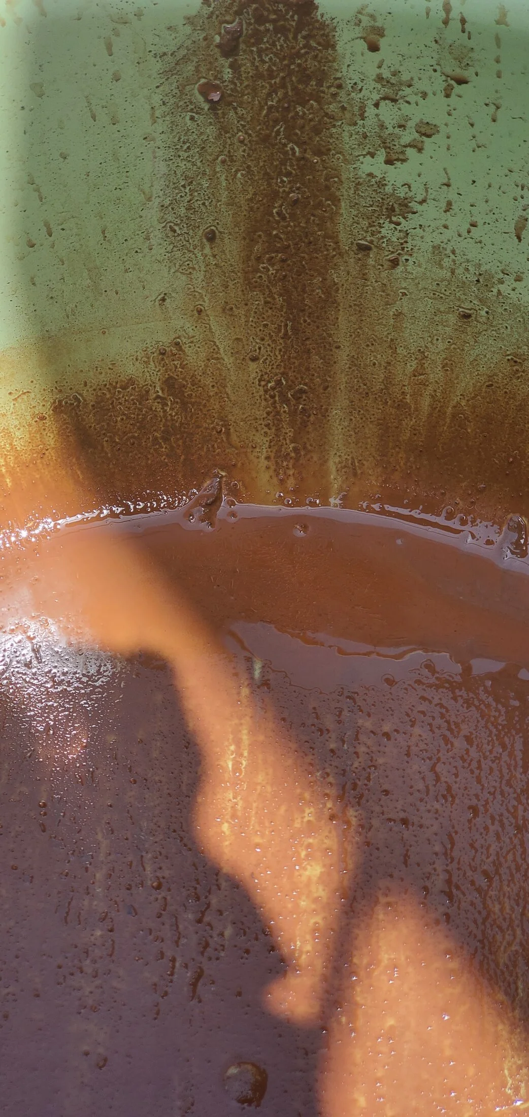

This is a case of cooling water (household water) not coolant or distilled water.

The photos suggest that there is a lot of corrosion due to the use of tap water. A flush can cause corroded parts to break, and the radiator to leak like a sieve.
A while ago, a 'Mud member did a cooling system flush with a commercial product, only to see the cooling system fall apart. For more details, the Search function is your friend.
It is possible to do a less aggressive flush. In a nutshell:
  1. Drain the coolant.
  2. Take the chance to have the radiator re-cored and repaired. Replace it if you can.
  3. Wash the coolant bottle/tank with water, detergent and a brush.
  4. Fill the cooling system with proper coolant, and then drive, say, 100 or 200 km.
  5. Replace the coolant.
You should replace the water pump as well. Keep an eye on the cooling system piping, and replace parts as leaks appear.

Yes there was a big leak from the engine block and it was fixed and a leak from the heating pipes and dirt reached the front and rear heater sub units and a big leak from the radiator and the radiator was replaced and there is no leak so far I did the less powerful cleaning by changing the coolant three times and the dirt is still the same with distilled water .
When the cleaning process is complete I will replace the water pump.
Thank you Juan🙏🤍💐

You may need to perform one or two more flushes. Patience. Note that sometimes the dirt builds up in the coolant tank/bottle. You can filter the dirty coolant, wash the bottle, refill and repeat until the coolant in the bottle is clean. It is not exactly by the book but it helps.
