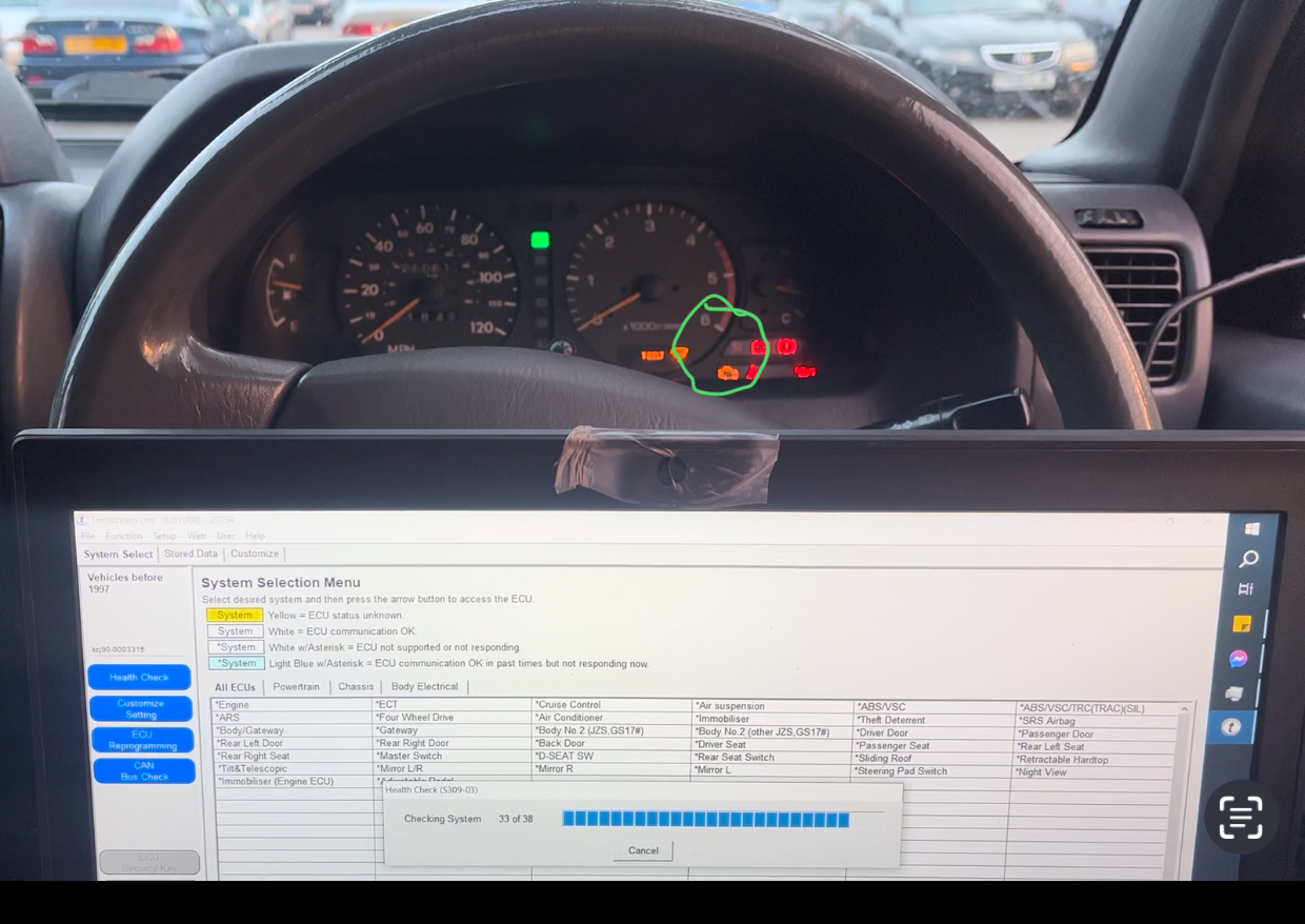

Just installed techstream v18 with a tactrix openport 2.0
Booted it up with the obd2 to m-obd DLC1 adapter I bought off ebay
Launched techstream Japan and scanned the car with correct make and model. Super weird as I’m scanning the car the airbag light starts flashing as if the reader is “pulling data” from the diagnostic connector in the engine bay. Techstream comes up with nothing but it’s clear that signals are being received from the car, but nothing is coming back to the reader. Did the connector self test and it’s turning up nothing. Any ideas? This is on my jdm spec 96 prado 1kzte

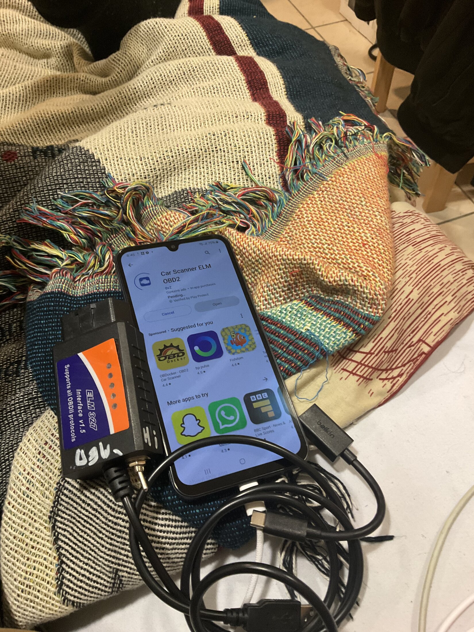

So I bit the bullet and bought a cheap android and picked me up an ELM327 from a guy locally for $10. Guy told me he used it on his ford focus which has a switch for CAN operation. Best guess HI for CAN HI and MED for CAN MED (CAN LO? Possibly). Anyways I got a usb-C adapter since it isn’t Bluetooth obviously. How should I proceed with setting this thing up with ELMscan?
Why not? You've come this far!
All my use has been with a 2000 model 1KZ-TE/ECU via OBD2 port so there might be some slight differences in communication. It sounds like you're all over it though.

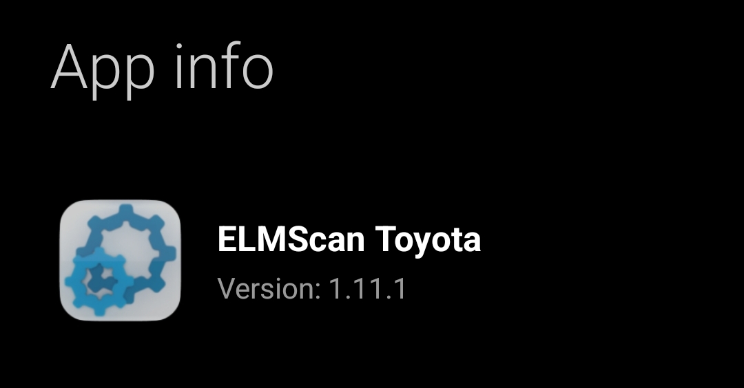

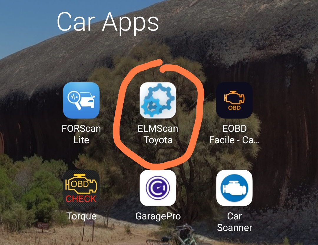

I've noticed ELMScan Toyota has now been removed from Google Play store. I think I know why but I won't announce it here in case I'm wrong. I have the APK file I can send you and you can try and install it manually if you like? I have contacted the owner of the app in the past who was helpful with a query I had so it is a legit app. I just think that due to the country he is from, Google Play might have banned all apps from that particular country for "political reasons" if you get my drift....
Copy,I’m picking up what your putting down and by all means, send it my way and I’ll figure out how to install said apk.i also downloaded torque which was also recommended
Nup, torque is rubbish compared to ELMscan. Well in my experience anyways. I bought the Pro version and it's limited to just viewing and deleting codes. Nothing else useful.

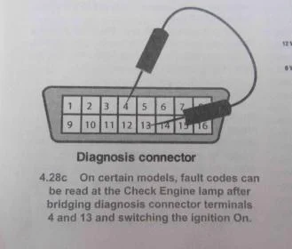

Yes. I’m wondering if the diagnosis port is perhaps broken in the engine bay? Curious what the pin out is because I could trace it to the inside of my car and run an in car diagnostic port….like obd2
Found this deep in the archives. Pic taken from the 95 and 120 series Prado Gregories workshop manual I believe.
