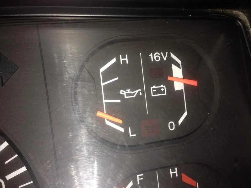

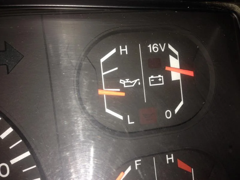

Hi all,
My 1KZ has fairly low oil pressure at idle and even at 2500RPM, is only JUST at the lower mark of the acceptable level.
I will install an external gauge and check how much I'm looking at in PSI but till then can folks tell me if these in dash gauge readings look too low ?
What pressures should it have in PSI ?
I just changed oil and filter. Oil is SAE40 at the moment. I want to run it a little and change it again to flush the engine without using and engine flush.
Milage on the engine is un known. Starts instantly, no smoke. Supposed to be very low miles
The low reading in the pic is at idle. The higher reading is at 2500 RPM

Dash pics look ok to me and the fact it starts easy cold with no smoke pretty well sums it up that you have a good engine.
Your idle and higher RPM oil pressure looks normal based on my experience.
Yup that looks like what mine does... When its hot... Bit more pressure at idle when cold....But thats to be expected...
Hmm mine is better when cold too. I wonder why the gauge has a normal operating range marked and none of us r operating in that range ?

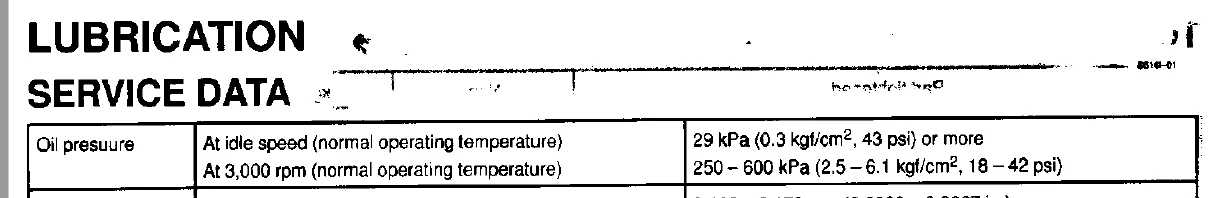

Factory spec.. from the 1KZ-TE FSM
Pretty sure there's a typo in it though.. that 43psi should say 4.3psi.
Hi, thanks for all your support.
Yes and No, its a bad print. Its suppost to be 4.3psi on idle.
