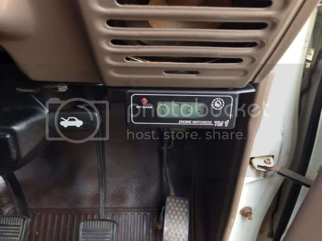

Installed this this arvo and took it for a spin, got to 93 deg and the stock gauge was just past half way. 110-120 with ac on mild head wind and about 27 deg day. It takes about 10mins or so then the temp starts climbing slowly at that speed. I am thinking about intercooling I think this will help a lot.
