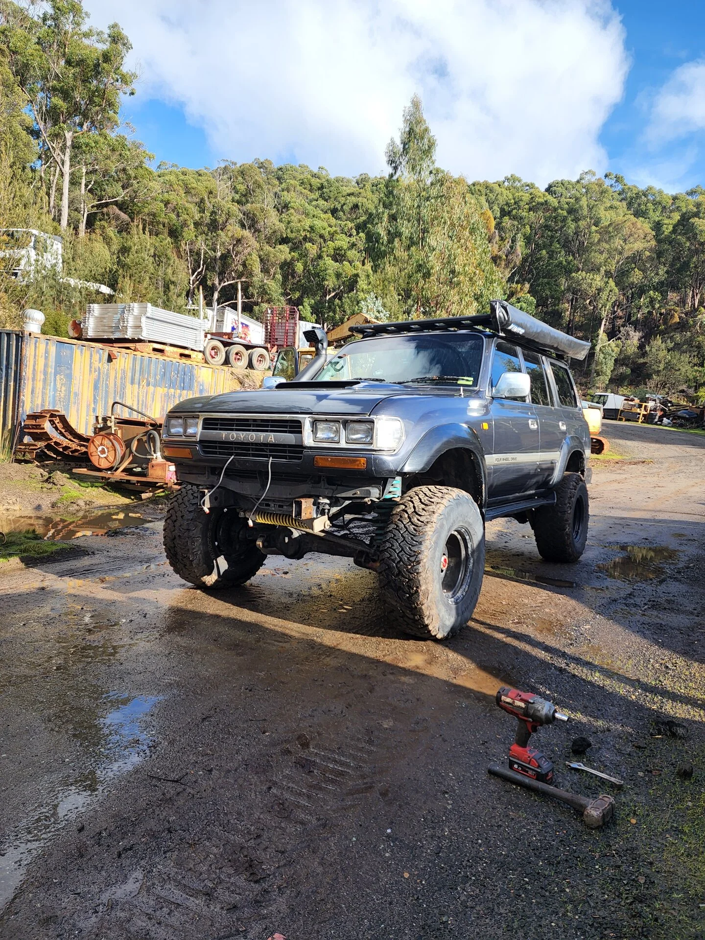

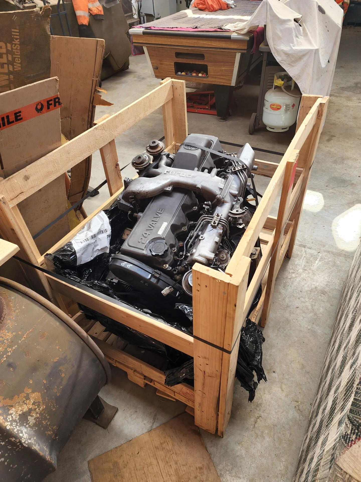

Nice, cruiser looks good and that engine looks clean. From Japan?

I bought mine off japmotorimports they're based in WA. I wouldn't recommend them, mine was abit sad internally, and had a bent crank. I see Jordan baker at only onlylandcruisers on Facebook has a couple mate. He would be worth a try or Engine City Imports in QLD might have one also.
