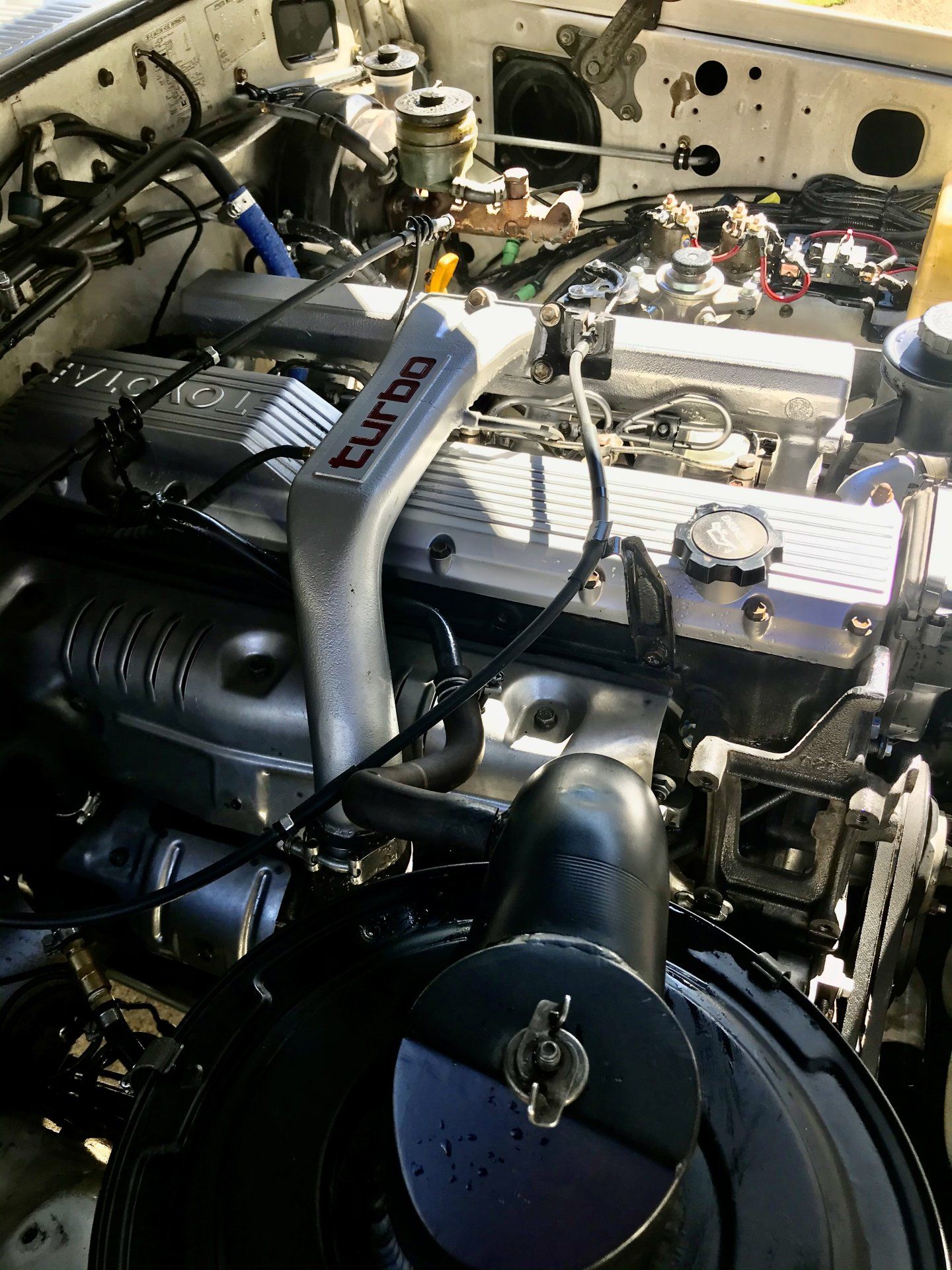

I am relatively new to diesel cruisers and ran into an issue that left me stranded on the way into work today.
The rig is an FJ62 with a 1HDT swap. I changed the fuel filter, following the FSM instructions. I installed it dry and pumped the primer for a while, it never seemed to increase in firmness. The first startup was a little rough but smoothed out within a few seconds. When I got about a mile from home it stalled and would just crank.
I tried the hand primer some more, still nothing. Pulled the filter and it was full of diesel. I pulled the fuel line going into the IP and pumped with only a slight bit of diesel coming out of hose. Should it be a hefty squirt?
Cracked open the lines to the injectors and cranked it and barely got any fuel.
The obvious would be a failed hand primer but would this cause what I described? Most everything is new/rebuilt within the past year.
Yes!
Air is sucked in and ip is fuel starved.
Try drinking through a cracked straw.
If you're stuck, bypass the filter, I like to carry a clear length of hose just in case and for troubleshooting.
Fixed. It ended up being that my fuel solenoid wire was broken. Fixed the wire and it fired right up.
