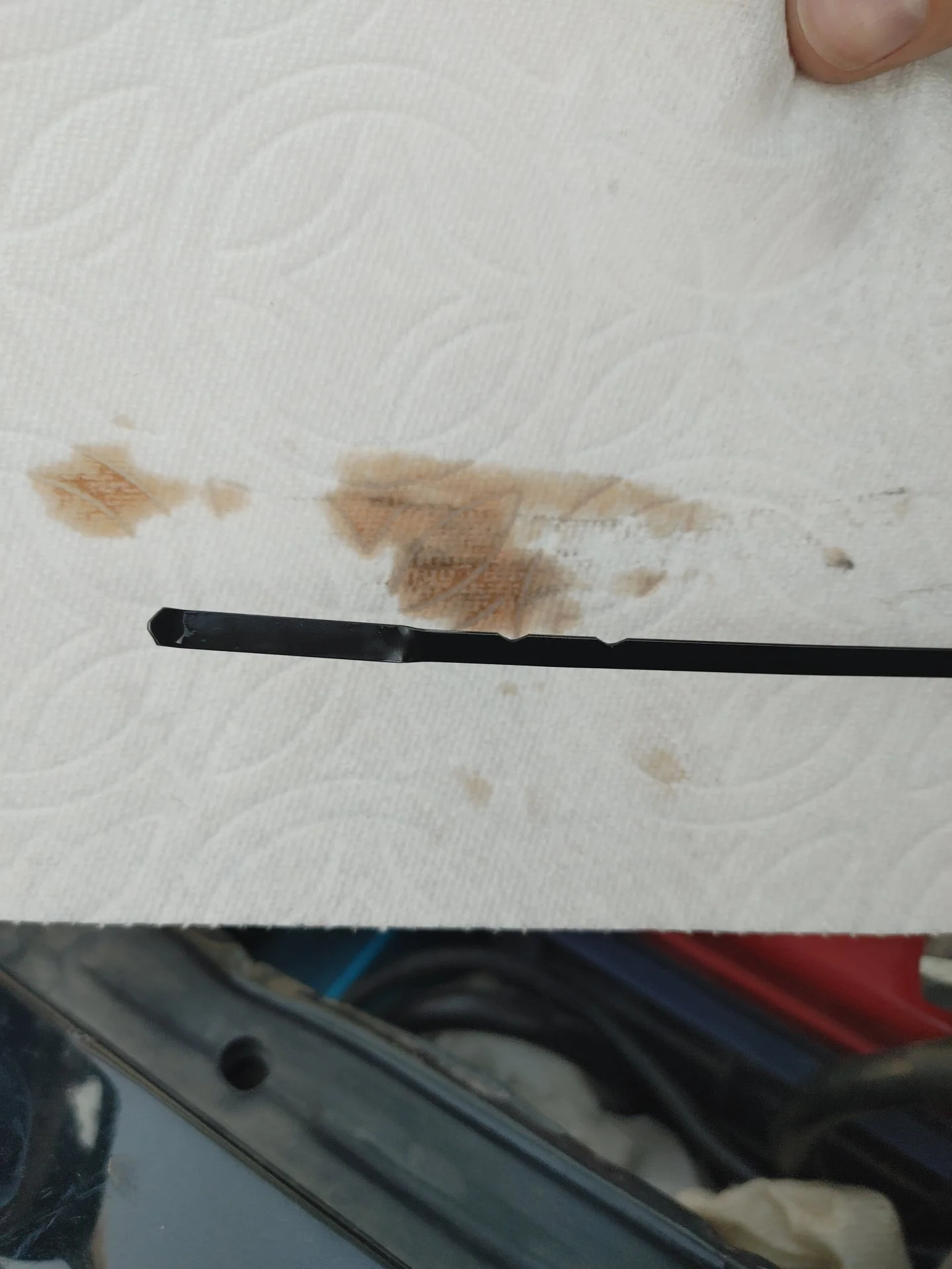

Its getting kinda brown for sure.

Should I do just a drain an fill on the transmission or a complete flush?
I already have a new trans filter kit.
I have a new aluminum radiator as well with the built in trans cooler.
Do a flush using the trans cooler line.

When you checked the fluid level, did you do it with the engine/trans fluid hot or cold?
I may be preaching to the choir here, but I'll do it anyways: trans fluid is checked hot, engine running, on a flat/level surface, slowly shift the trans from P through all the gears, and back to either N or P, then check the fluid level on the dipstick.
Once you're sure the trans fluid level is correct, you can think about what your next step should be.
I do know to do this, but last night I did not because about 2 weeks ago I did the fluid level check and it has enough fluid. Its just getting dark.
