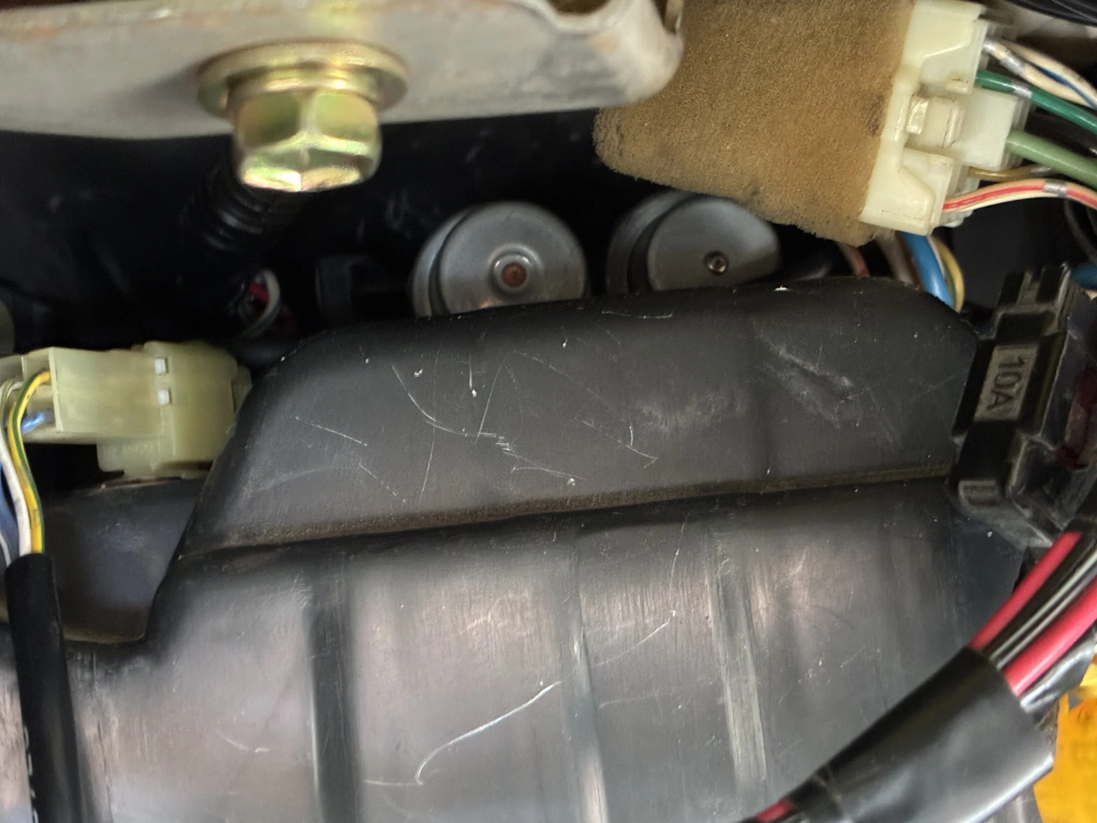

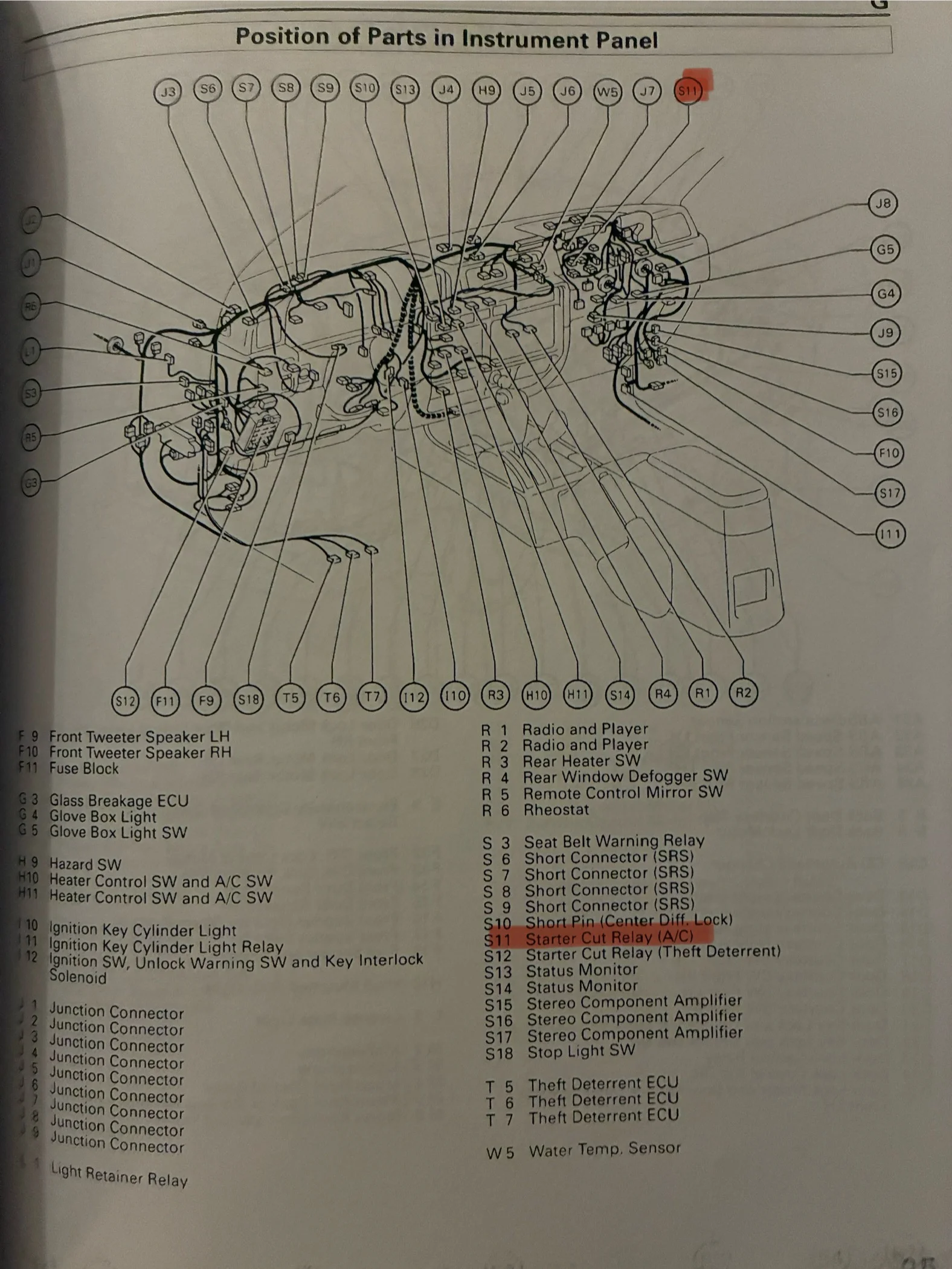

The car can start in D and therefore we think the issue is with the starter cut relay that we should bypass. We are 95% sure this is the issue however, have not been able to access it easily to confirm. anyone been through that? anything else we have not considered? Is there a way to access this relay without removing the entire dashboard, it looks it s above the evaporator, hard to access.
Somepicture of the diagrams and location of the S11 (start cut relay).

Thank you @NeverFinis. So I was able to get the 12v from the park/neutral, however, we also aren't able to get S11 starter cut relay to click despite testing with adding/removing 12v from the A2 A/C dual pressure. also noticed the C16 compressor relay gets really hot during the testing which could be a sign that relay does not work or surge..
Any suggestions to access these 2 relays (above the evaporator) without removing the dashboard entirely so we can test them out?

I think those relays are really tough to remove, without pulling the dash or the evaporator itself.
I would backprobe the A/C Amplifier first and its connections before doing that. It is on the evaporator side, and can be removed.
I am a bit confused about the A/C Dual Pressure switch. If the pressure is within range, it should allow 12V through. You shouldn't need to add/remove 12V there. Why?
Doesn't the C16 relay getting hot point to the fact that current is flowing through it, which means the Starter Cut relay (S11) is also working?
Check for +12V at pin 3 on the A/C Amplifier. This means the A/C Dual Pressure Switch is working, passing Voltage through to the Start Cut Relay.
Check for GND at pin 7 on the A/C Amplifier. This means the A.C Amplifier has the right signals to turn on the A/C Compressor.
